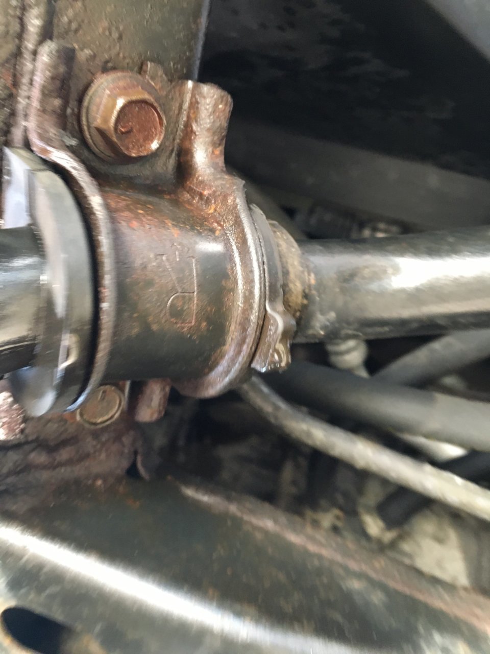

    I went to loosen the sway bay and I believe the bolts broke or the nut on the frame snapped. Bolts keep spinning either way.

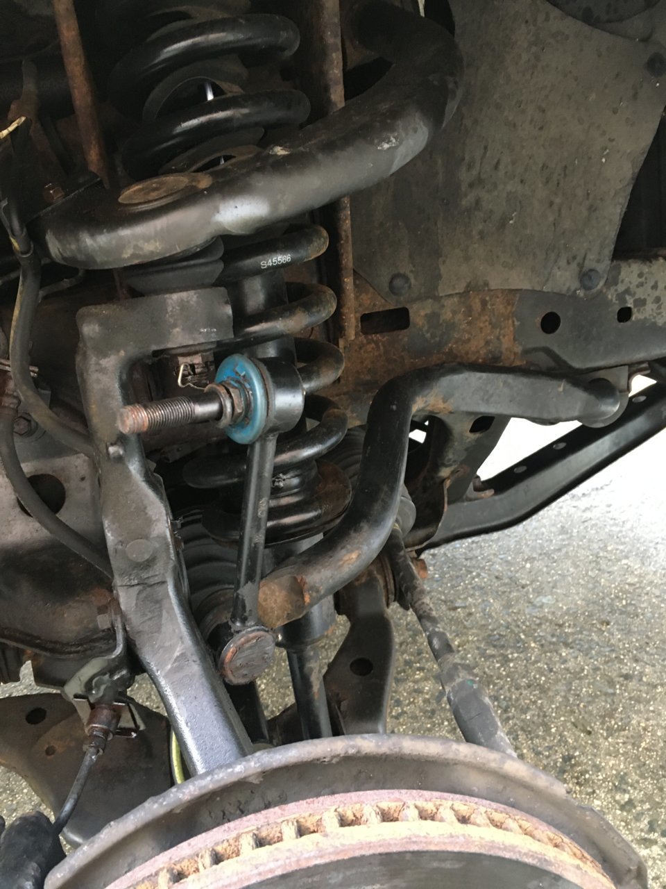

    don’t think it’s necessary to loosen the front but figured it was easier. Also when I loosened the sway link it swang way up and it’s kind of stuck there. Videos I’ve seen on YouTube the sway bar usually swings pretty freely.

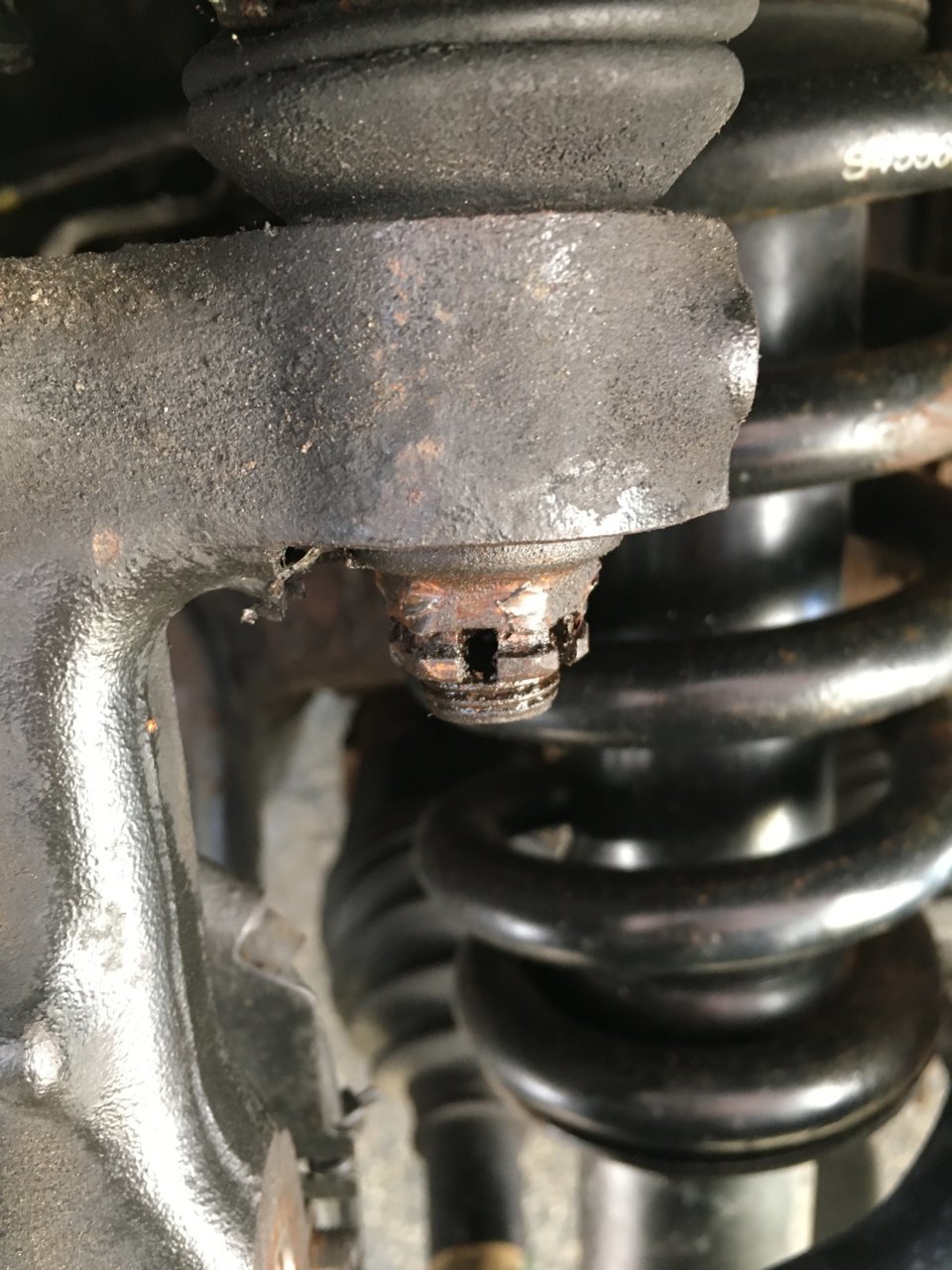

    to top it all off my castle nut won’t budge and it I believe I stripped it.

    sway bay link went fine after jacking the arm up

    You might be able to get a good grip on that rounded castle nut with a nut extractor socket

    Did you hit up those nuts with a penetrating oil? Castle nut is shot, maybe a big pair of vise grips after you soak it, or cut the nut with a tiny Tim saw.

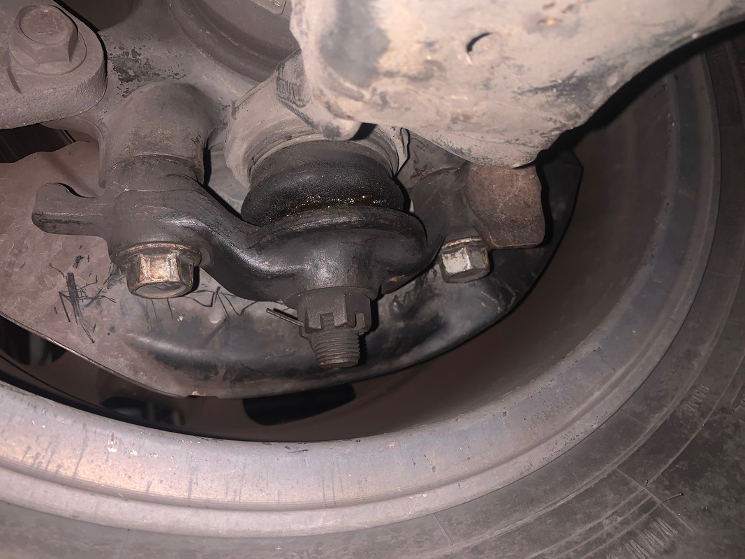

    So I've changed out the fronts now three times and have never touched that castle nut on the UCAs. Is this supposed to make it easier?
    I just undo the two bolts below the lower balljoint and jam the shock up in there. I typically have to put a little bit of ass behind moving the lower control arm down out of the way, but it is nothing super stressful.

    For future reference, I only use a 6 point socket on any nut that’s torqued over 20 ft lbs. looking at your castle nut I would guess you used a 12 point socket. Or did you use a wrong size? Either way try heating it and use an extractor.

    I did use penetrating oil and a 6 pt with a breaker bar

    anybody have a pic of that to be sure? I think trying to put the old one back is not the path forward anymore but try to get the new one in

    Those two outside bolts.

    really only those two? I was following several YouTube vids and they all take off the sway and upper control.
    Anything else I’m missing besides the bolts that holds the strut?

    Taking the swaybar off and getting it out of the way is certainly helpful. Same with skid plates.

    No issues getting the link off but the bar doesn’t budge, plus as I posted earlier it seems like the front bolt and or nuts broke so they just spin

    Disconnect sway bar and the two bolts from the lower ball joint adapter. If you have trouble getting it back together you can use your oe bottle jack inside the wheel well to the uca to push the uca down

    262
    No problem getting the link off as pictures but remove the two fronts
    bolts keep spinning

    If the sway bar bolts are freely turning but not back out....the backing nuts that are welded on the inside have broken loose.

    Yep I’m pretty sure that’s what happened, guess I’ll have to figure it out tomorrow am
