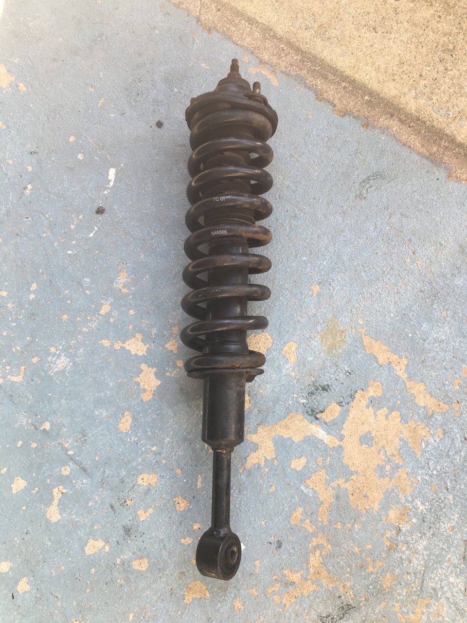

    All done on both sides. Just need to tighten everything up. Really struggled on the passenger side but once I got the hang of it the other side was a breeze.
    just need to tighten everything up tomorrow as I ran out of light.
    thanks for all the tips and encouragement. To the doubters i proved you wrong! Haha jk no hard feelings, I was close to giving up at one pt, but I pushed forward.
    On to the cv axles lol

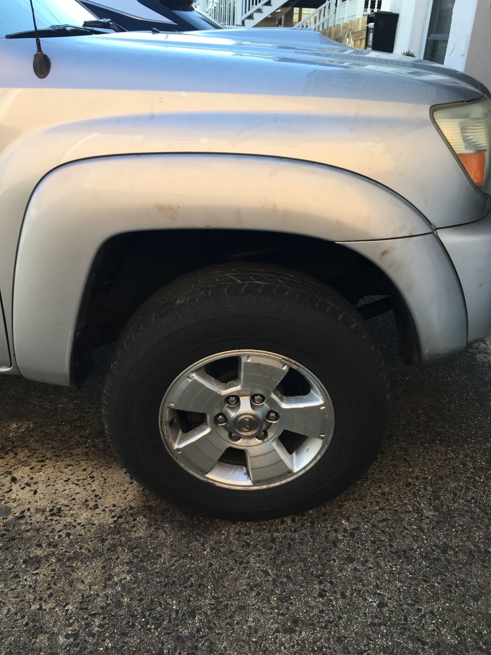

    And the front sag is gone
    excuse the dirty hand prints lol

    Don't forget to tighten your LCA, uca and lower shock bolt at ride height! Those bushings like to bind if tighten when jacked up.

    if your LCA was giving you that much trouble pushing it down/up, then your cam bolts might be frozen. Id recommend cutting them out, and replacing the whole LCA and new OEM cam bolts and use lots of anti-seize!
