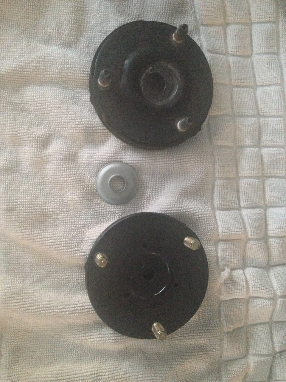

    unfortunatly you wont know if you need the strut top mount until you ger her apart... If this is the first time that front shocks have been replaced then all of the factory hardware should be there. There is a special "locating" washer that centers the strut in the top mount on factory assemblys. I bought all of the factory stuff and ordred 2 strut top mounts from Lowrange and used them... they look to be a superior assembly. The lowrange units have a strut centering bushing molded into the top mount as oppsoed to the factory setup... I will try to take some pics and upload today to show the difference.

    Thanks for offering to take some pictures. The top of the struts confused me with the strut mount, then the isolator which seems included with some strut mounts.

    on the top is the stock upper mount with the center hole wallowed out due to missing centering washer, then a new factory centering washer and finally the aftermarket upper mount.
