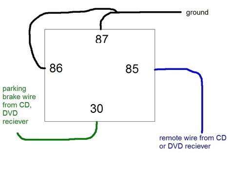

    If you're looking to do a bypass all you need is a four pin relay look up the video on YouTube. Really simple fast and cheap. Works awesome on my avh 5700

    This is how I've got mine set up just tapped a ground behind the dash and stuffed the relay in the back out of the way. Had it in for a while now and no problems yet.
