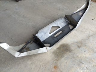

    CBI was the only one i could find that offered a DIY kit. it was $424 for the bumper and an extra 30 for the stinger. It was a super nice kit and everything fit really well together.

    Can you post more pictures buddy? how thick is the metal?

    http://www.cbioffroadfab.com/produc...oma-products/diy-1st-gen-tacoma-front-bumper/

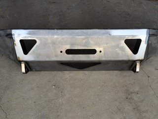

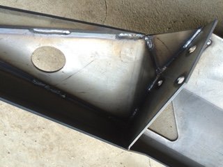

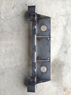

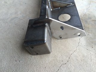

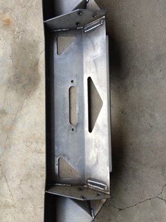

    ^Here's the link to the kit i ordered. The mounting plates that bolt to the frame are 1/4" steel and the rest is made from 3/16" steel and has two 3/4" steel D-Ring tabs.
    http://www.cbioffroadfab.com/produc...coma-front-bumper-moab-1-0-with-center-grill/
    ^That's the link to the assembled bumper and you can find the specs on it there.

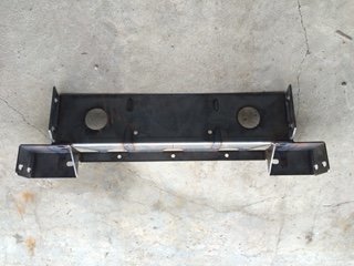

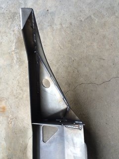

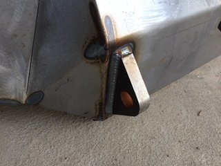

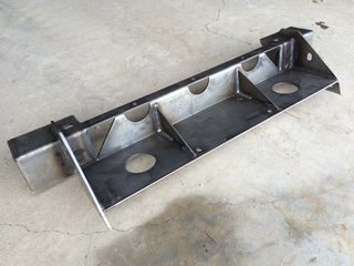

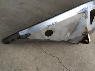

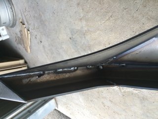

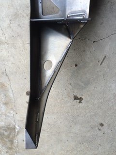

    ***These are pics sent to me from CBI as reference for assembling the DIY kit.
    This is the bottom of the winch plate/frame mount. Passenger side is at the top of the pic.
    Bottom view... Passenger side is on the right side of the pic
    Holes on the left bolt to the frame, holes on right side are mounting holes for the rest of the bumper.
    Top view of winch plate/ frame mount. Passenger is on right side of pic.
    Back side of driver side. That hole in the corner is for a 2" signal marker, i found them at O'Reilly's for around 6 bucks.
    Back side of the center of the bumper. The holes you see are for mounting to the winch plate.
    Back side of passenger side
    Back side of the whole bumper
    Center front, winch access points
    Passenger side front
    Super beefy D-Ring mounts.
    lukester78 and taco71742[QUOTED] like this.

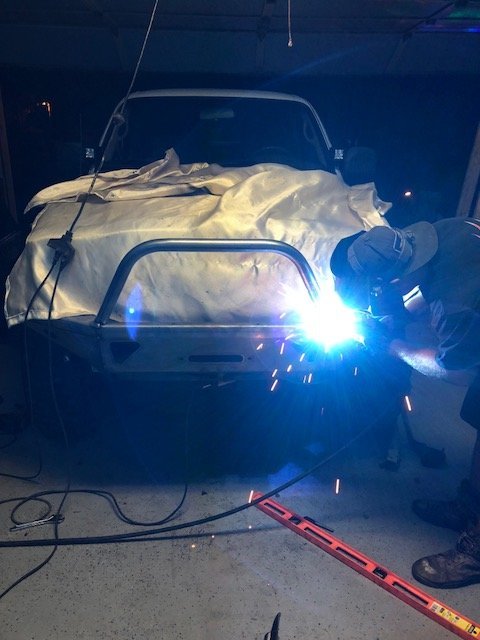

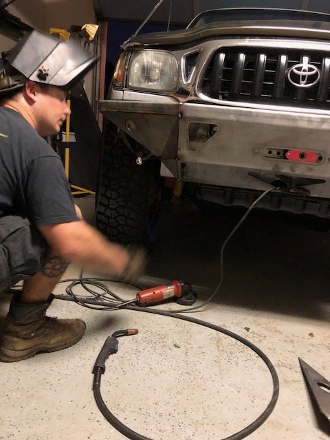

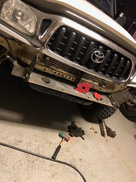

    And of course some in progress shots. BTW... Nate, the guy doing the welding, has a 6.0 swapped jeep on 40's. Linked front and rear and just recently threw in an Atlas T-case. Nbd.
    Andyjobe1 and taco71742 like this.

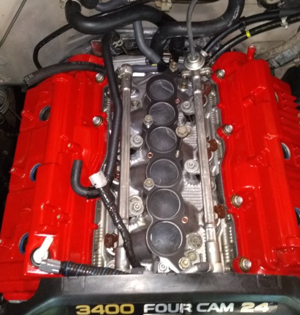

    Well there is a third piece yah gotta remove for the knock sensors but you'll see. And thanks on the turbo :D
    here's the three pieces
    [​IMG] lower
    [​IMG] middle
    [​IMG] upper
    sorry for the low res pics, but I don't currently have mine disassembled lol. You have to separate the upper from the middle manifold so you can access the bolts for the lower manifold.
    EDIT: The upper portion is a plenum with runners, the middle section is just runners and the lowest portion is technically the manifold. Despite that most repair manuals I have seen refer to the 5VZ-FE "Intake" as a three piece manifold design. But regardless of how it is worded its a 3 piece unit.

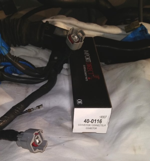

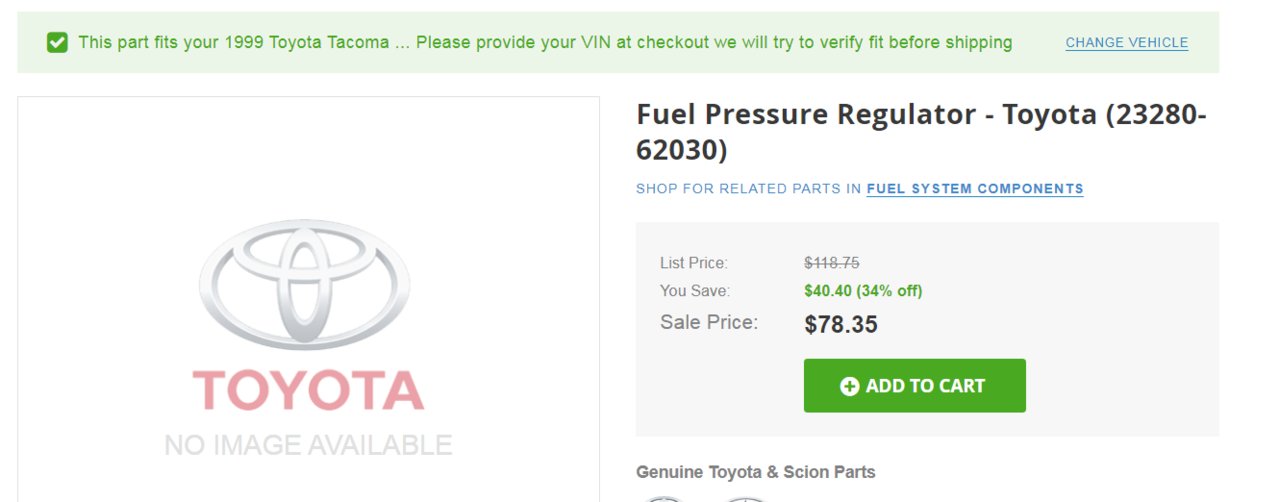

    I make it a practice to replace the fuel pressure regulator (FPR) when replacing injectors on an old (18yo +) engine. I had to replace the injector plug sockets because a few of them crumbled from age. I bought replacement pigtails from O'Reilly. I only needed to replace the sockets. I also replaced the injector rail crush washers.
    jammer and boostedka like this.

    Thanks for input. If the FPR isn't too expensive I'll throw one in. I'll also be getting the crush washers which I forgot to order.

    Thank you. The going price for a new OEM regulator is $78.35 + shipping.

    Have you had the FPR go bad on your older vehicles? How common is it? I just couldn't justify 80 bucks for a part that seems to be working perfectly.

    Yes. I see them start to fail after 20 years. @xtremewlr recently had a failure on his 1st gen. Its just another rubber component like hoses and belts. They don't last forever. If you can replace one in 15 minutes, then why bother replacing it? To me its about time and the likely hood of reworking a job later to replace an old component.

    They contain a vacuum operated diaphragm that will leak as they get old. Stumbling is the symptom.
    Just search on FPR and count the number of hits. Here's another replacement post below.
    Preventative maintenance depends on how long you're planning to keep the truck.
