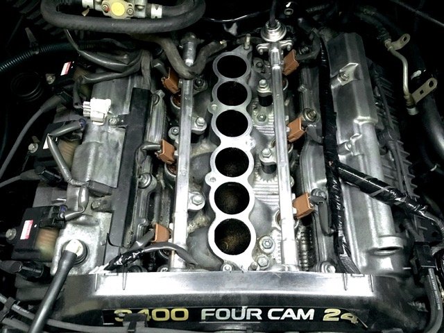

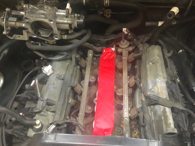

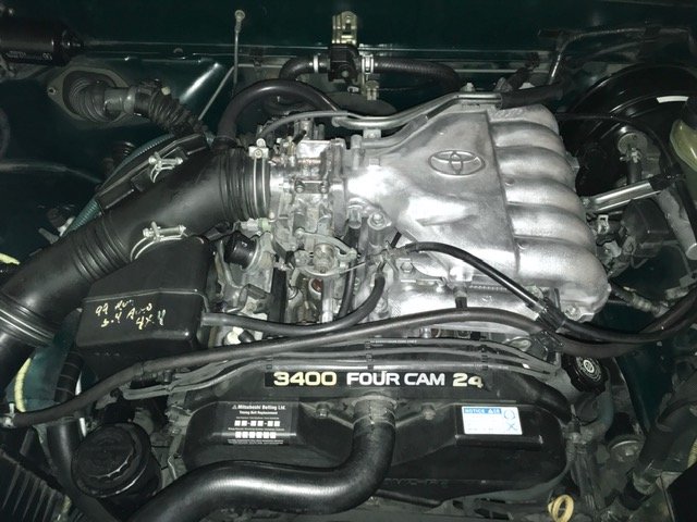

    Update:
    Broke her down.

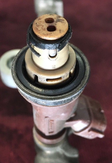

    As you can see, she's pretty dirty. Did an Ohm reading on the injectors. They were all within .2 of 13.8, so the resistance was good on all of them. I'm sweating bullets at this point.
    Pulled the rails and injectors out and finally found the culprit giving me the P0306 CEL code (intermittent misfires) this whole time. The #6 injector o-ring was hangin on by a thread and hanging very loose. One o-ring to rule them all.

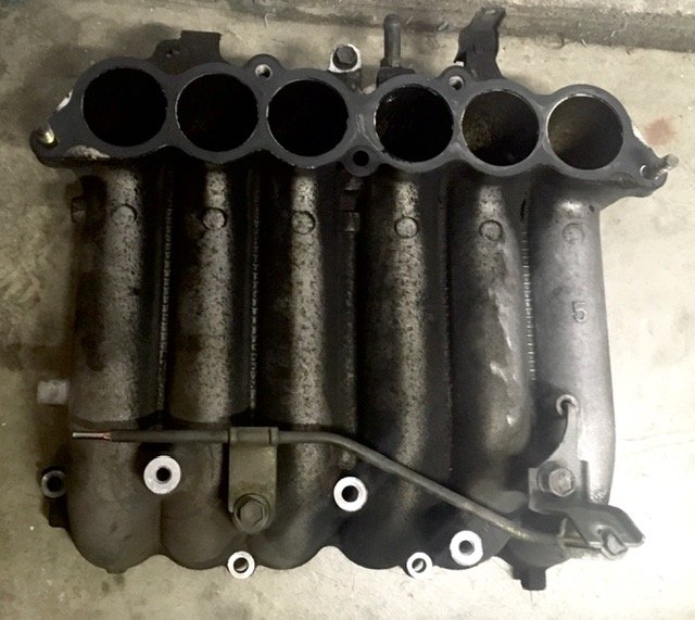

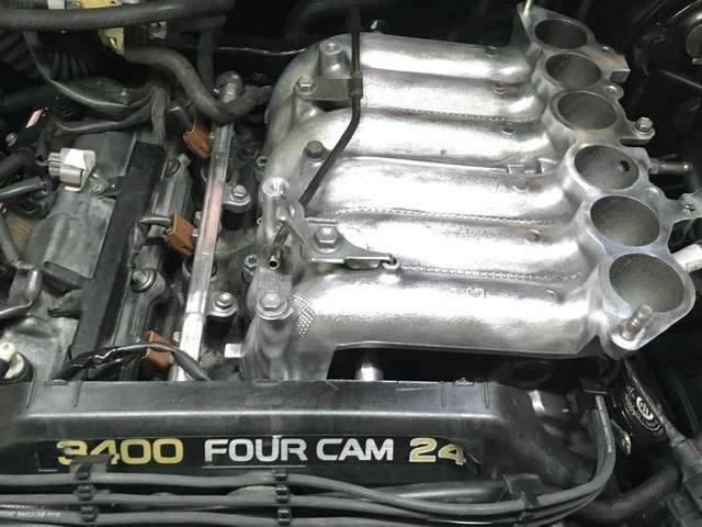

    Replaced all 6 injectors, the fuel rail crush washers, the fuel pressure regulator and cleaned up what I could.
    Replaced the plenum gaskets and cleaned up the plenums.
    Got her all put back together with a new throttle body gasket and replaced the fuel filter.
    Now I was getting misfire codes after starting her up the first few times and was running rough. I let her idle for a long time today then reset the new codes I was getting. Took her for a 6 mile jaunt and she's running well...no codes popped up from that trip. I suspect (hopefully) that it was debris running through the system from the extensive cleaning. Can't be sure, but I'll keep you posted if any problems arise.
    Side note: getting back to the subject of this forum, I'm not sure if hoses were mentioned earlier, but upon close inspection of my hoses, I had to replace 4 or 5 old, cracked hoses....so be prepared for that.
