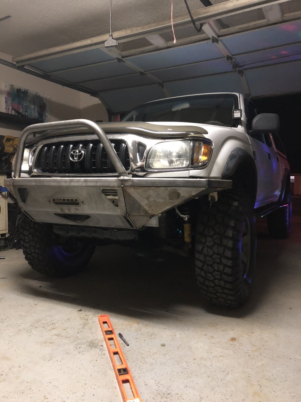

    That bumper is sexy.

    Dang! that's a hell of a deal!

    False. it's a two piece intake PLENUM and a cast manifold :rolleyes:. I'm really not trying to go past the point I need to to change the injectors. Black Friday just happened and the knock sensor job would add another $100-130 to the task. I just can't justify those parts right now when they are still functioning. And if I have to tackle it later, the plenum gaskets are less than 20 bucks. At this point in time, i'll take the hit of the $20 later on down the road. Also, i was drooling over that turbo setup! :drool::drool:
    Thanks man! It's the CBI DIY MOAB 1.0, a friend of mine down the street tacked it up for me last night and is finishing up the rest of it over the next day or two. Only took us two hours to get the stock one off and then get the kit tacked up. I'll post a pic up when it's all done.

    Please do buddy, im in the market for a DIY bumper.
