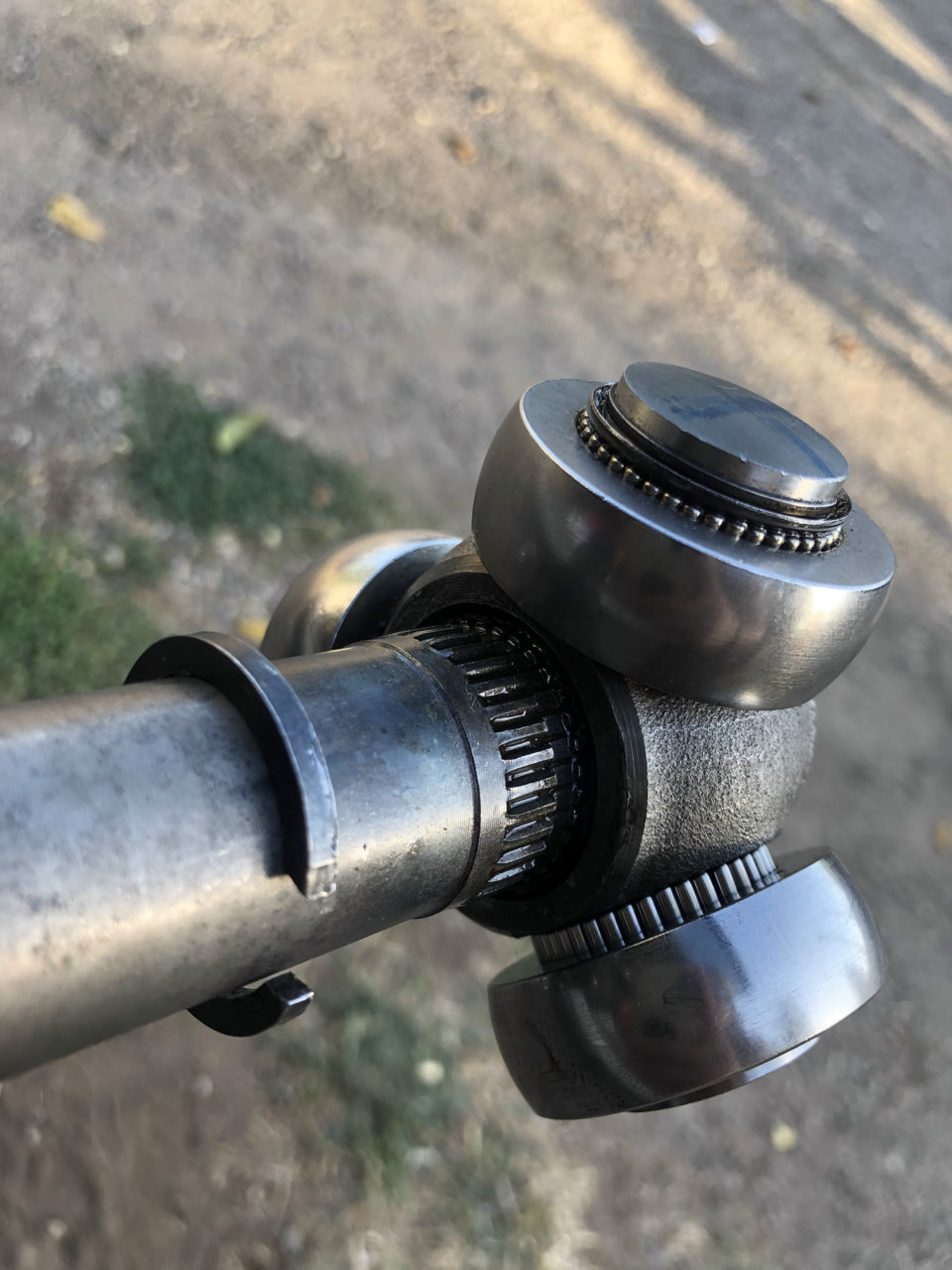

    As title says, i'm replacing my inner cv boots as one is ripped and the other is about to.
    I've gotten one cv shaft out, and the snap ring removed from the tip but the tripod joint will not come off. I've been using lots of PB blaster, tried using a brass punch at the base to get it loose and still nothing.
    Anyone have any tips or tricks to get it off??

    ended up pulling the head off a brass hammer i had and using it to pound the tripod off, and then back on once i put the new boot on.

    Clamp the shaft with whatever you have available and then use a brass drift punch and hammer it off. Pretty sure this is actually the method advocated in the FSM.

    yeah i have access to the service manual and it says brass punch and hammer, but took alot more effort then expected.

    Im encountering the same exact problem. So essentially you just kept beating it with more force and brass punch? The lip of the tripod at the point of contact is starting to make some micro dents so I wasnt sure if I should keep going

    Yup, brass punch, be brave. A standard triangle file fixes any errors later.
