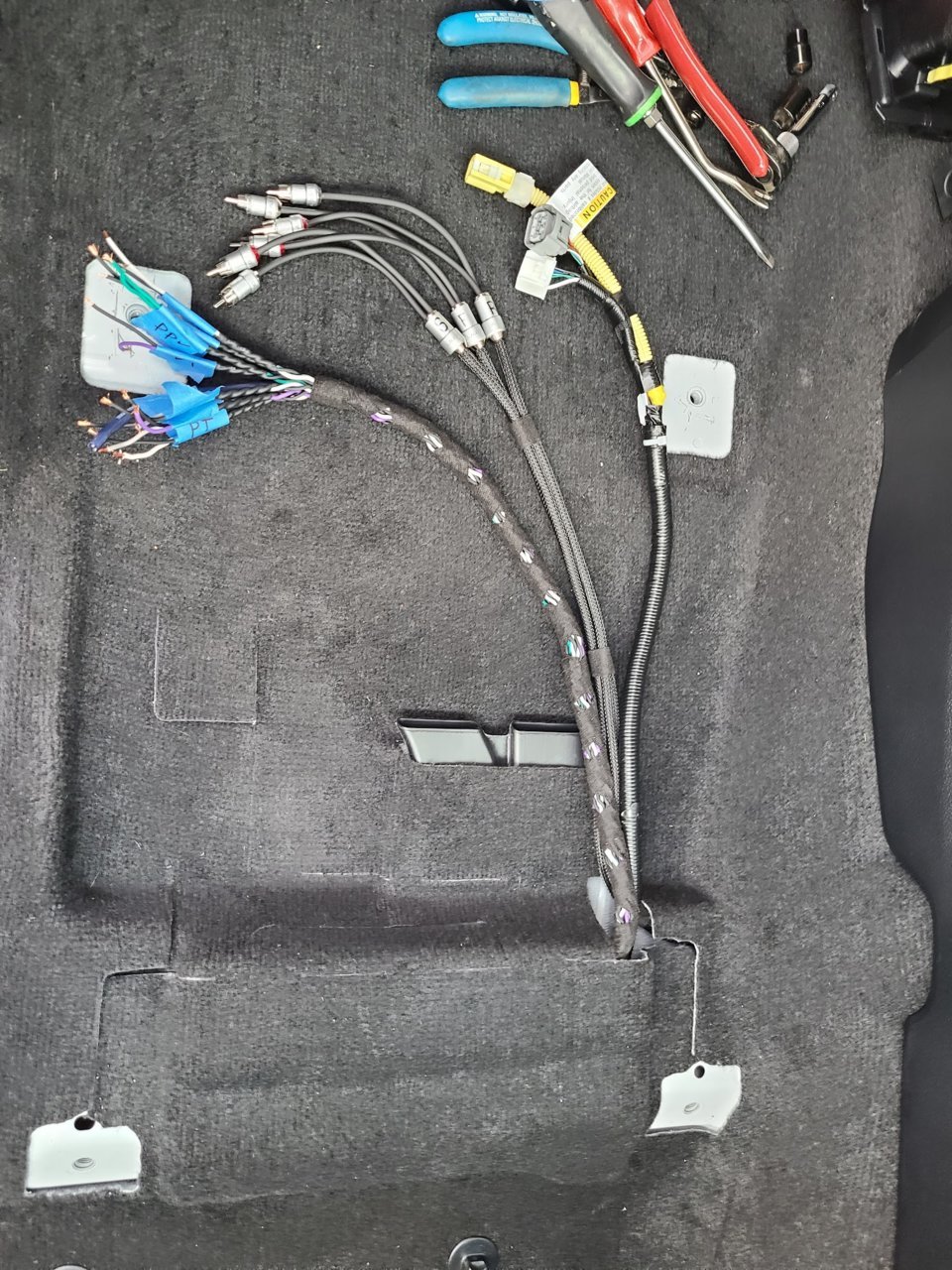

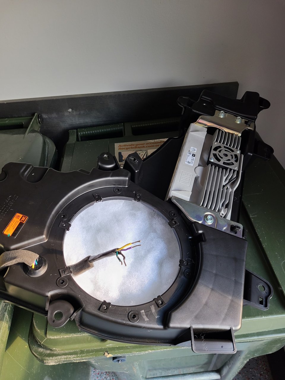

    Had a 2021 4Runner with factory JBL that I integrated into, goal was to replace the factory amp, speakers and sub, but retain the headunit. I was successful but was a good amount of work.

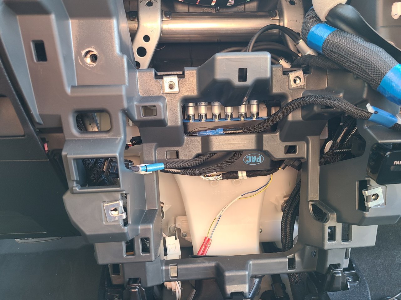

    PAC unit to interface with Headunit, retaining steering wheel controls and catch RCA output:
    fcd4eMAox-XthDPfCcDzgavhfvcqlfKuTkTu-q9X_22abf03e5ca1a0f45df74db235f8c10c0a5c22f4.jpg

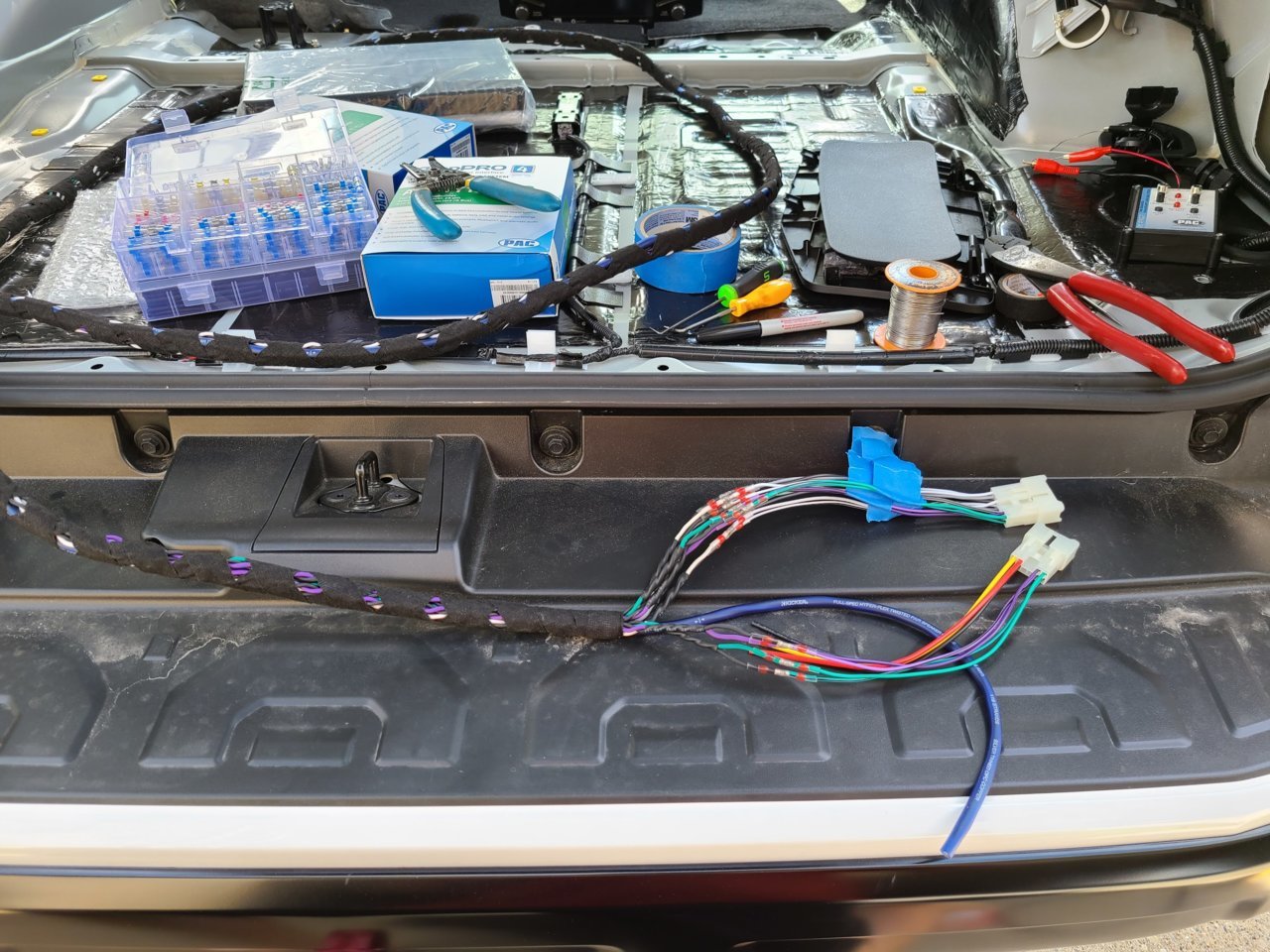

    Handmade speaker harness/extension to run from aftermarket amp and plug into harness at factory amp (Factory amp bypass):

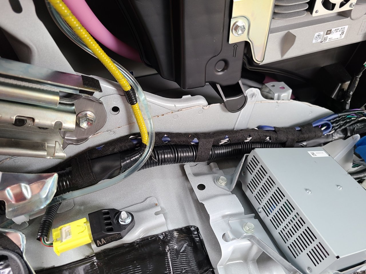

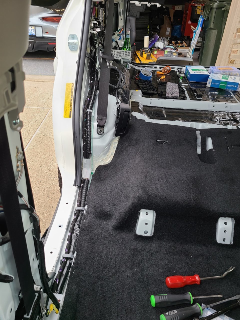

    Running new harness along factory harness (stock look :) ):

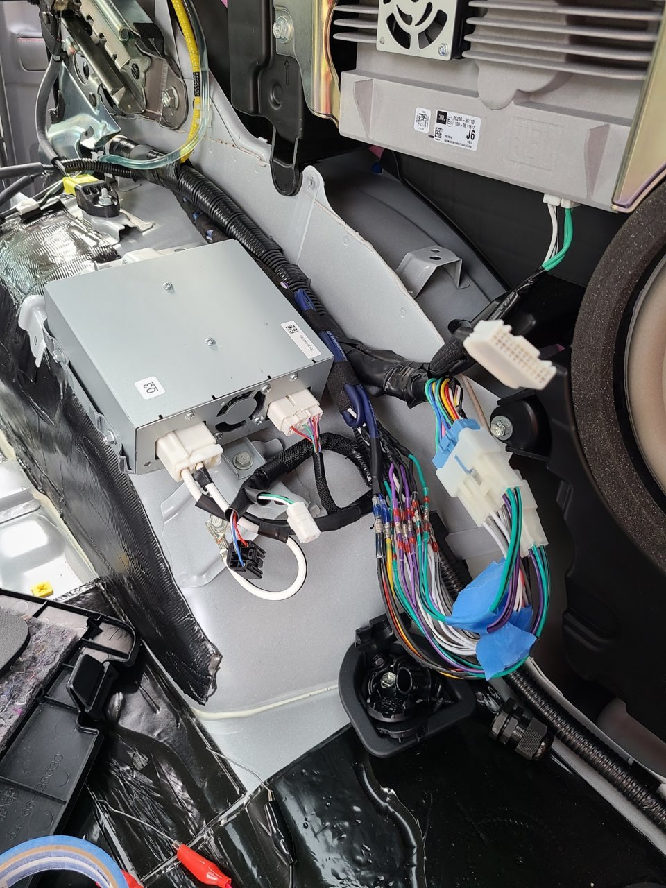

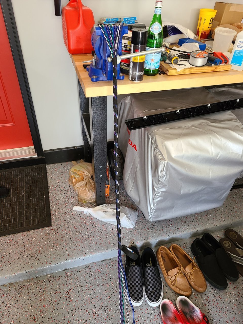

    Creating factory amp integration harnesses:

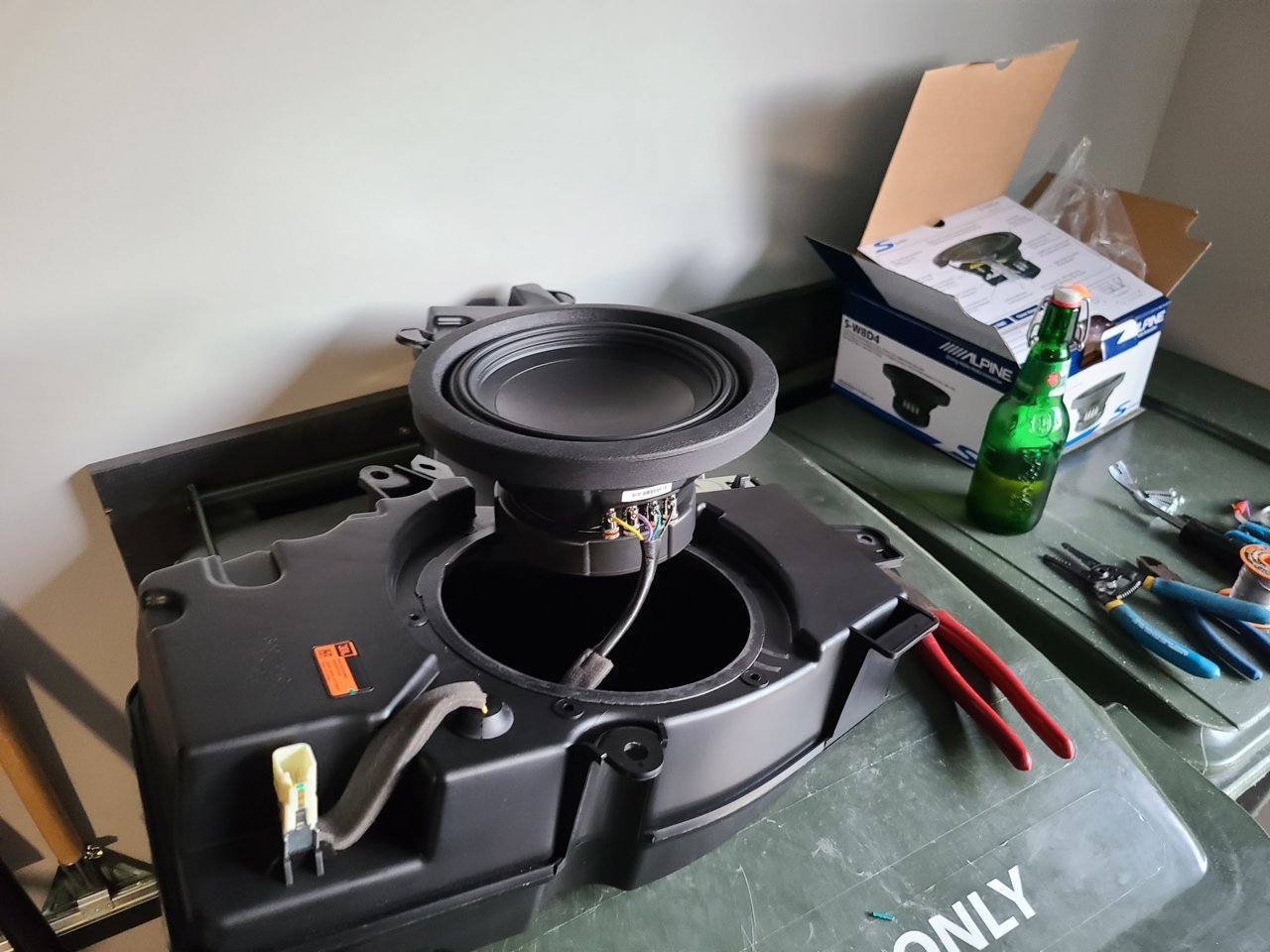

    Retrofit Alpine Type-S sub into factory box (needed a higher wattage sub):

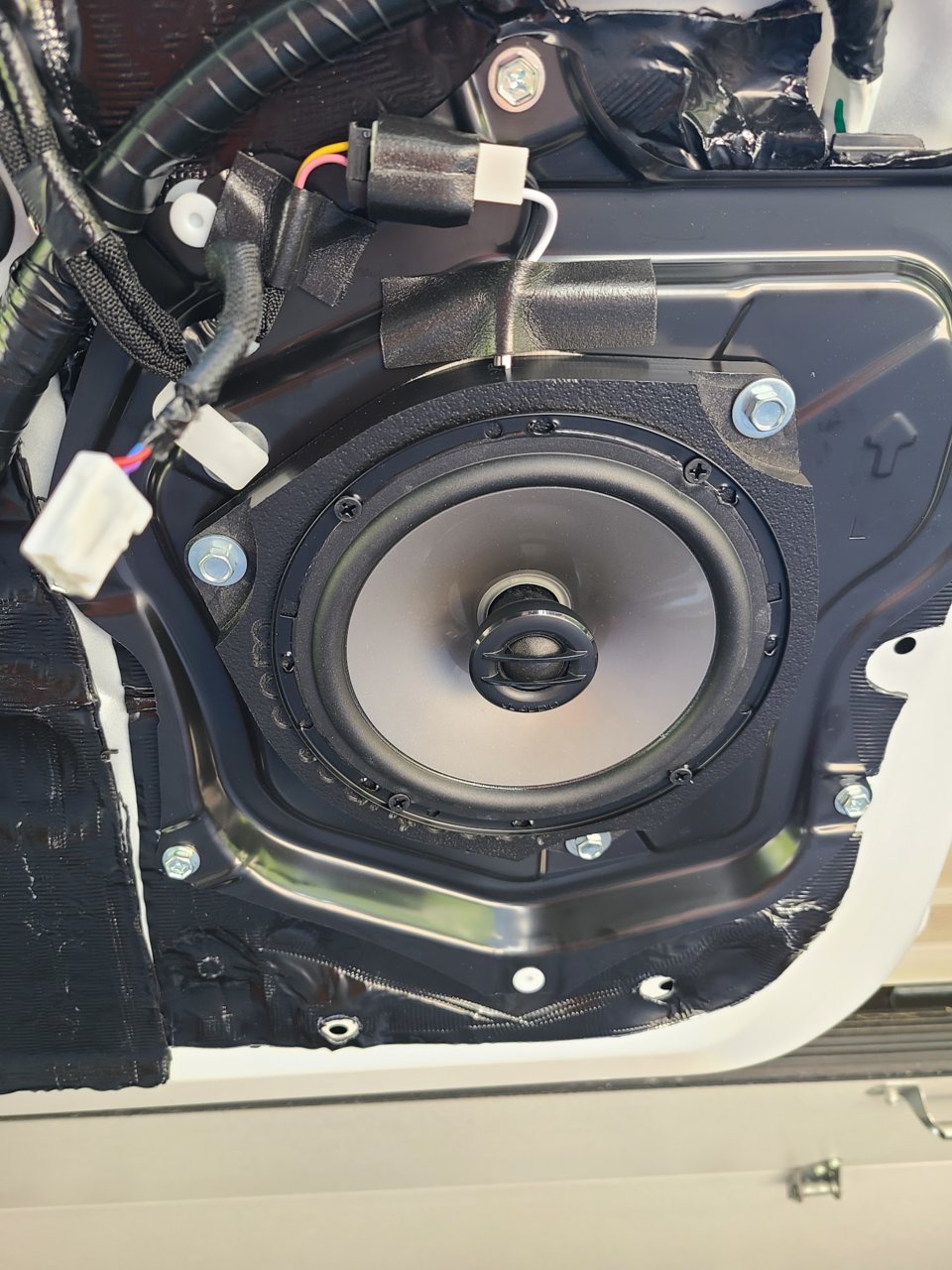

    Door Speakers:

    This time I opted to NOT get the factory JBL and save myself the hassle with my new Tacoma, but I think a lot of the above is the same for JBL powered Taco's, maybe it helps you?
