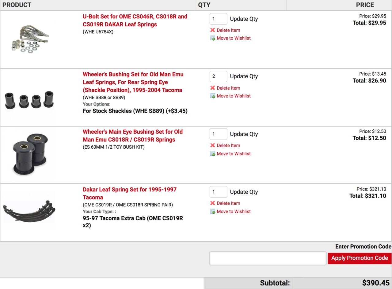

    My original leaf springs are finally starting to sag a little. My coils are also pretty shot, so I'm hoping to replace those as well during this whole process. See below for questions on that.
    I have recently replaced all 4 original shock absorbers with Bilstein 5100s. I have an add a leaf in the rear and a 1" spacer in the front. Overall I have about a 2" lift on the truck. I'm getting the truck ready for a big road trip in the spring, and am planning to have a cargo carrier on top of the truck with two kayaks. Also, going to build out a bed and drawer system for the bed. This should add a good bit of weight, but am hoping to keep it under 150lbs.
    I've been told my best option considering economy/performance would be to go with the OME Dakars to replace the original leaf springs. I'm thinking I'm going to do this job myself. This is the part list I'm planning on buying:
    My main questions are:
    1. Do I need to buy longer brake lines with these leaf springs? Or are the stock lines just fine? Will I need to buy any other parts here other than new bushings and u bolts?
    2. Will they be sufficient with the setup I'm planning on having with the back loaded down with weight? Or will these springs give the truck too much lift in the rear?
    3. I'm planning to replace my front 1"spacers in the front with coils that do the lifting instead. What coils go best with the Dakars to match their lift height and also work well with the 5100s?

    I would recommend buying the rear extended line from wheelers so you have it during install. When I did my 2016, I didn't need it but when I did my 1995.5 I absolutely did. If you want to splurge on new greasable bolts for the bushing locations, you'll make maintaining your investment easier. I personally would recommend running a 2.5 degree axle shim with that leaf pack, as I had vibrations after installing my 8-leaf wheeler pack that were eliminated with the 2.5 degree shim. About 1 degree per inch of lift is a good rule.
    The dakars should work well for the setup you plan on running. With the canopy and bed drawer system you're talking about permanently installed, it should be enough to make these ride enjoyably.
    I'm sure you'll get some different recommendations, but OME makes a coil that works on the 5100. I'm not positive what size you'll need for your setup.
    Wheelers is great. Super fast shipping where I live too!

    Thanks! From what I've read the 882s seem to be the most commonly used coil to match the lift of the dakars. I think I may get 881s tho and take a leaf out of the leaf pack from the dakars. I don't necessarily want or need 2.5" of lift.
    What are the greaseable bolts for? They are essentially just so that the old bolts that hold the leaf to the shackle don't rust or seize onto the new leafs? I want to get a good setup that lasts a long time, but I'm just trying to wade through which pieces are necessary and which are not.

    Resurfacing this post because I have my final list that I am purchasing. Was wondering if anyone wanted to chime in and let me know if I need anything else:
    - 2 OME cs020r leaf springs. These are the cs019r with the extra leafs already added. I thought this was the best choice for my constant heavy load that I'm going to have in the bed.
    - All Bushings
    - Brake Proportioning Valve kit
    - Exhaust tail pipe relocation kit
    - U bolts
    - 3 degree shims with center pins
    - Extended brake line
    Any thoughts anyone?
