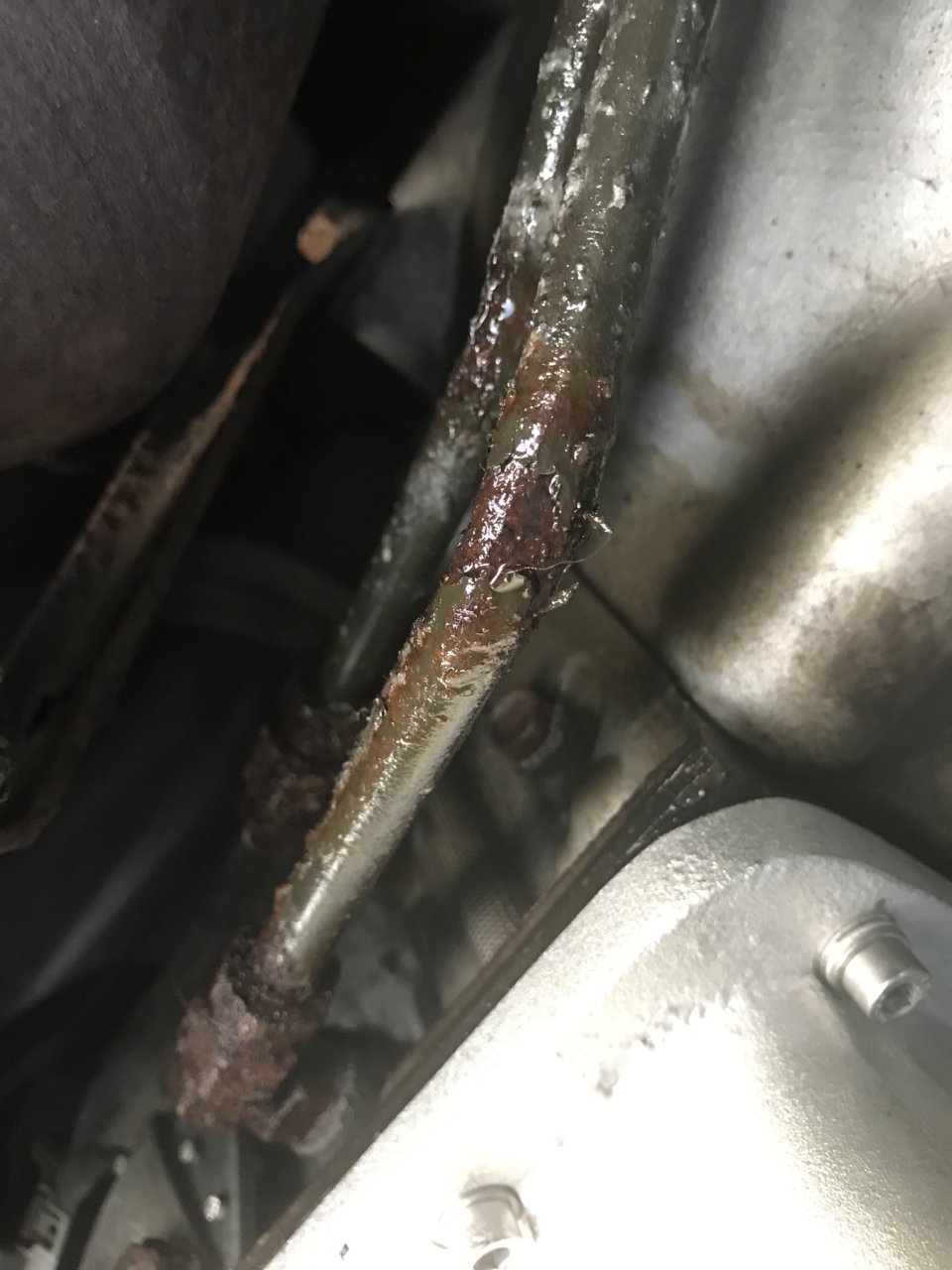

    They don’t look any worse than mine were. 19mm on trans side and a17mm line (not open end) wrench and go gorilla on it. If that doesn’t work and you’re not in a rush get the two #32921 trans fittings and replace from there. Your lower line looks like it’s ready to break off right at the fitting anyway. Snap it off and go for it all.

    Yeah they are jacked in multiple spots...I am replacing them from the trans to the cooler with rubber to prevent any future issues. That’s if I can get them off ha ha
