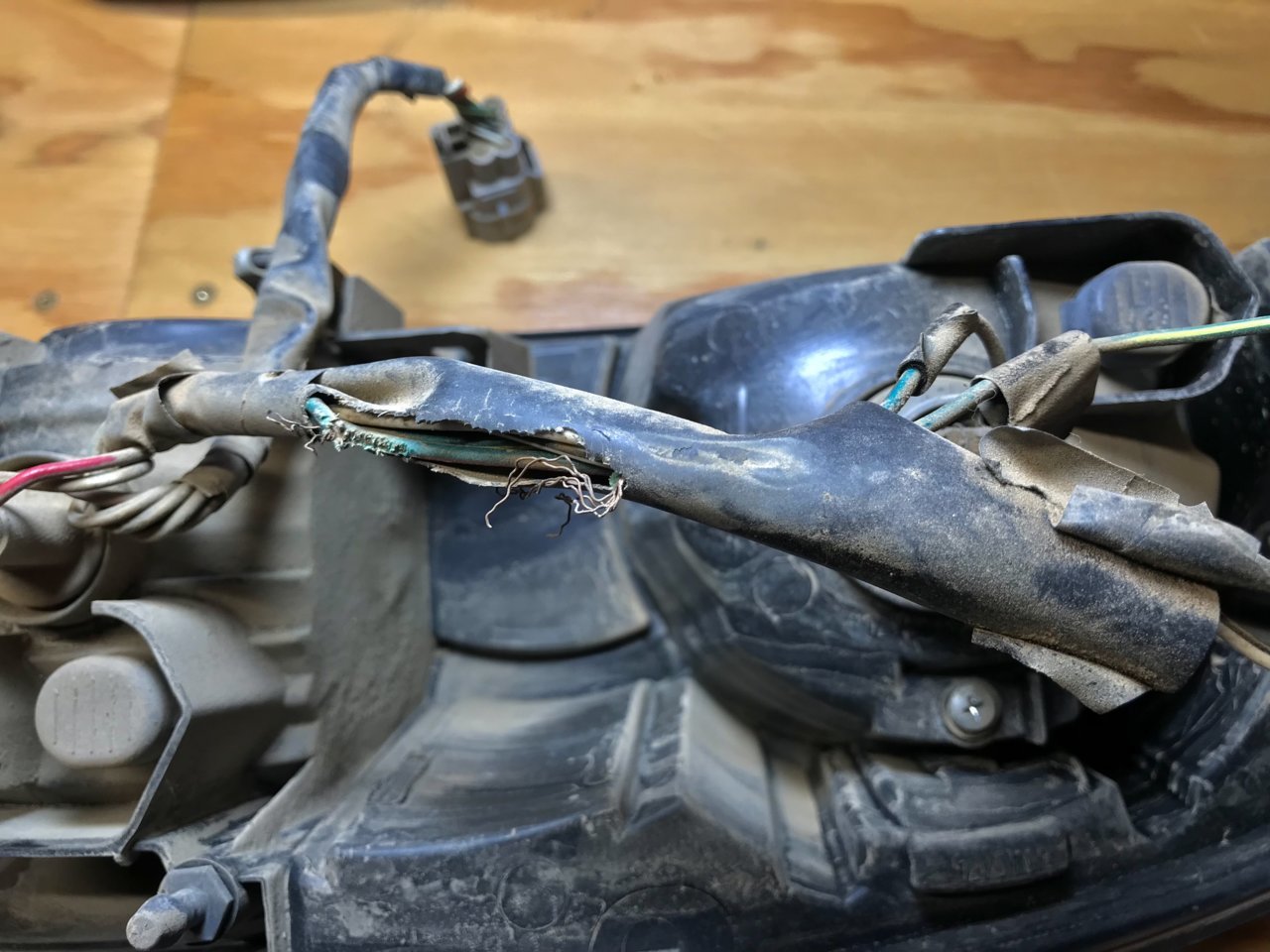

    Hello, I have a 2013 with the left rear running light "out". LED.
    After some research, it seems the entire assembly (housing and lamps) must be replaced as a unit. (I found an online tutorial on performing this service).

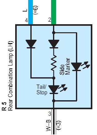

    First see if your brake light works.
    If it does, check the tail (running light) wire at the connector. (It is the GREEN wire.)
    If it has power, you probably have a bad tail light assembly.
    The reason I have you check the brake light is, because the brake light uses the same ground wire as the tail light.
    If the brake light didn’t work, then it could be a ground issue.

    The reason for the center light not working: a rat had chewed through the wiring. A first for me.
