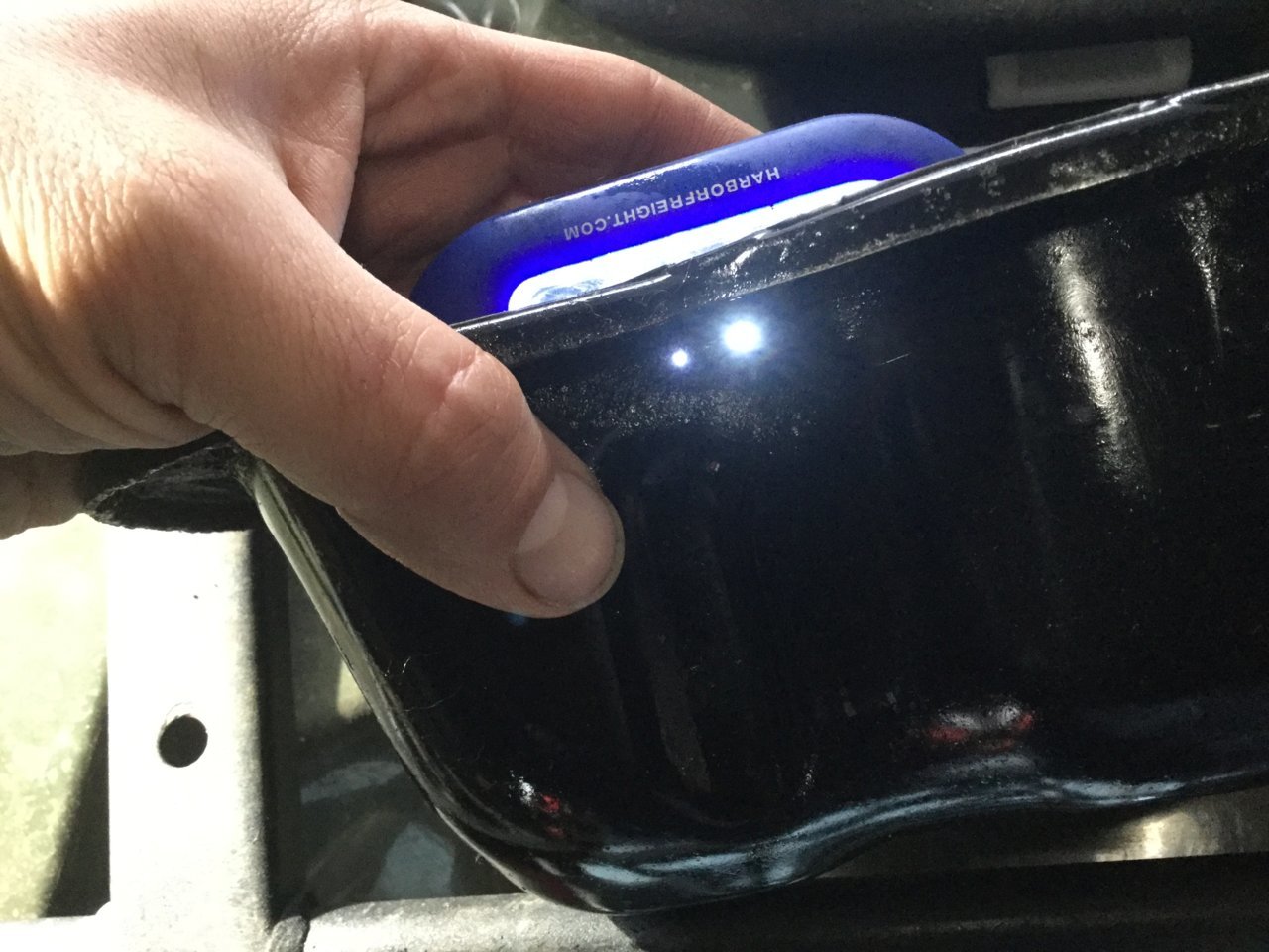

    This thread helped me immensely. To reiterate there is enough clearance to replace the lower oil pan without removing the front differential. (2005 TRD Sport 4x4) My pan developed a few pinholes and needed replacement.

    How does a oil pan develop pin holes? Just curious.

    Too few to list.
    I'm guessing due to rust.

    My state and town loves salt and salt brine spray. I guess it was a matter of time. I started doing a fluid film application after I got my new frame a few years back.
