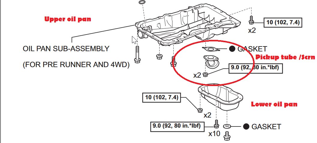

    Can you asses the condition of the pickup tube and screen by dropping just the lower pan?
  12. Apr 22, 2020 at 2:52 PM
    #52
    Jimmyh
    Jimmyh Well-Known Member
    May 16, 2012
    #78991
    14,276
    SC
    2012 Prerunner SR5
    Yes.

    Hello... I know this is an old thread but my time has come to replace the lower oil pan and I want to make sure of a few things before I start..
    Is there a specific tool I need to remove the pan once the bolts are removed?
    Is this the best product to use for sealer? https://www.amazon.com/Genuine-Toyota-00295-00103-Formed-Place/dp/B000EDDTV0
    Does the oil pan even need to be replaced? It does not look like there is anything wrong with it. Maybe clean off both sides and call it a day or buy new?
    Is 80ft#' correct for the bolts when I tighten them back up? (google is good---
    what is 80 INCH-lbs= 6.667 ftlbs)

    Small bolts need low torque. 80 INCH-POUNDS, basically wrist tight with hand grasping the ratchet head. No need to gorilla arm these.
    Use a crossing pattern to tighten the bolts as a good practice. Snug up all bolts, then go around a 2nd time to final tighten.
