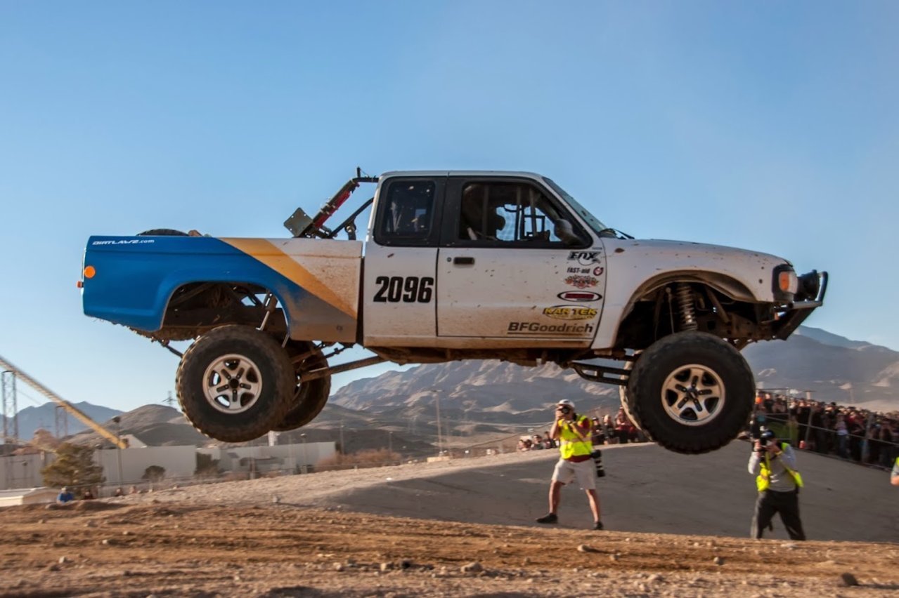

    OcKfRCKNqcJtdYU9sPa78_pPMpHEfZvUamR5Yk-8_fe46642b164a17fd7fd7b12d1eae72fc45fe2a8c.jpg
    Yes, I guess you could say I know a little bit about shock tuning a "race vehicle"....
