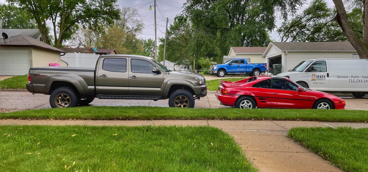

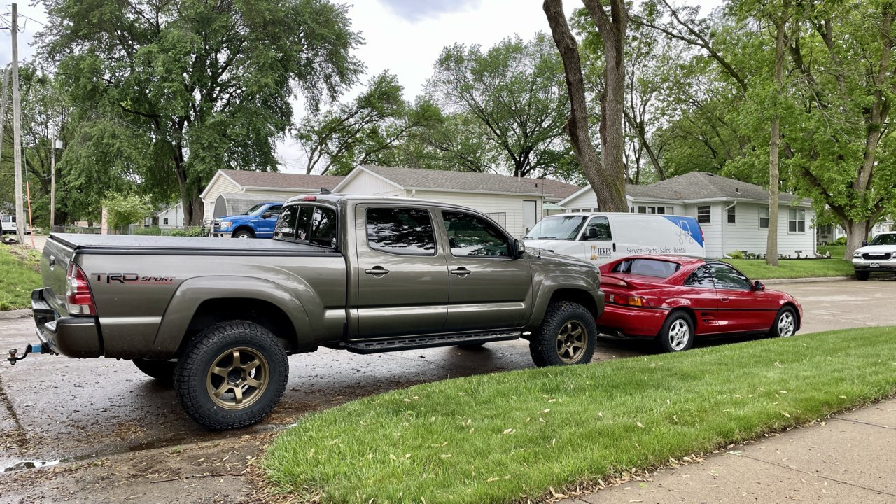

    Here's the setup on my 2015 DCLB (Double Cab Long Bed if you don't know the lingo yet).
    -6112 front clip 5 drivers side/clip 4 passenger to address the drivers side lean.
    -B110 5100 rear - B110's are an extended length 5100 (16.34" collapsed/27.28" extended) which requires taller bump stops and extended brake lines due to how much more down travel they have. The "standard" rear 5100's (14.02" collapsed/22.94" extended) are fine but they limit down travel and if the rear is lifted your resting height is that much closer to the extended length of the shock. Both are valved the same so ride wouldn't change between the two.
    -Old Man Emu Med leaf pack
    -GM bump stops (PN 15712438). I chose these since they are taller and are progressive rate bump stops, like the high dollar ones. Sure you can get Timbrens or Super-Bumps and they are great and probably better, but for me I wasn't willing to spend $200 on bump stops. The GM ones are about $40 for 2.

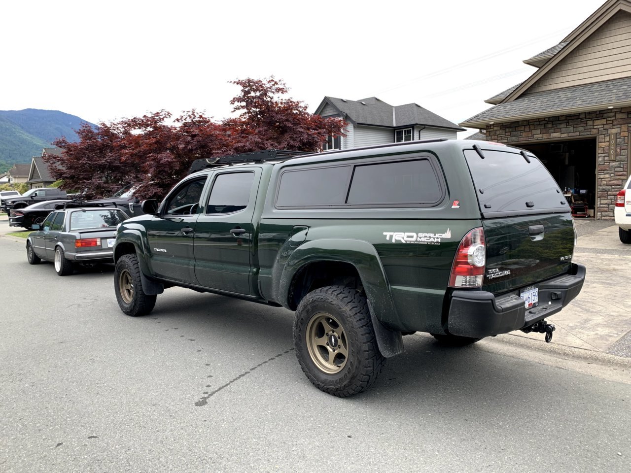

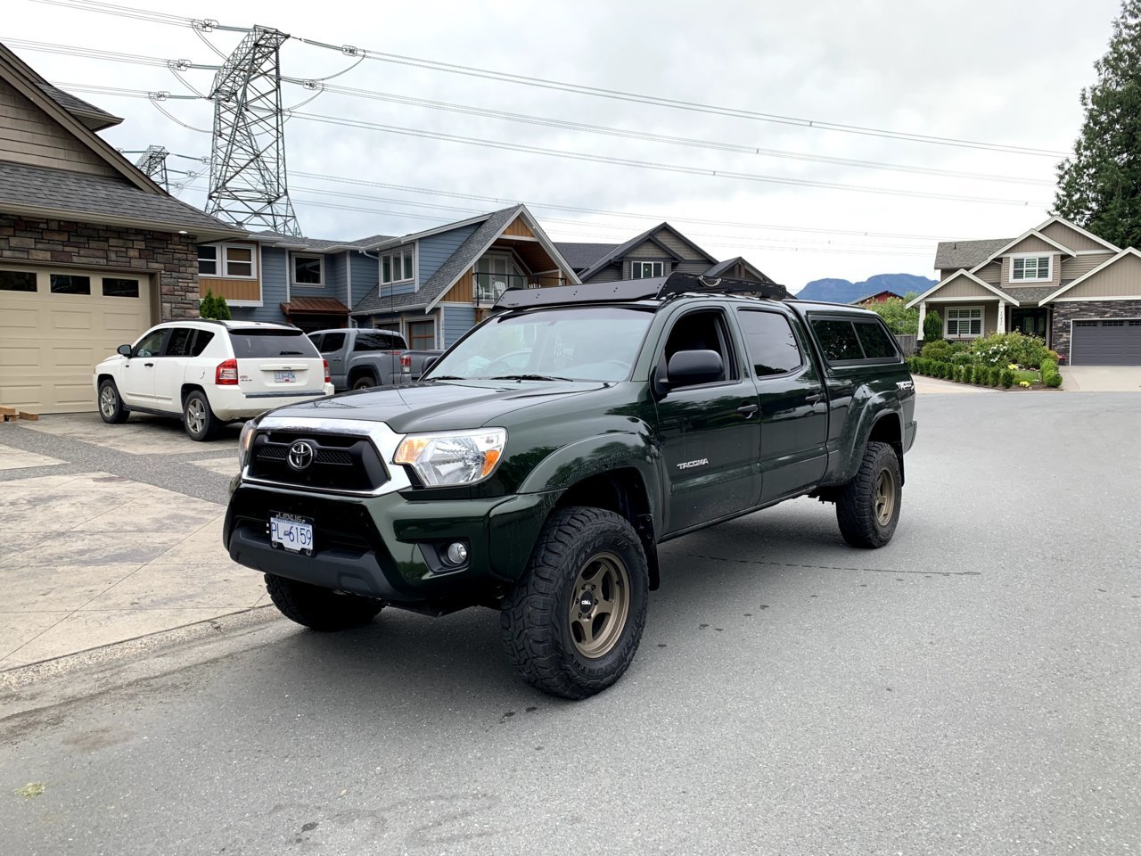

    You seem to be getting some hate here, but I have this exact setup you're talking about and love it...although I do wish it was slightly taller ;)
    The 4th clip does NOT pre-load too much at all IMO. Coming from a 55,000km stock setup to this is amazingly smoother.
    Bilstein 6112 (4/4 - I may try 5/5 in the future)
    SPC UCA's
    Bilstein 5100 rear (just the regulars, not extended B110 as mentioned above)
    ICON AAL with overload left in (~2")
    Voila:

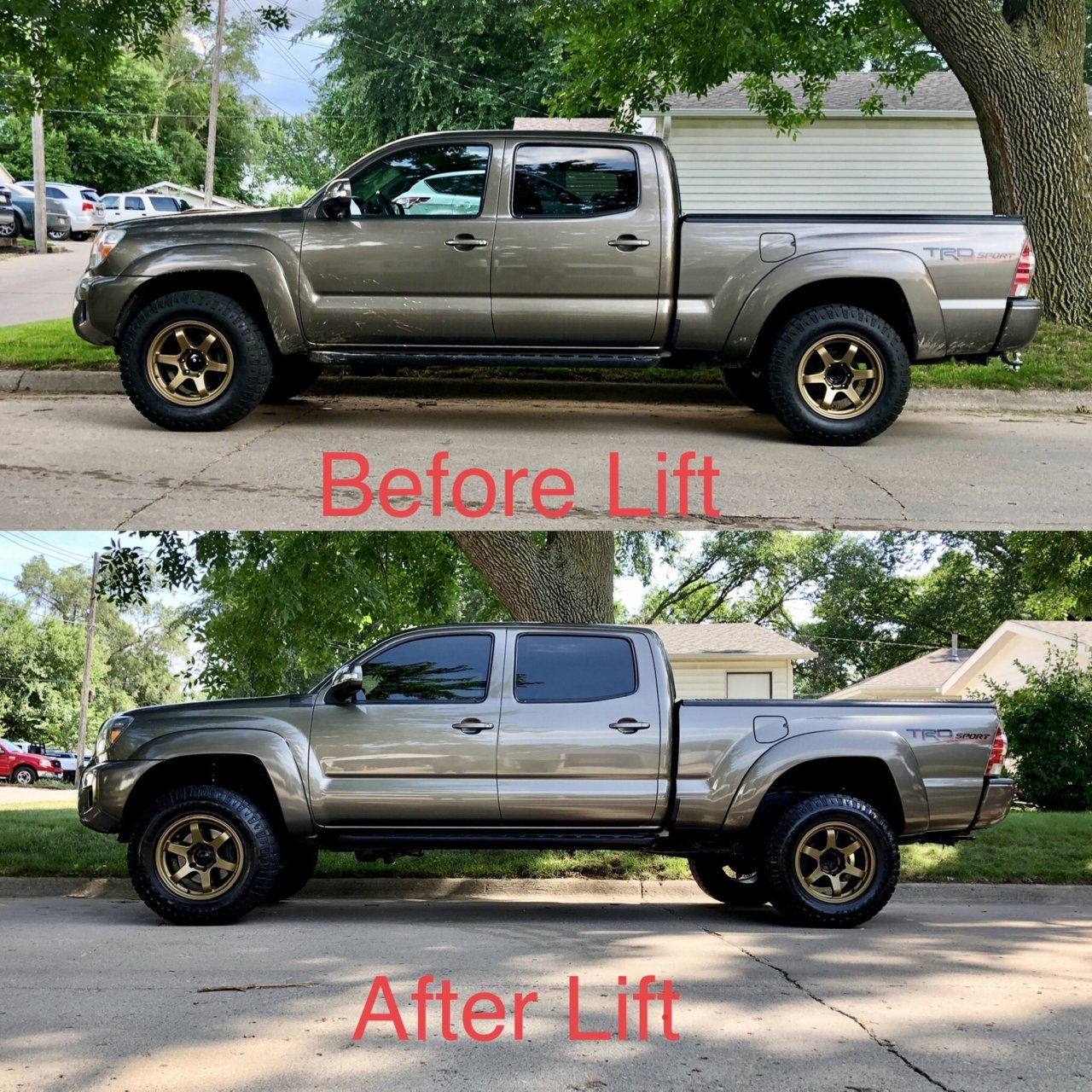

    Here is when I had the 265/70r17 Duratraces. The "before" was when I had 3rd gen TRD Off Road suspension (adds about 1.25" in the front, no lift in the rear) and the "after" is the combo posted earlier.

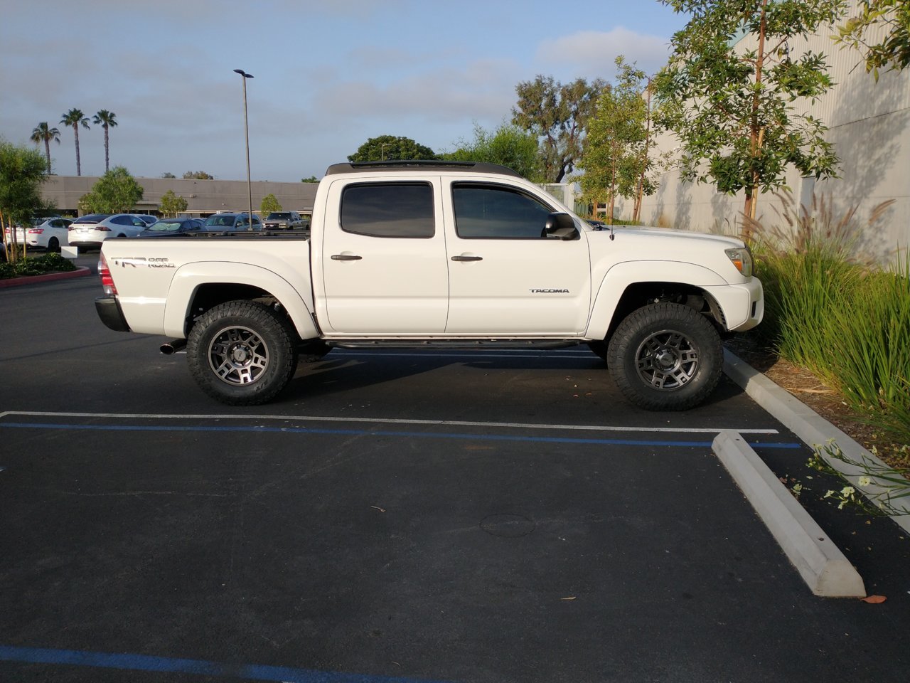

    IMG_20210604_070007254.jpg Don't worry, the 6112/5160 bilsteins are great!
    I'm on clip 5/5 with 3 leaf AAL in the rear and 255/80/R17 toyo AT3s.
