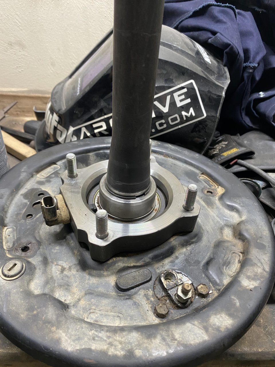

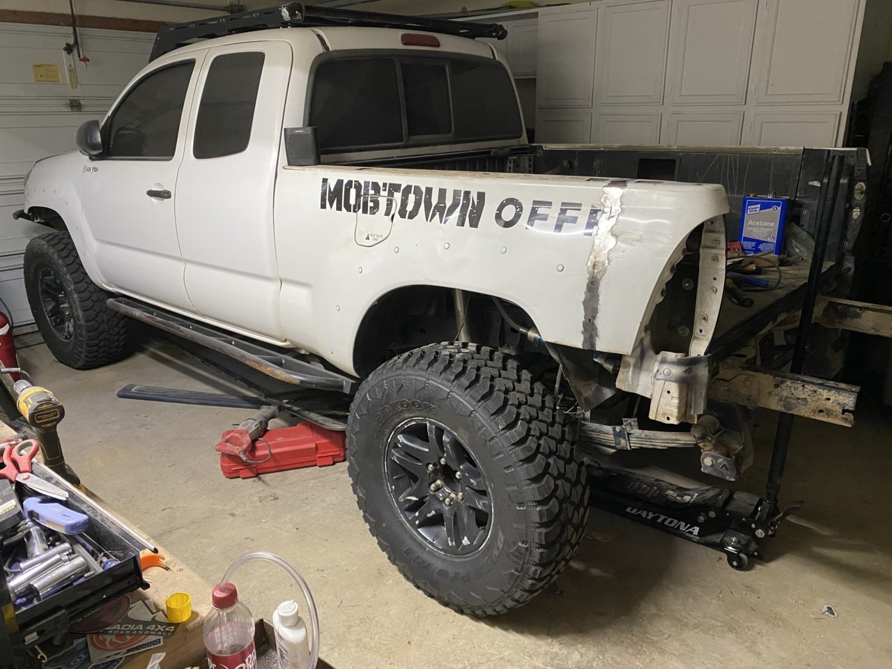

    Well she’s finally back on all 4, not like she’s driveable at the moment. My buddy who did the press work for me said he was able to knock the studs out with an air hammer.
    I was able to pull the new studs through just like a wheel stud. Stacked a couple washers and gradually tightened by hand. Did all 4 at once and pulled them in evenly.

    Bruh i think ur missing part of ur truck.. :bananadead:
    That's going to look pretty cool when it's done!

    About 14” worth!
