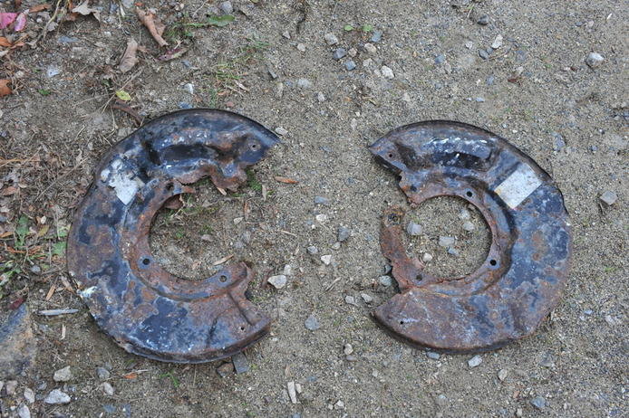

    I know a lot of folks don't care about these things and even remove them permanently but for those folks living in the rust belt, here is a way to easily replace those rotted dust shields without taking your hubs apart.
    The originals:

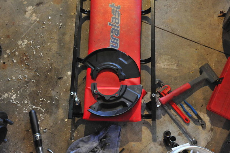

    New dust shields cut in half using a sabre saw with a metal cutting blade. I primed and painted the shield 1/2's after cutting.
    Installed:

    I was wondering how this would work, my shields are shot, but as you say, not worth pulling the hubs to replace.
    What did the new shields cost?
    Nice job!

    They were part of a bigger order from Village Toyota in FL so not sure what shipping would add but the shields themselves were around $20.00 each if I recall correctly.

    Good idea! Maybe figure out an easy and secure way to join the outer cut ends to keep the assy. rigid. I wish there was an easy fix like this for the rear backing plates. Mine are pretty bad.

    The saw blade kerf ensures about a 1/16 inch space between the two halves and the thicker metal that the bolts pass through provides sufficient rigidity to each half; there is no rattle or vibration that I have noticed.
    I was thinking the same thing but that is a structural piece for the the drum brake assembly.
