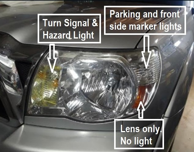

    Unless my wiring is wrong from the manufacturer, in Tacomas, the turn signal lights double as DRL's. In your image, the lights marked as DRL are the parking lights, aka sidemarker lights. Those bulbs are too small to be used as DRL's. In most DRL modes, including the Tacomas (in my Taco at least), with the light switch in the off position and engine running, only the DRLs light up - no sidemarkers and no rear lights come on. In the Tacos with DRL's, the light assembly was a shitty design as the plastic part where the signal lights are at, melted through the plastic over time. I replaced mine long ago because of that. If you get LED signal bulbs, you will likely experience hyperflashing. You will need a new signal relay or wire in resistors to prevent hyperflashing.

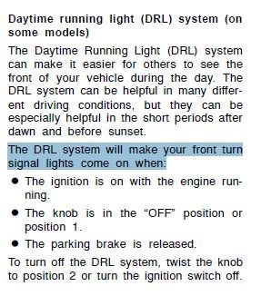

    It should read that DRLs are some times used with the signal lights; other times it's a dimmer version of the headlight system, as in my daughter's 06 Camry.
    From my 07 owner's manual:

    I’m not going to pretend I know where that’s from. I’ve never read anything like that. Obviously rules are different in Canada.

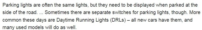

    As I said before, I learned that I do not have DRL in my truck. The parking light quote was from google.

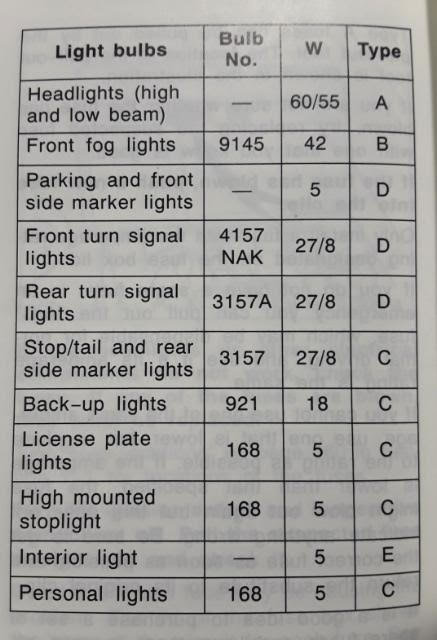

    What I have is "Parking light and side marker lights". Like you said I have to remove the burned light bulb and replace it with the same. See the light chart in my Tacoma manual. i think "Chuy" has a newer Tacoma model since he has DRL. Thank you both for your help!

    Sport models come with DRL's, at least in 07 they did. Don't know if it was an option on non-sport models. I got rid of the orange bulbs and replaced them with clear 3157 bulbs.

    On that chart, I see the 3157 bulb. But I do not see the bulb number for "Parking and front side marker lights"...weird. I need to remove and replace it with the same.

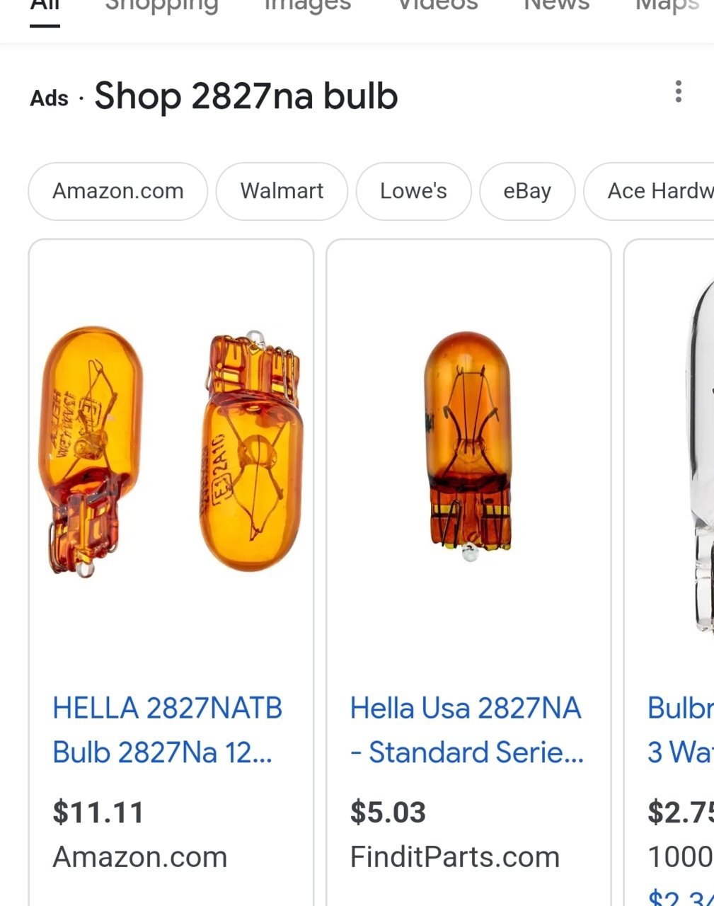

    Try 2827na

    I am posting this picture to correct the original picture. I do not have DRL in my truck. I have parking and front side marker lights. The amber lens below the parking light does not have a light. I think it is just for the look. I will purchase the bulb mentioned by Zman2k2. Thanks again.
