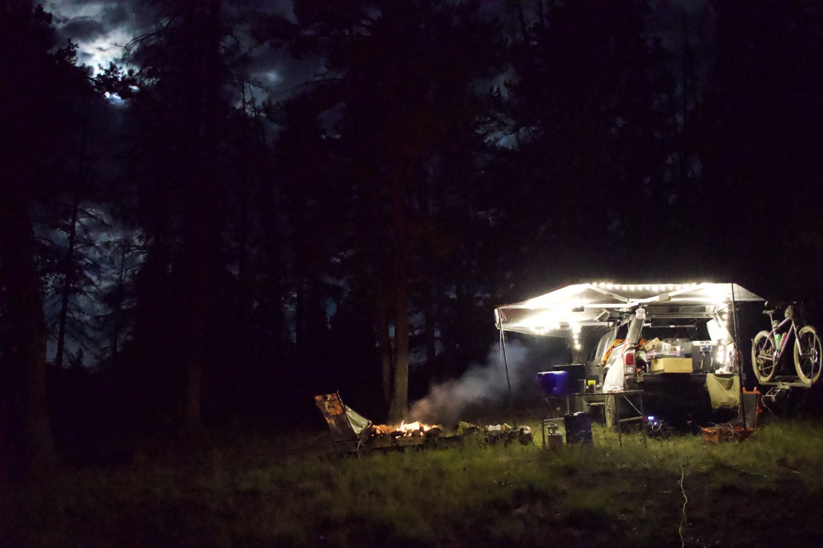

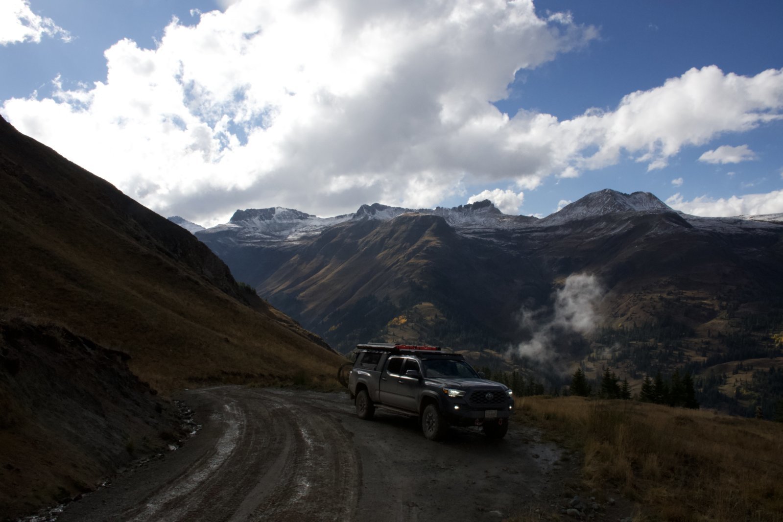

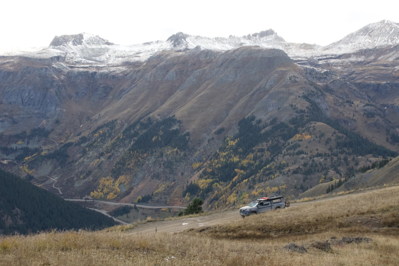

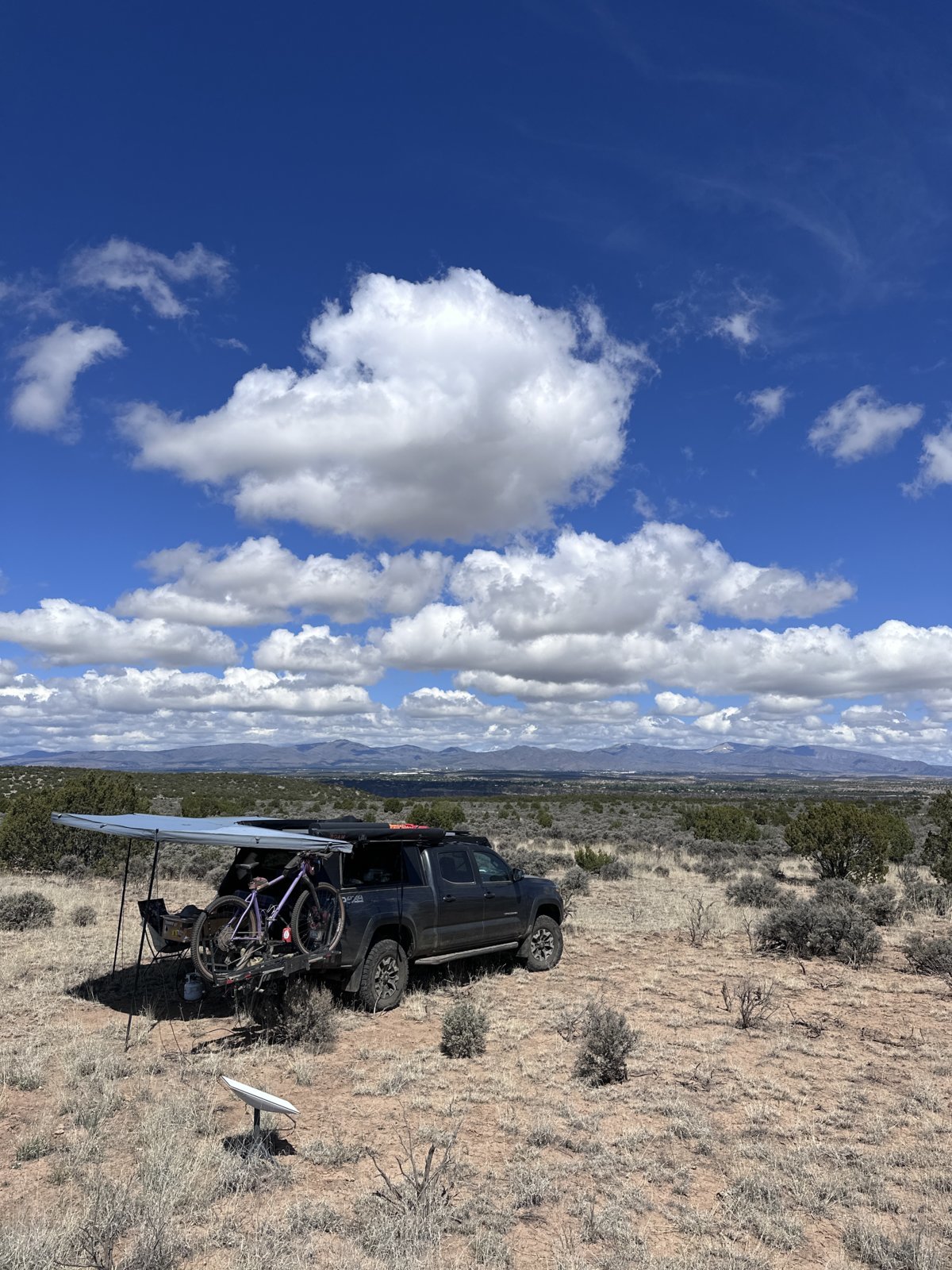

    Here's some older teaser shots of the setup, I now have a GFC camper top instead of the RSI.
