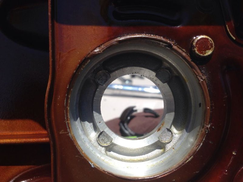

    Around the old seal there was some gasket sealer.
    Is it necessary for me to use sealer again? Or did the previous owner only do this as a temporary fix, and now the seal by itself will be sufficient?
    If I had some I would just use it to be safe rather than sorry. But it's now a PITA to get to a store.
    Please let me know if what I'm asking is unclear.
    Thanks for your help.

    Must of been a temp but i wouldnt use sealer just replace them with oem

    yeah i would just replace with oem seals. ive been meaning to do this for the past 2 years. Ive got oil in my 4th tube but no misfire.

    oh and just a reminder don't use the ones from autozone or whatever they suck. within a few months mine started to seep from those seals.

    Thanks for the replies. That's kind of what I figured and just went with it.
    Got the seals from rock auto.
    I had oil on my first and fourth...no misfires but it just bothered me. Once I took the valve cover off I saw that the first and fourth didn't have gasket sealer going all the way around...second and third did. So the problem was pretty clear.
    Thanks again for the help.
