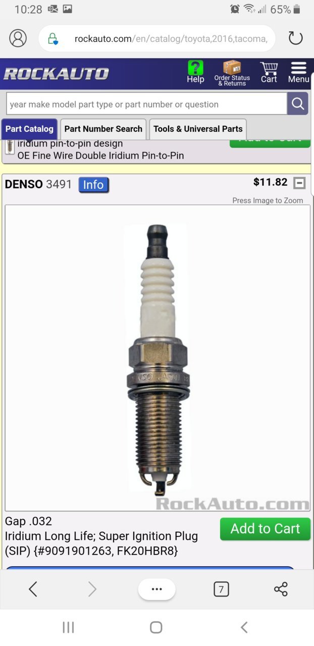

    rockauto was definitely the cheapest I found, as well.
