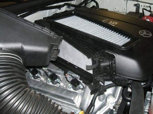

    Here's a picture of the air filter setup with the replacement AFE oil free version I used laying on top. The white filter still in the housing before the intake of the throttle body is the secondary held in place with 6 plastic welded heat rivets. A small wood chisel and light taps with a hammer will pop off these rivets quickly. The K&N or AFE will go back in just like the OEM with the thicker part of the filter towards the intake tube from the fender area.

    Why a K&N? Why not an oil-free AFE Pro Dry? Easier to clean, no cleaning kit to buy, no risk of fouling the MAF sensor by over oiling! :thumbsup:
