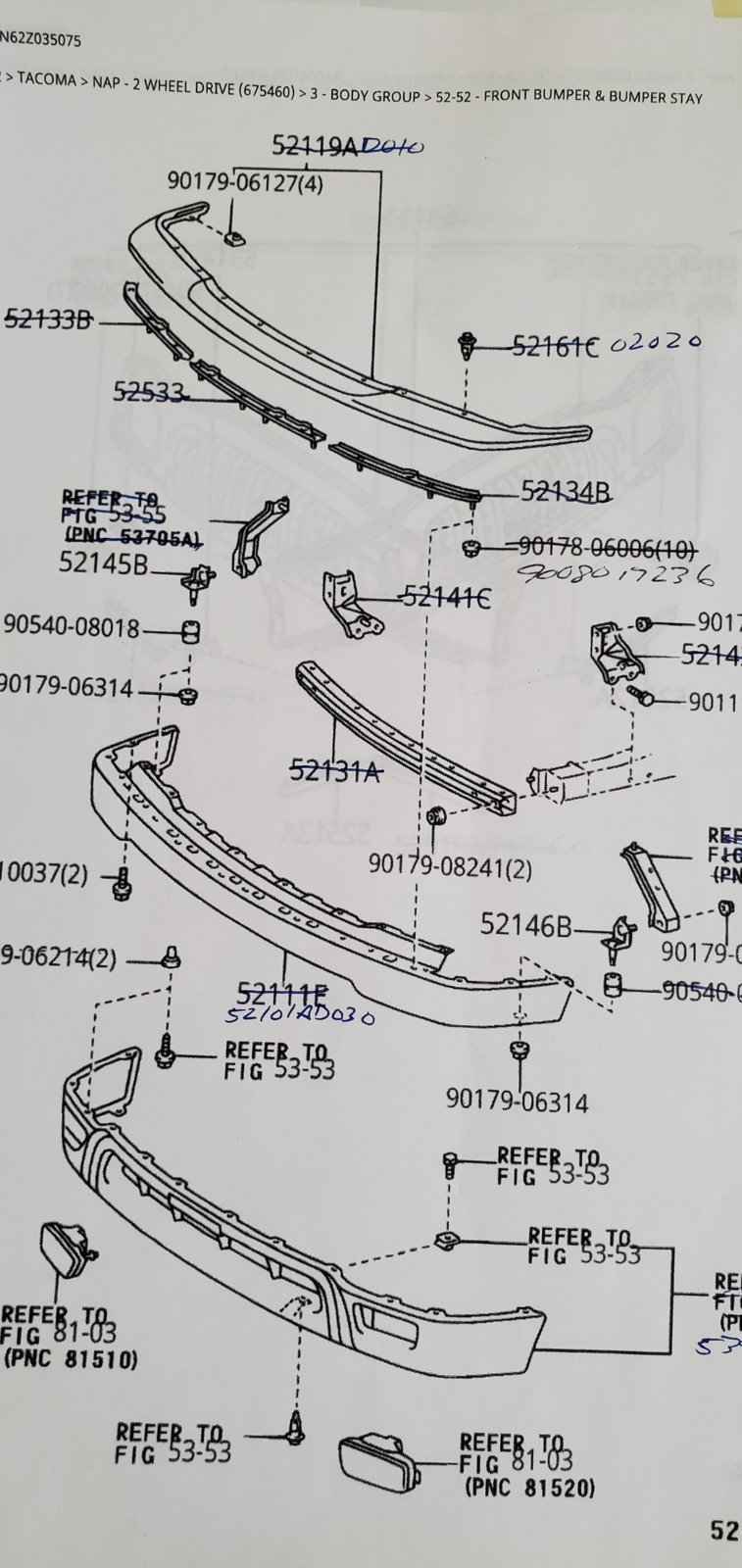

    So the bumper bracket was rusted off on my 2003 tacoma. Ordered new bumper and took off the old one today. All brackets and clips holding the valance and the top painted part were rusted and useless.
    Anyone have a link to all the parts needed or a good illustrated parts breakdown with part numbers? Not having any luck finding a good one on through google.

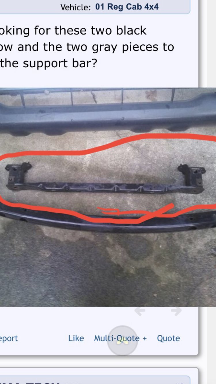

    Are you looking for these two black pieces below and the two gray pieces to the left of the support bar?

    No, looking for mostly the small parts. I found the 3 brackets that hold the top skin on to the bumper. Still looking for part numbers for the metal clips with bolts that hold the bottom valance on and the corners of the top skin. Oh and the 2 rubber grommets for the corners of the bumper.

    You guys get this sorted? That 90179 # is a nut by the way...

    @KStateTaco
    do you happen to have the part number to the lower valance support? It’s the top metal support in your picture with the 90 degree ends. Can’t find the part number anywhere. Any help much appreciated!

    You want the pieces that are held on with nuts? And have the grommet that slips into the face bar? 52145 & 52146-AD010. I have the grommets if you want them for a few bucks.

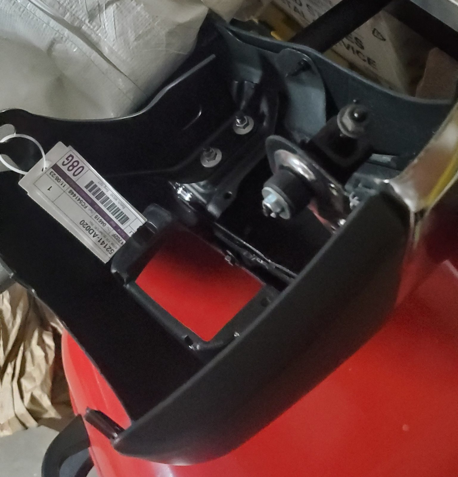

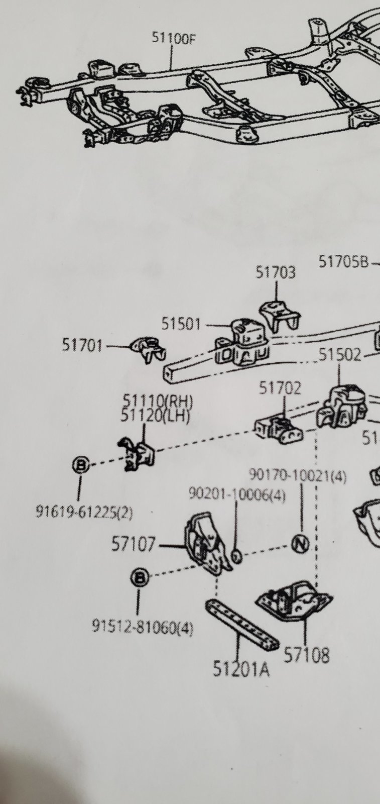

    So that's 3 different pieces-
    52131-AD010 is the reinforcement (52131A)
    Then you need 2 extensions- 51110-35030. They have two different call outs but are the same p/n. 20240209_201930.jpg 20240209_201848.jpg

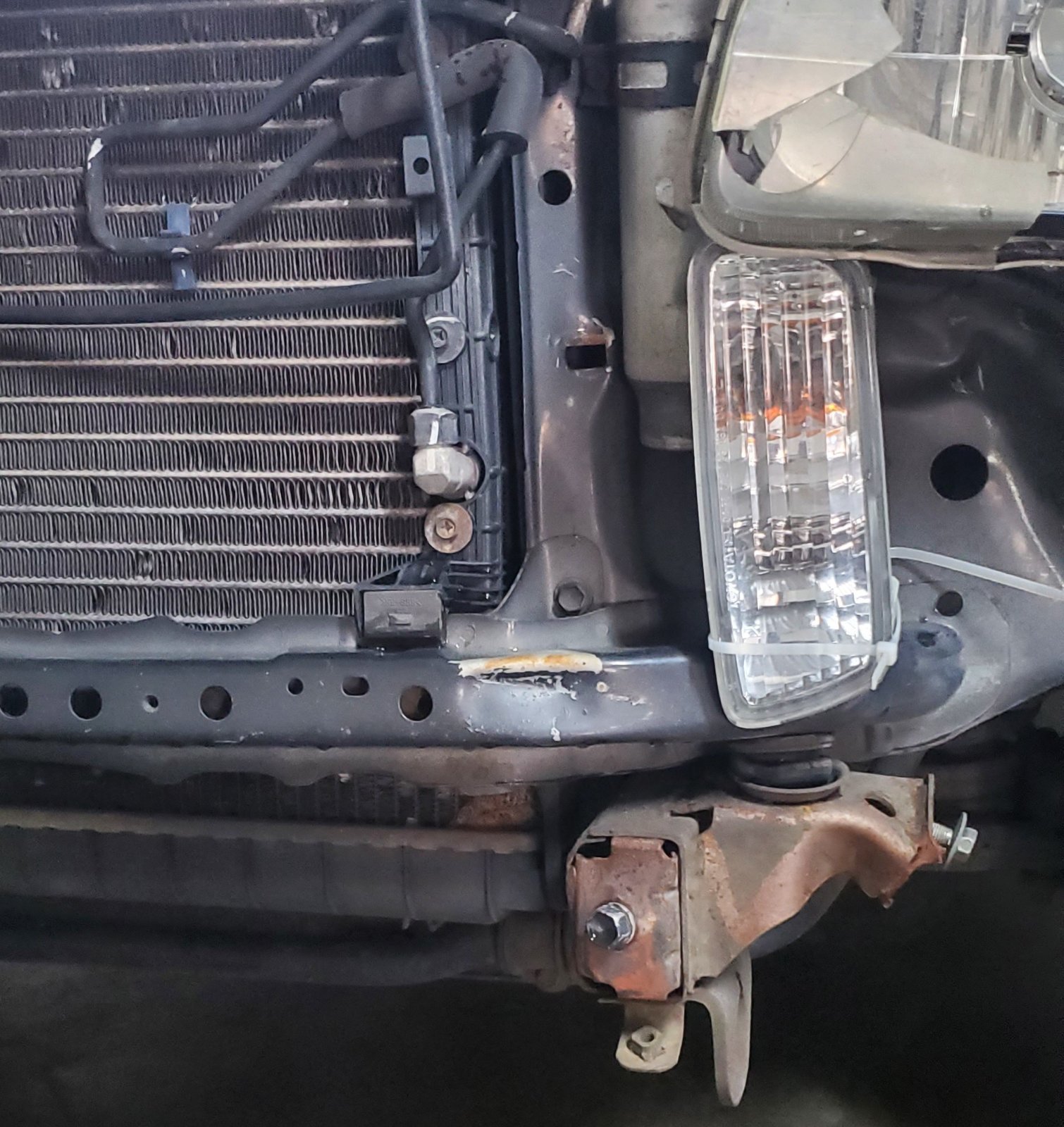

    20240210_093859.jpg 20240210_093949.jpg No problem dude. I just replaced all my shit in the front then packed it months later. Oh well.
