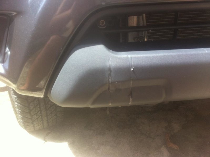

    Hey fellas yesterday i scraped the front of my car it's just mainly the plastic part under the lower grille. And I was wondering if it was easy to replace or would I have to take off the whole bumper on my 2013 tacoma? Thank you!

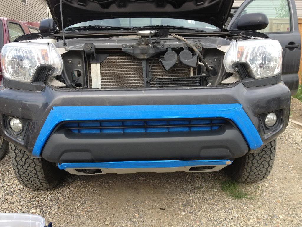

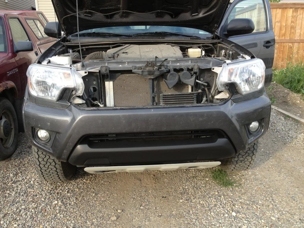

    Dipped lower valance. Without being removed.
