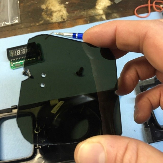

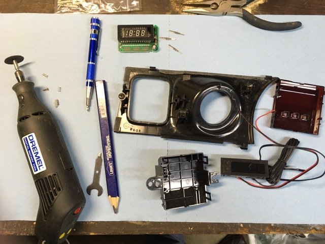

    I got tired of my factory clock fading in and out due to the faulty circuit board, but I love the clock and wanted to upgrade it while keeping that same look. I love the way the clock hides behind a piece of smoked plastic, so I decided to upgrade it and keep it that way.
    I bought a digital clock off of an online auction site :anonymous: and chose the green option for illumination so it would match the rest of the dashboard at night.
    This particular clock also indicates inside/outside air temperature as well as system voltage. I know those are basically novelties, but I like the fact that it automatically scrolls through those readings on its own.
    It came with two wired temperature sensors - one of which has about 3' of extra wiring so you can route it to the exterior of the passenger compartment. You can see the new clock and wiring in the bottom right corner in the picture below.

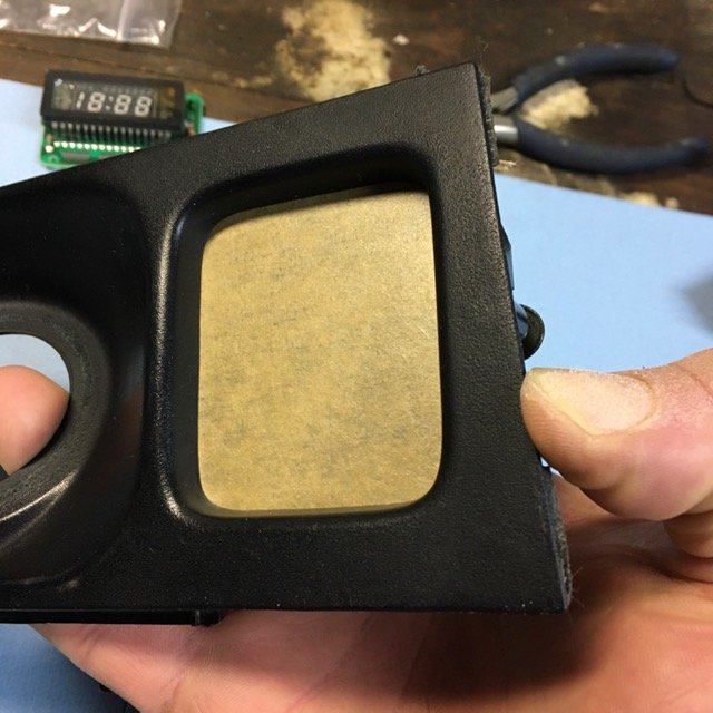

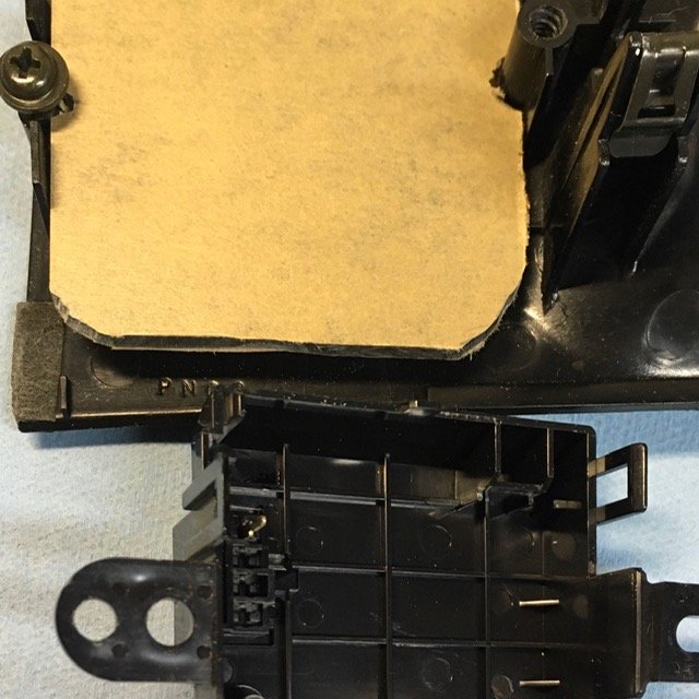

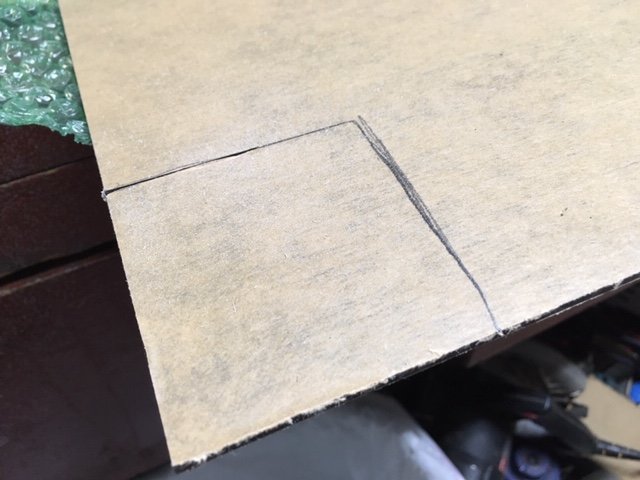

    I started by cutting a piece of 1/8" smoked polycarbonate sheeting to fit the opening where the factory clock was. There was a protective film on both sides, so I kept that on until I was ready for final assembly.
    I cut it wider than the original and notched the sides so it would fit in snug with the screw posts, and it's held in place simply by pressure from the clock assembly once it's all screwed down.

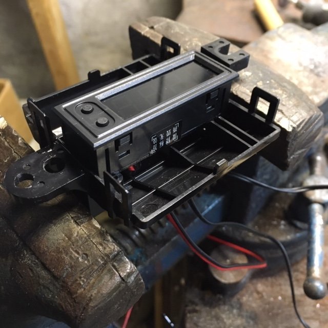

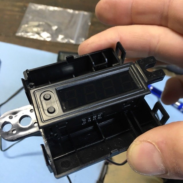

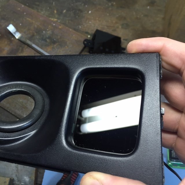

    The clock assembly actually fit really well into the factory housing, so I simply approximated where it needed to be and epoxy'd that thing in there! :rofl:
    After marking where the two buttons would be on the other side, I drilled two holes in the polycarbonate so the clock could be adjusted without tearing the whole thing apart.

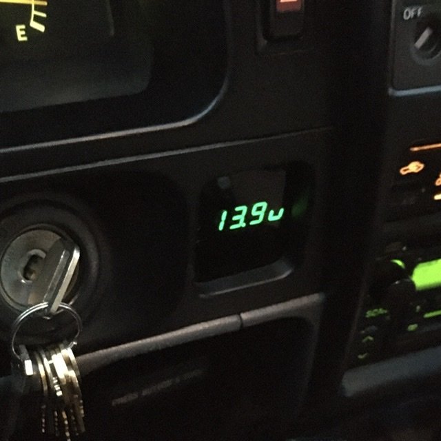

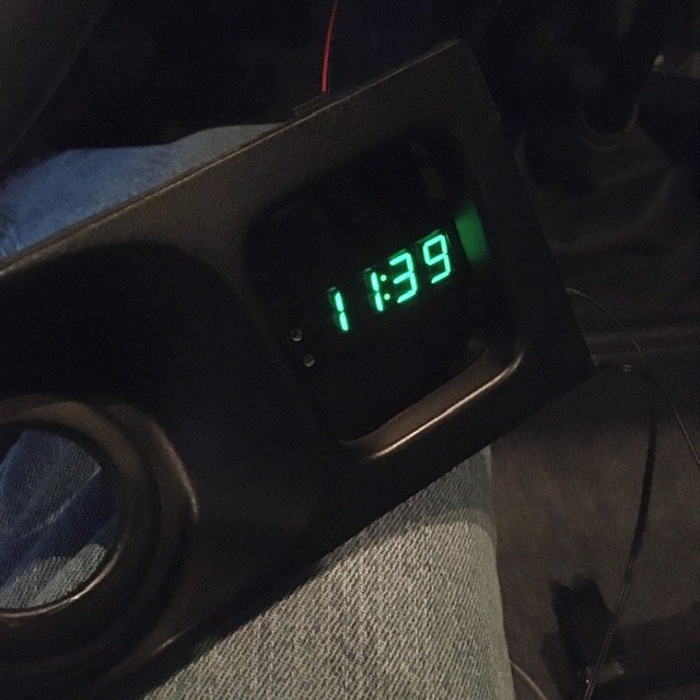

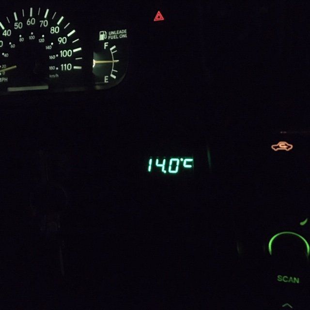

    Wiring was easy, for the most part. I simply reused two of the terminals from the factory harness and wired it up to the ACC feed so it wouldn't be on all the time. It must have an internal capacitor or battery because it still keeps time even when the ignition is off.

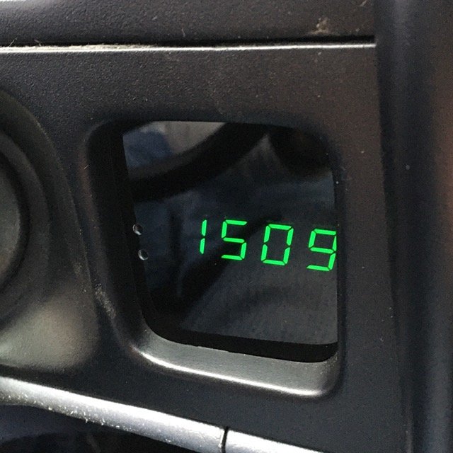

    Success!

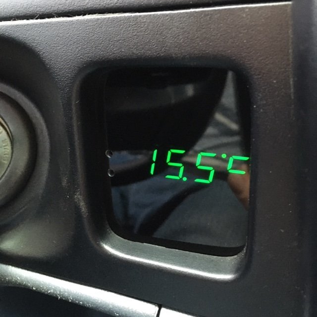

    The only drawback is that the temperature readings are in celsius, so I had to figure out the conversion until I could figure out how to program it. :rofl: It came straight from China and had no instructions whatsoever.

    Very nice. I second the request for details about the clock. Were you able to figure out the programming to show F rather than C?

    I haven't gotten a chance to program it yet, but will noodle around with it tomorrow and report back!

    Well, you’re 100% right about that. I stuck the sensor through the grommet in the firewall near the gas pedal, and it gets a fairly accurate reading... as long as you’re moving. :rofl:
    I just discovered that as soon as I stop at a red light, the heat in the engine bay begins to build and that number shoots right up. It’s kind of funny, to be honest.
    I will have to find a solution for that.

    Took a pic of the system voltage readout:
