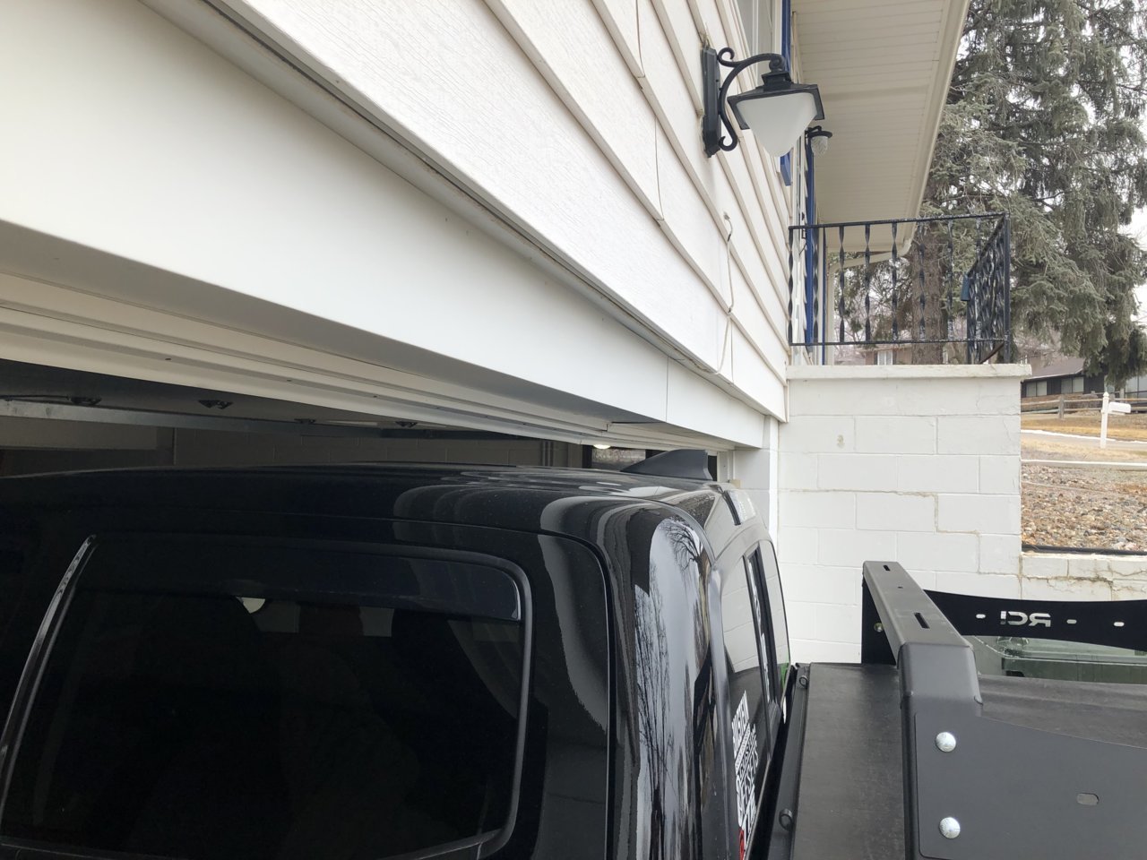

    "another route, which shows how unnecessary the height of the fin is...
    http://www.bodenzord.com/archives/1449#more-1449 "
    I wonder how much of that fin is solid on top before it becomes hollowed. In other words if I could simply cut 1/2 inch off the top and still be sealed from the weather?
    It barely impedes my lumber rack— but I always have to be aware of the intrusion. To cut off the top would be an easy answer.
    Thoughts?

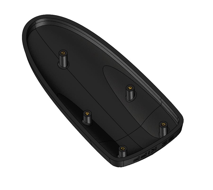

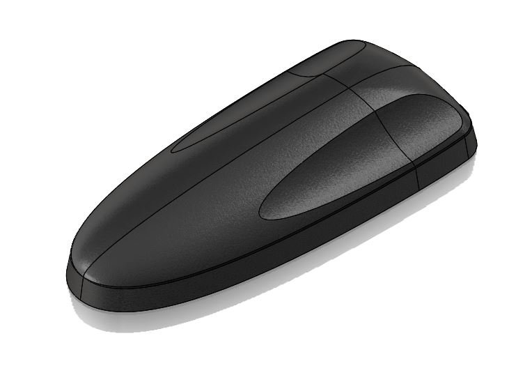

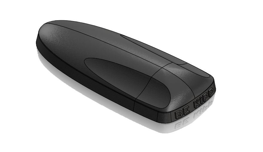

    I’ve been quietly working on a replacement cover for 12-15 shark fins with my college buddy who is a design/3Dmodeling dude. Here is a rendering of the final product. We will have pictures of final product mounted on my truck soon. I wonder if there is a market for these.
    6EDCEC26-CB23-4186-81A5-6FEB58619C89.jpg 509F8AD8-5D73-44FA-AE62-30D413D35F51.jpg DBFA7AC7-4458-4AED-B412-9029A8911ACD.jpg
    This is the fourth revision. Getting all the compound curves to match up with the factory gasket has been tedious. The mounting stands will have brass inserts for the positive locking of screw fasteners.

    I'm interested but depends on the price. I'll have to do something with my sharkfin in a few months and replacing the cover would be a lot easier than cutting and fixing up the existing one.
    it looks like a nice factory quality replacement!

    The goal has been exactly that; factory replacement quality.
