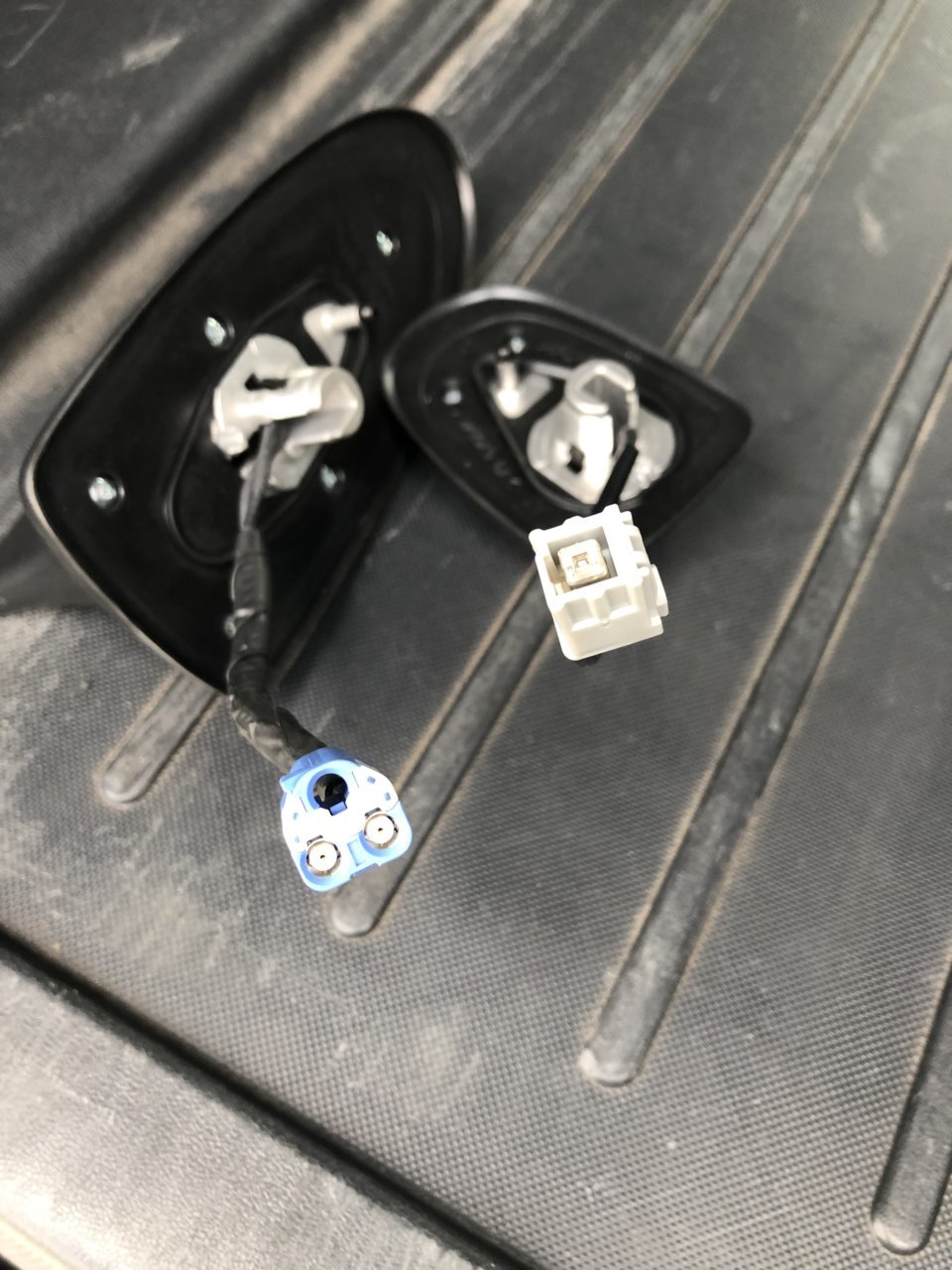

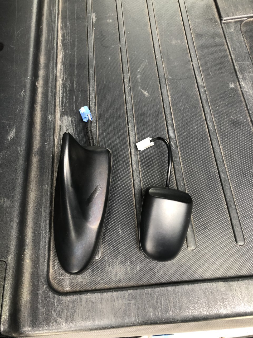

    Someone noted that a 2015 pro had different connection and it didn’t work
    hoping it works on my 2014 off road

    Ok, confirmed this will not work on my 2014 Off Road.

    Damnit! Back to the drawing board for me. I completely ripped the plastic wire connector apart so it’s not even like I can just reattach mine.

    It is a bitch to get the old sharkfin out, you have to dropp a majority of the headliner, as the locking nut is on the inside of the cab, so removing the headliner is the only way to access it.

    I found that the rear seat rest had to be removed in order to allow the C-Pillar to be removed. The C-Pillar has to be removed in order to release the headliner. It is doable by a newbie (at least I figured it out) but I wouldn’t call it easy.

    @Anderson not sure if you can help, but do you think I could do this to the coax wires to get back the functionality of the Shark Fin? Since my blue connector harness is ripped to shreds and nowhere to be found online.
