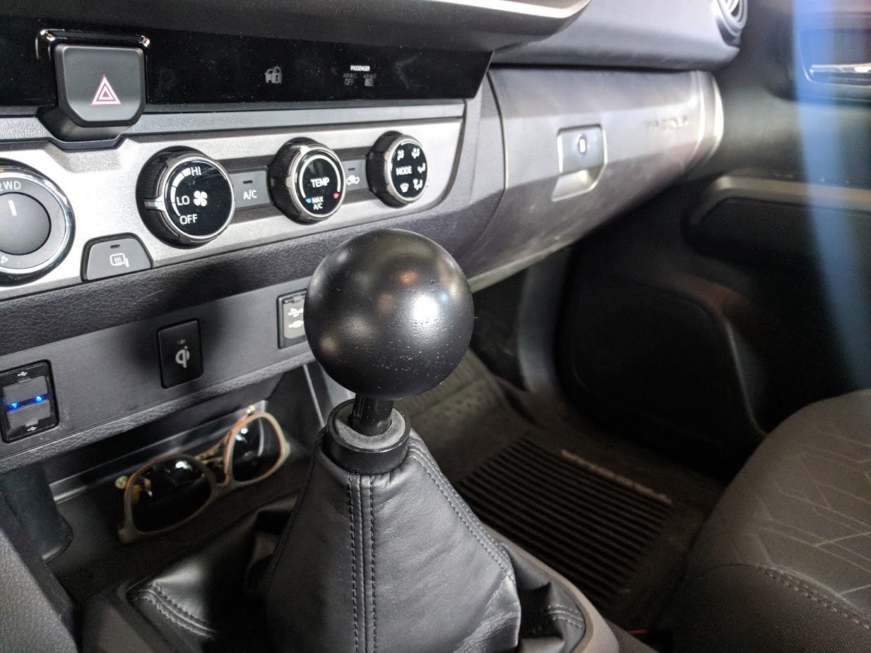

    Just sand and paint the clip. It then blends with the grommet and boot becoming nearly forgotten:
    I didn't mind it being chrome with the stock knob because I never really saw it. Something had to be done with the knob that I made.

    Tonered - What is that that you used to fill in the gap between the shifter and "bezel"? It almost looks like a felt cymbal washer from a drum kit cymbal stand. Now that I think of it, that could be shaved down I suppose, to fill the space to prevent it from rattling during shifts.

    That's the HomeDepot rubber grommet that gets mentioned a lot:
    https://www.homedepot.com/p/Everbilt-3-4-in-Neoprene-Grommet-812048/204275920
    You have to trim off the bottom flange.
    There is also a pack of six of these where the zip ties are.

    Get an Everbilt 3/4" Black rubber grommet #588 739 from Home Depot. Works perfect.
