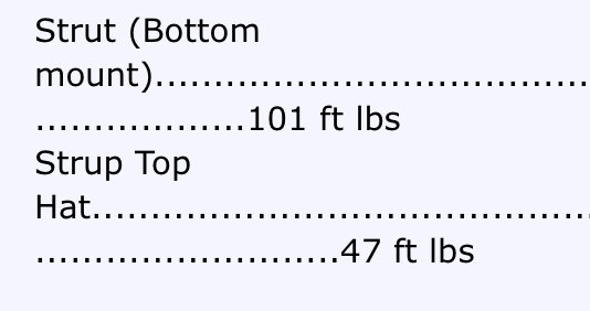

    Here you go
    bubbas[OP] likes this.

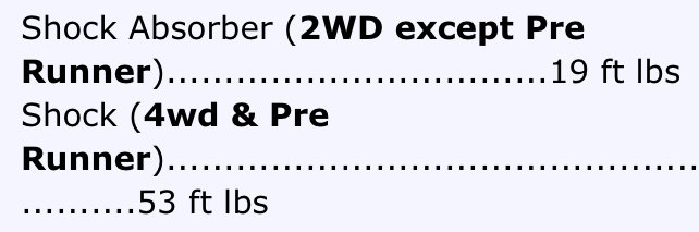

    2nd one for the back?

    Do you guys out that goop on the 3 top bolts? so they don't reverse?
  7. Jul 13, 2025 at 10:12 AM
    #27
    foresterfields40
    foresterfields40 Well-Known Member
    Apr 20, 2022
    #395485
    69
    ‘99 Tacoma 3.4 4x4
    Yes second pic is for the rear shocks. For peace of mind you could put some blue thread locker on em but shouldn’t be needed

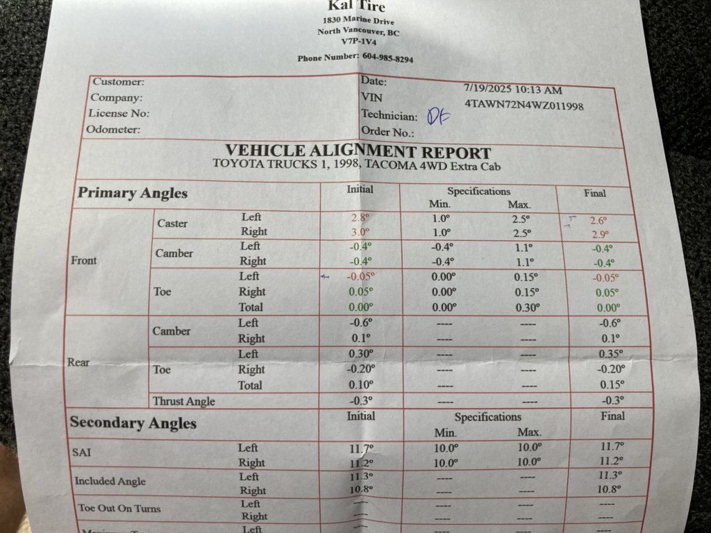

    I got the tires rotated after I replaced the front shocks and they said I really didn't need the alignment because I was just slightly out. These are the numbers. I know nothing about them so post em here.
