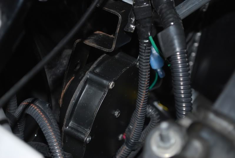

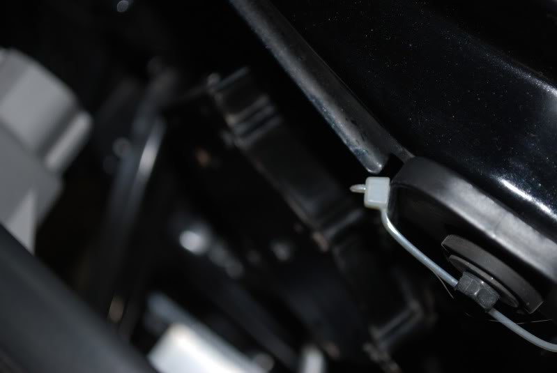

    You don't have to take off the bumper to do it. All you have to do is remove the grille, then you can get the old horn off (I think if was on the passenger side) then you can hook up the 2 new ones. I mounted mine with the bolts that were already in place in front of the radiator. I fed the wire around and mounted the relay right behind the driver's side headlight then connected the wires to battery/horn.
    You want to make sure they have a clear-ish path in front of them to get the most sound out of them. The relay was also a big help, otherwise you won't be able to get enough power out of the horns.
    And looking at the ones you are looking at, I might have overpaid... I paid a lot more for mine with a lower db rating... I'm not sure how these will hold up since I just got them but so far I have to say I'm impressed with them. (Not hard to do compared the bike horn these trucks came with)
    Just send me a PM if you have any questions but the wiring for these things shouldn't be too bad if they are anything like the one's I got.
