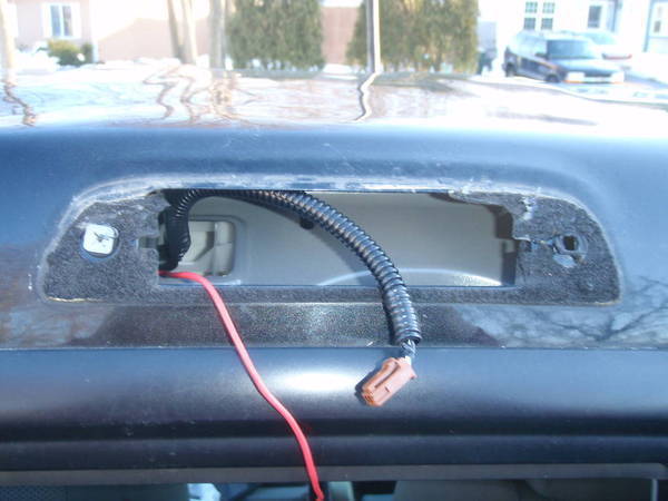

    nope, no need to take down headliner. just take the screws out and pull the lens off. those 2 screws go into 2 anchors, the spreading kind like for drywall. they are square and white. after you take the lens off, pop those 2 square white anchors out with some needlenose or a screwdriver. thats the only hardware that holds it on. there is also some serious adhesive stuff around the back of it. when i did mine i used a putty knife, razor blade, and screwdrivers to carefully cut through the adhesive/ pry the plastic off. just be careful not to scratch anything that your new lens won't cover. i did more slow prying than cutting.

    Update: i just looked at my pictures, and you dont need to take the anchors out first. you need to pry the silver plastic off first, then you can take out the anchors. heres a picture from my mod to help. You can see that one anchor is still in, one has been popped out.
