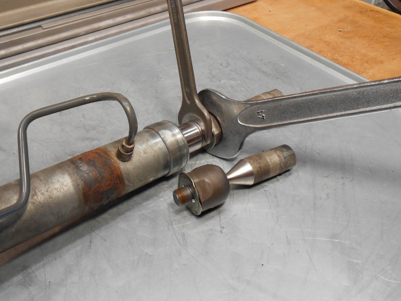

    With your year there is a very high likelihood that you may have a worn part in the steering rack known as the "rack guide" and the ITR is fine.
    To determine the culprit yourself in minutes, release the clamp and pull back the driver side boot on the rack. This will expose the ITR and the end of the rack shaft. Now vigorously shake the tie rod (steering wheel unlocked) and observe exactly what is moving. Play will be seen/felt in the ITR joint itself or the end of the rack shaft will move.
    The early racks had a "guide" notorious for developing play in as little as 20K-30K miles. This play in the guide is mistaken for a loose ITR by "techs" all the time. The guide has since been upgraded, lasts significantly longer and is easy to change. Frankly it should be changed out just as a matter of PM. All this is assuming that it is the original rack.
    As far as that video, if that kid worked for me, he would be fired so fast his ass would burn. Clubbing that rack shaft with a mallet like a baby fur seal? Please, and it's a lock washer, not a thrust washer.

    I'm having a hard time seeing how that tool could slip over a Taco ITR and still fit the flats. The 4 flats are a smaller diameter than the body of the joint.
    Does the tube slide over the joint then one of the crows foot looking adapter/wrench things slip in over the flats and lock to the tube?

    don't over complicate things that are already simple, just use two open end wrenches as shown in the video and don't bother with specialty tools you will only use once, maybe twice in your lifetime.

    Well sonny, take another look at the pic in my post you quoted. I call those open end wrenches, 30 and 41mm service wrenches to be precise. I use them all the time.
    As for the vid, go back and read the last line in post 4.

    so you have two wrenches and you have removed and replaced the tie rods, so why do you need this fantabulous tool from harbor freight? the place notorious for selling low quality Chinese made cheap crap?
    don't get me wrong, lots of cheap tools still work great, I have lots of cheap harbor freight stuff. now if you can explain why the tool is needed when everything you need to do the job is just those two wrenches alone, then all I can see this fancy tool is good for is to brag that you have one.
    as for the vid, yes he is an idiot and probably caused the steering seals to leak the way he beat on it for no reason at all and instead of tapping the washer over at and angle like he was supposed to, he tries to hammer it straight on to crush it.
