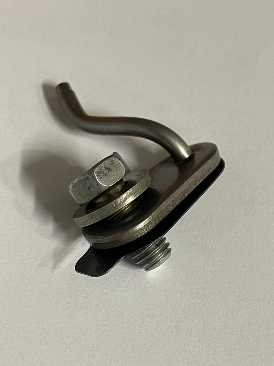

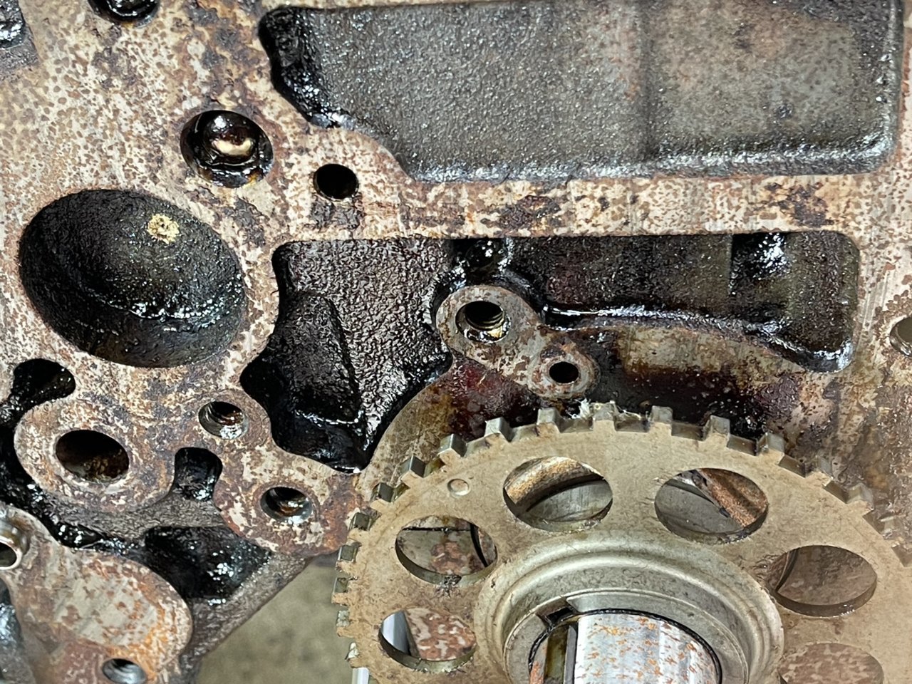

    I have a 2000 Tacoma 2.4L 2RZ-FE engine that has an OIL JET. I removed it to check to see if it was clear and then went shopping for a gasket for it. Nobody seems to know anything about that OIL JET or its gasket. Anybody know where I can buy one?

    Post a couple of pics of what you got....

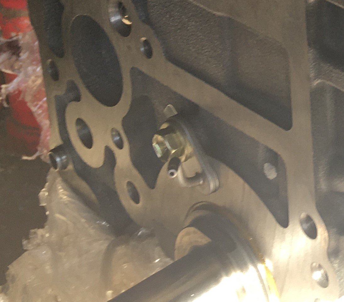

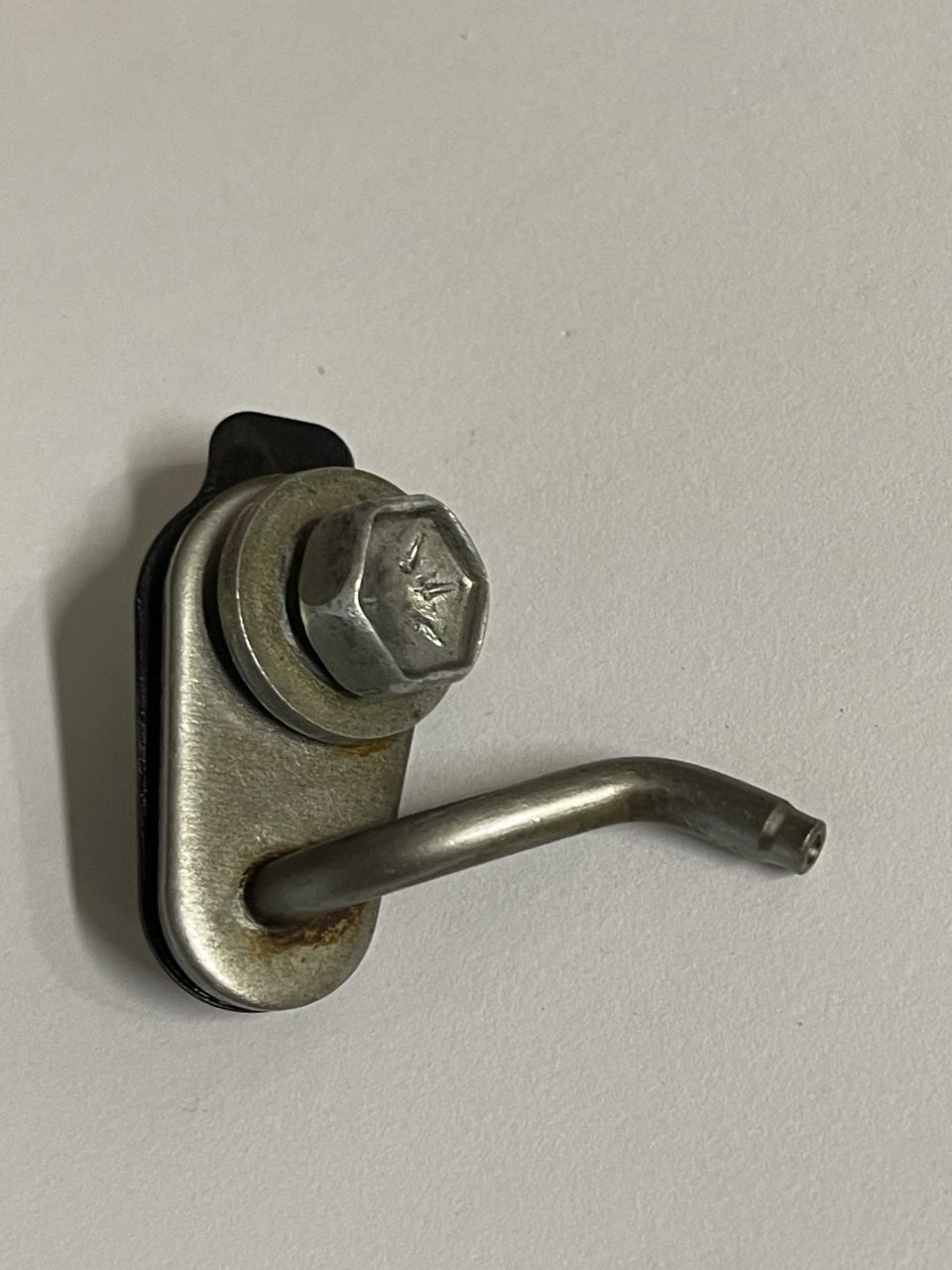

    IMG_8300.jpg Got the photos of the “timing chain oil jet” you requested along with photos of the timing chain and the two guides, and watched the “Car Care Nut” fixing the 300,000 Toyota.
    I enjoy “The Car Care Nut”’s YouTube channel, btw. The place in the video you pointed out was where he picked up the timing chain and claimed that since it was still within specs, he wasn’t going to waste the customer’s money by throwing the chain away and using NEW?
    Well, that is truly interesting to me. The vehicle had 300,000 miles on it. My 2000 Tacoma currently has 175,000 miles, far less, and when I measured to see if my chain was within spec, the FSM gave a max measure of a length of 16 links at 5.807” (or something) and my measure was over 6.2”, so I purchased a new chain from Toyota!
    Others on this thread suggest also that new chains are rarely needed, so asap I am going to recheck my measurements. I bought a new chain as well as both sprockets, to make sure I will not be effecting the timing. That’s a lot of money for me, so remeasurement is definitely on my todo.
    Here is the first photos of the “timing chain oil jet.”
    And the place where the oil jet was mounted on the block.
    It was set to spray oil all over the timing chain as it was running through the inside of the timing chain cover.

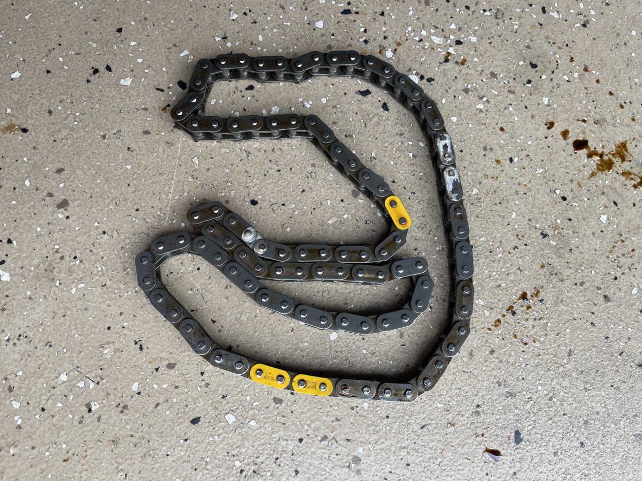

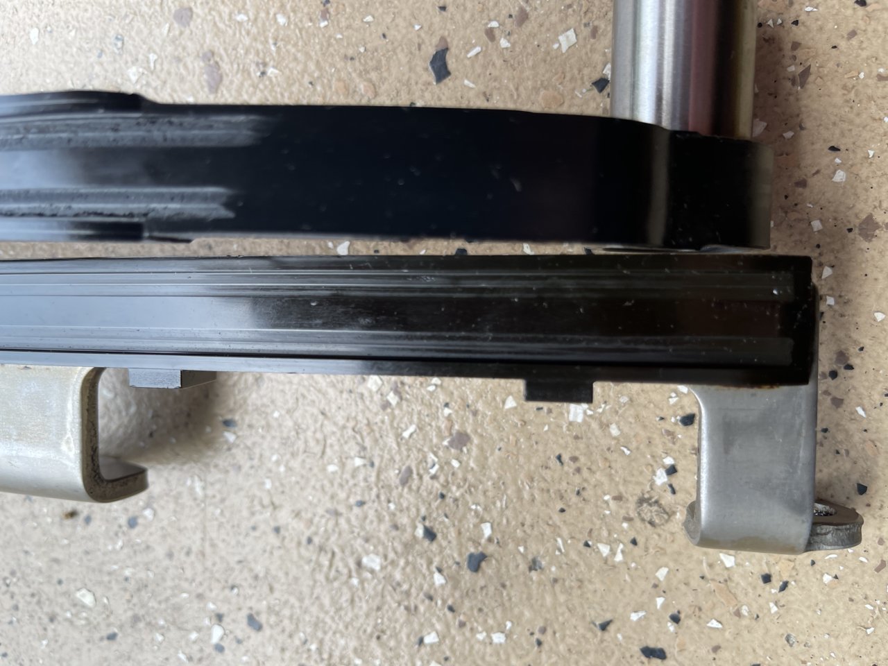

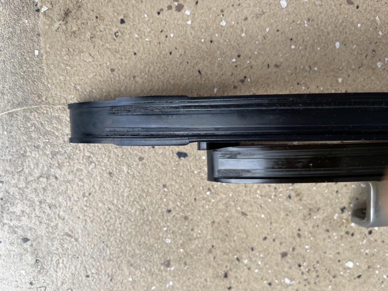

    In case you would like to see how the timing chain guides looked after 175 K miles:
    Sorry about the quality. Lastly, the chain, just to show that the yellow links were still yellow, so overheat wasn’t my problem.
    McGeorge Toyota replied with an email telling me that the Timing Chain Oil Jet Gasket was available (but I couldn’t find it) as part number 11496-75011, called “Gasket Oil Hole Cover.”
    So, for anyone interested in knowing why they cannot find information on the Timing Chain Oil Jet, it’s because Toyota calls its’ gasket an OIL HOLE COVER!

    Thats a lot of wear on those guides .....most I've seen on a toyota...
    I would replace guides, tensioner, chain, and the sprockets...
    I know that's quite an investment....but its worth it....

    And there is something not right.....those guides should not have anywhere near that much wear.....
    Sometimes people think these Toyota's and lexus's need less tlc....
