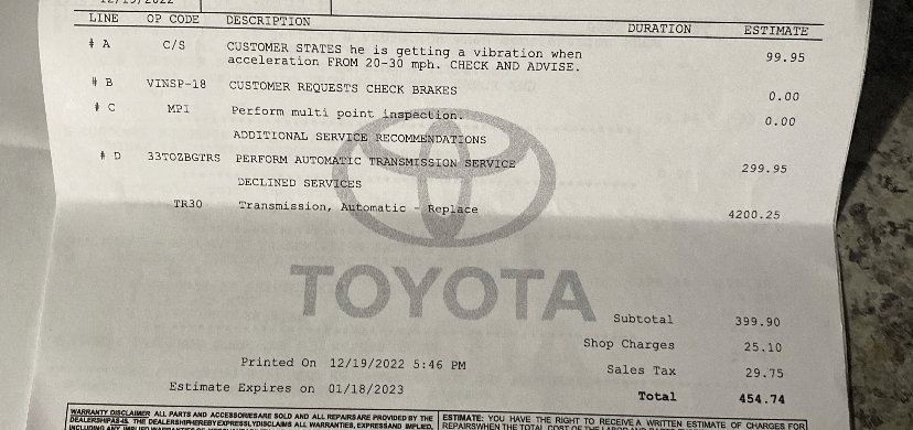

    I’ve got a 2017 TRD off-road dclb with 129k miles that developed a bad vibration when accelerating between 20-30mph. Took it to a local dealer to get it checked out (thinking cv, u joint, possibly even wheel weights) and to my surprise they said the transmission is bad. Quoted me $4500 to replace.
    Has anyone had a transmission go bad that early? Both guys I spoke to at the dealership said it’s the lowest mileage Tacoma they’ve seen one go out

    I'd certainly want to know a lot more about what's going on AND get a second opinion from a quality independent shop.
    Side bar. 4,500 seems cheap to me for one of those transmissns + labor.
    @Bishop84 ?

    Did they actually explain what the transmission issue allegedly is?

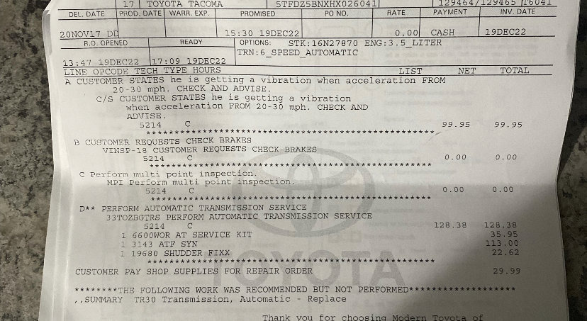

    Bad TC and some other things, like I said I don’t know much about them but everything is on the diagnostic report I can check when I get home. They said it threw 3 different codes. Charged me $450 for diagnostic, trans fluid flush and replace, and some sort of additive they said could help the shudder.

    Smells fishy. If it's bad an additive isn't going to do anything. Definitely get a second opinion. I'd also get all the stuff they say is wrong in writing, and if the second opinion shows it to be BS I'd be for making more noise. Bad shops stay in business because people don't know they are bad.

    I've seen a lot of torque converter issues on Camry and Corolla. So I wouldn't be surprised to see it on a Taco. Usually the clutch material in the converter goes through everything. At that point its cheaper to replace the trans. Looks like the labor guide calls for 9 hrs to replace transmission. At $150/hr labor rate, which is what we charge, would be $1350 labor. So $4200 sounds about right.

    You might need to drive it for the week or two before bringing it to that other shop. Just to see if that magical "Shudder Fixx" stuff might fix the problem for you... :rolleyes:

    I’ve never seen fluid fix a torque converter shudder. I had to ban one of our advisors from selling the flushes because it never solved it.
    I’ve never seen a Tacoma tc shudder in my career though, I’ve changed probably 300-400 converters in other models.
    Unless it’s so bad it shakes the dash the converter alone usually fixes the problem.
    But 4000$ sounds amazing, I think that’s a stellar price.
