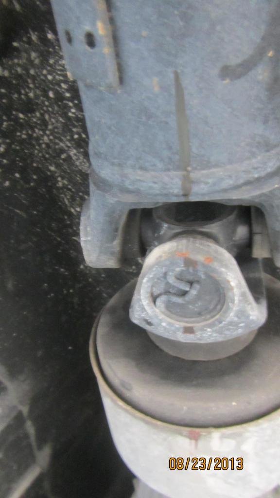

    IMPORTANT: Use white out if at all possible, and/or chalk or a marker, but try hard to get white out since its the easiest to see and won't disappear in the wd-40. Use this to mark a line down your driveshaft. You want this thing going back in in the same orientation it came out. I had a marker and I could barely make out the mark I made with a marker at the end.

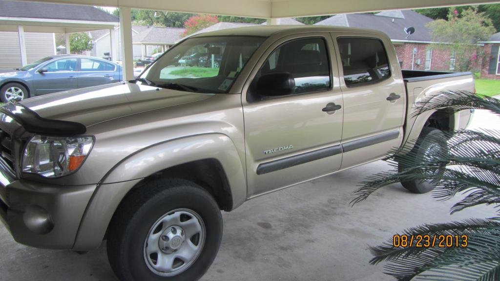

    To start here's the project truck:
    2005 Desert Sand Tacoma DCSB

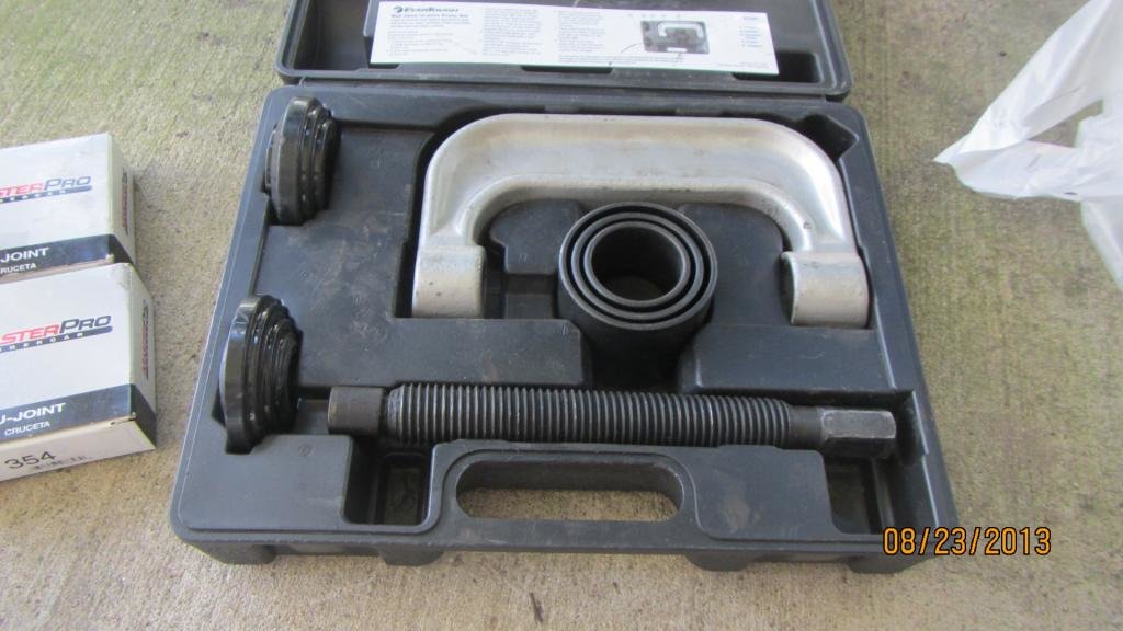

    Tools I used to replace my U-Joints:
    O'Reilly Ball/U-Joint Press

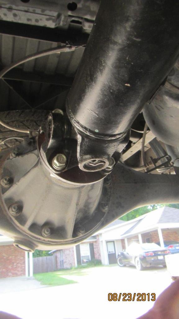

    To start we need to remove the bolts from the rear differential:

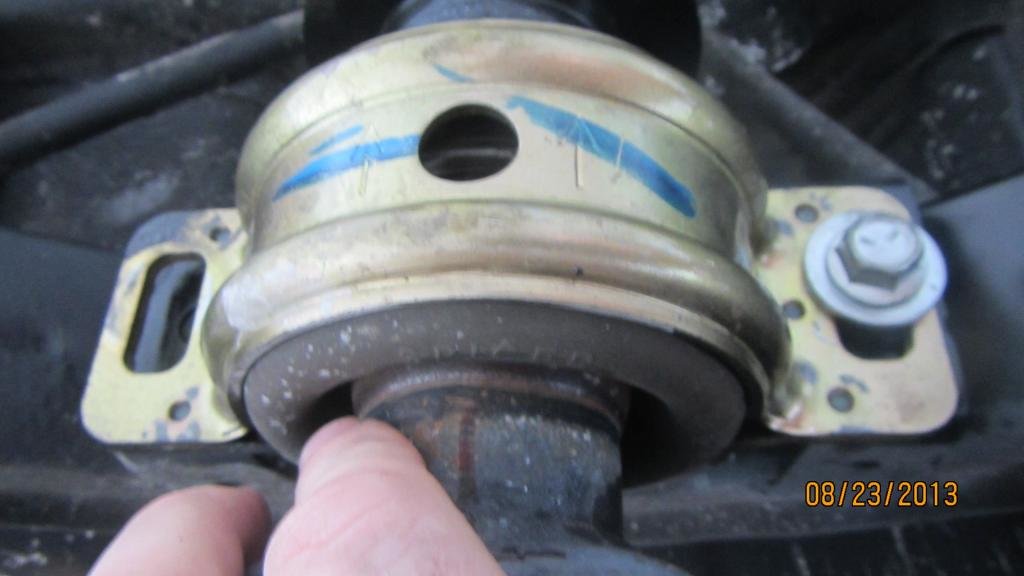

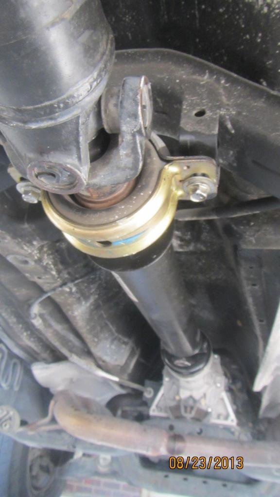

    Then the center carrier bearing support:

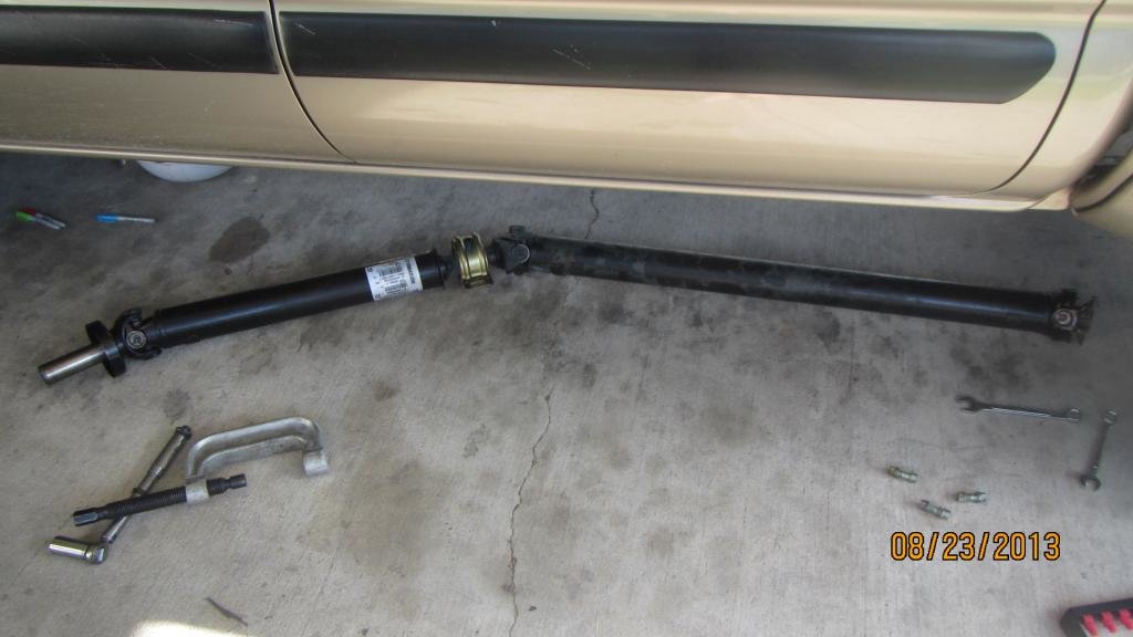

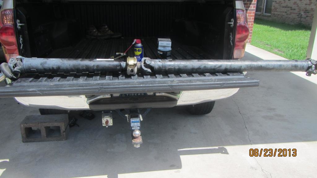

    Then pull the drive shaft out of the transmission and set it on the side:

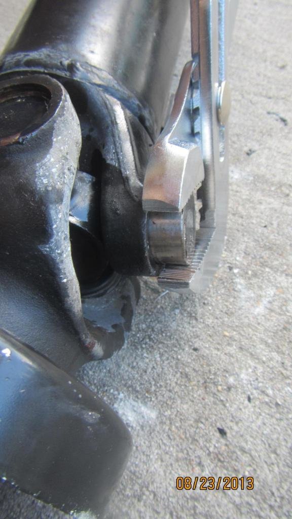

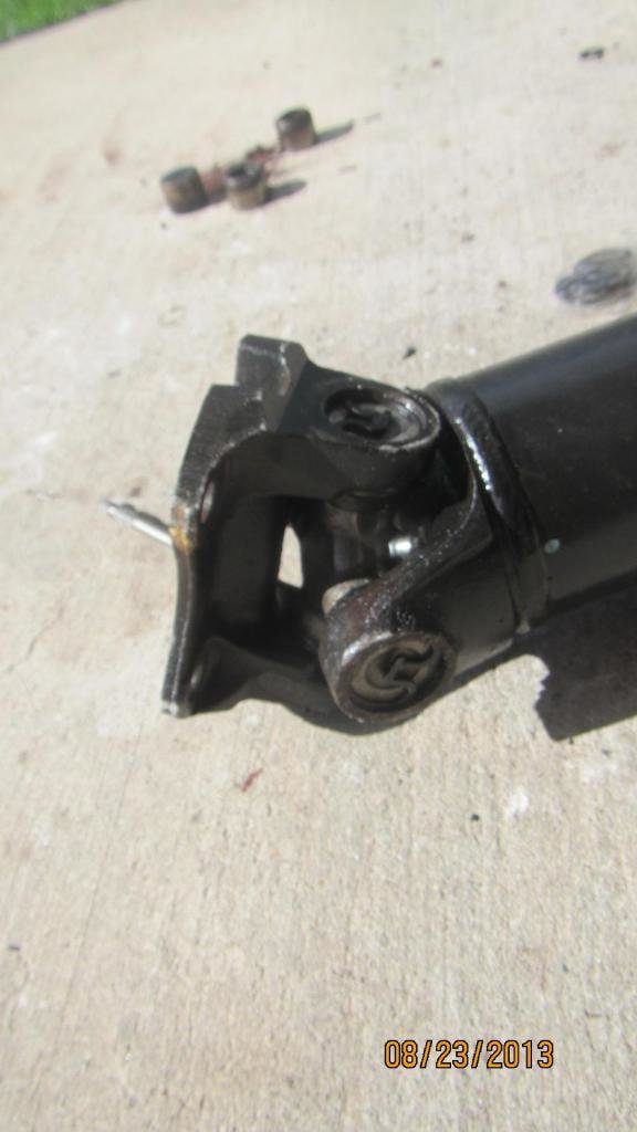

    Next we need to remove the snap rings with some needle nose pliers, I flat head screwdriver comes in handy here so you can slip it under the snap ring to help wedge it out:

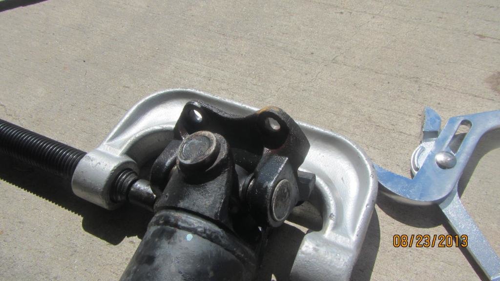

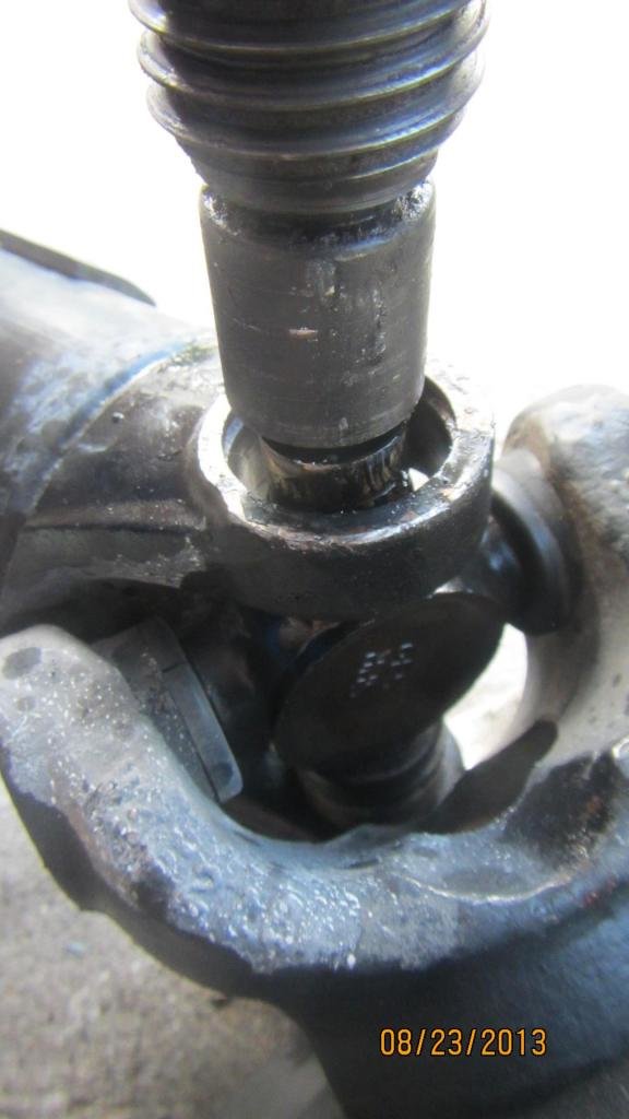

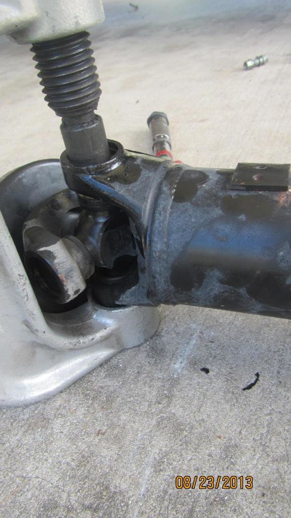

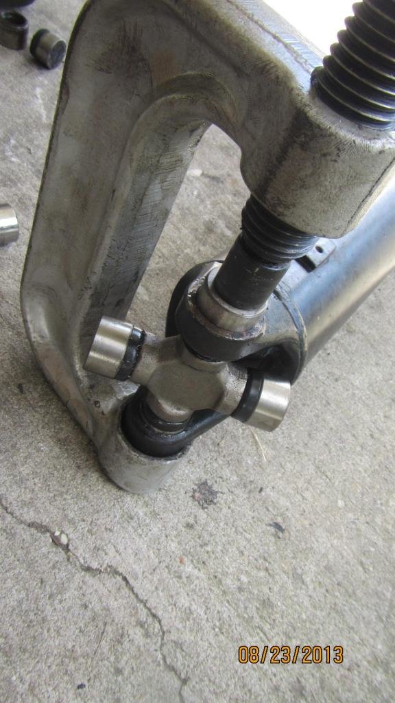

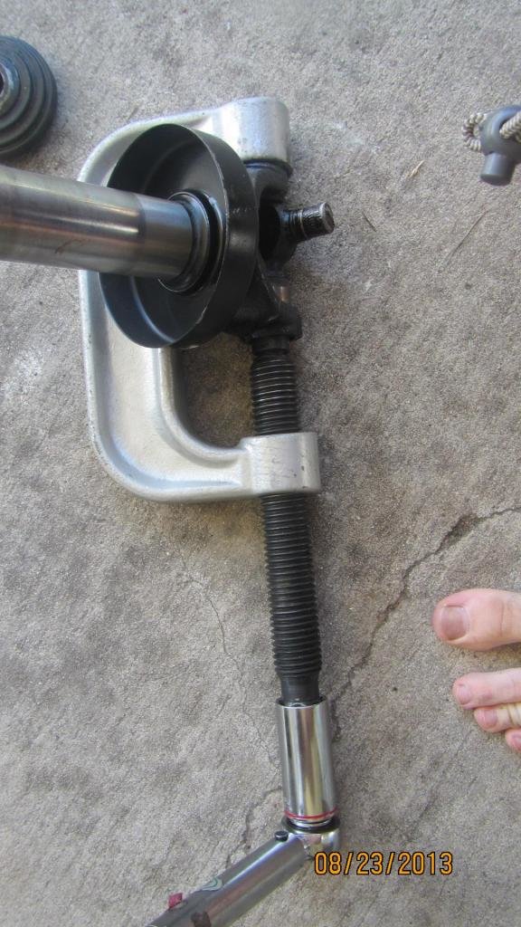

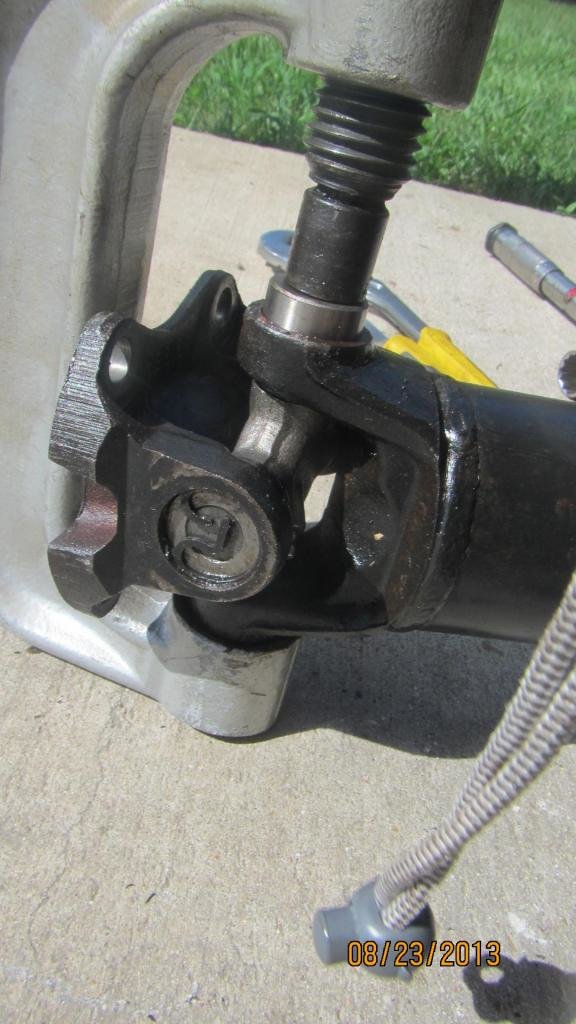

    Now using your U-joint press, we need to press out the old U-joints:

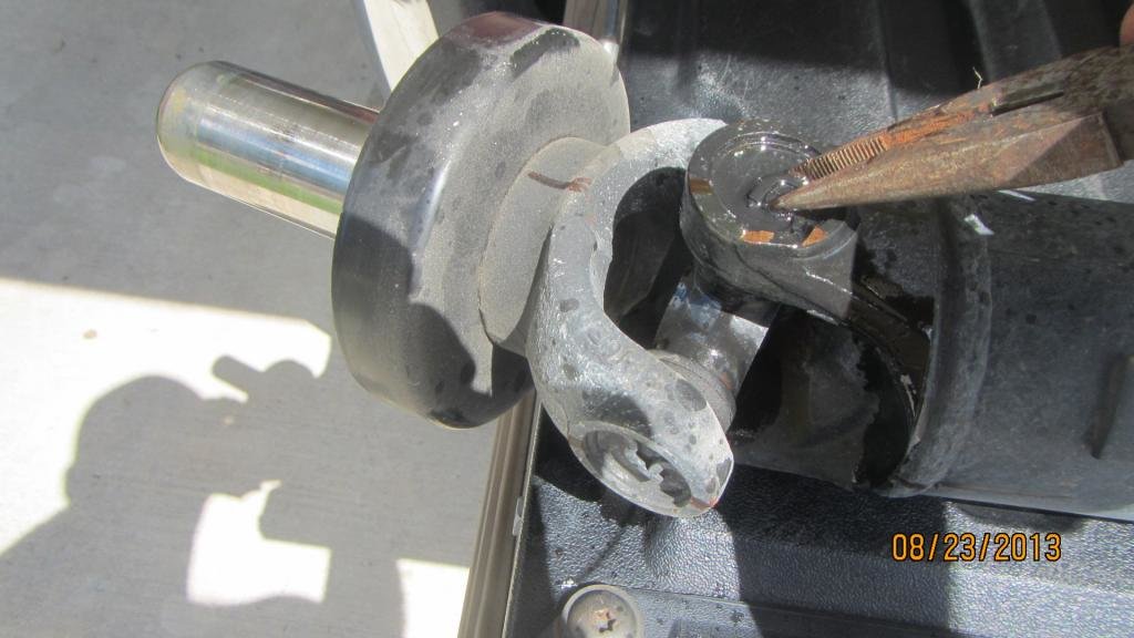

    Once you punch the opposite cap out far enough, its easier to remove the cap with a pair of pliers, just twist and pull outwards:
    Then press in reverse now to punch the opposite cap out:
    I started with the front U-Joint, so now I will remove the other two caps:

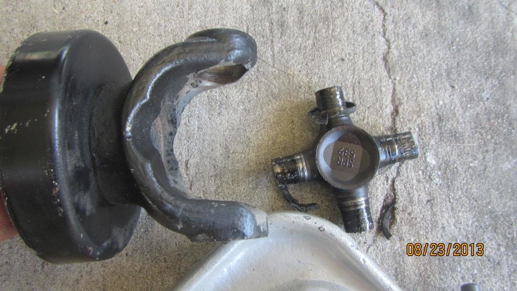

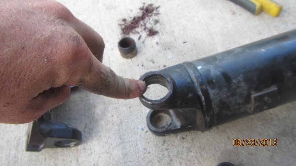

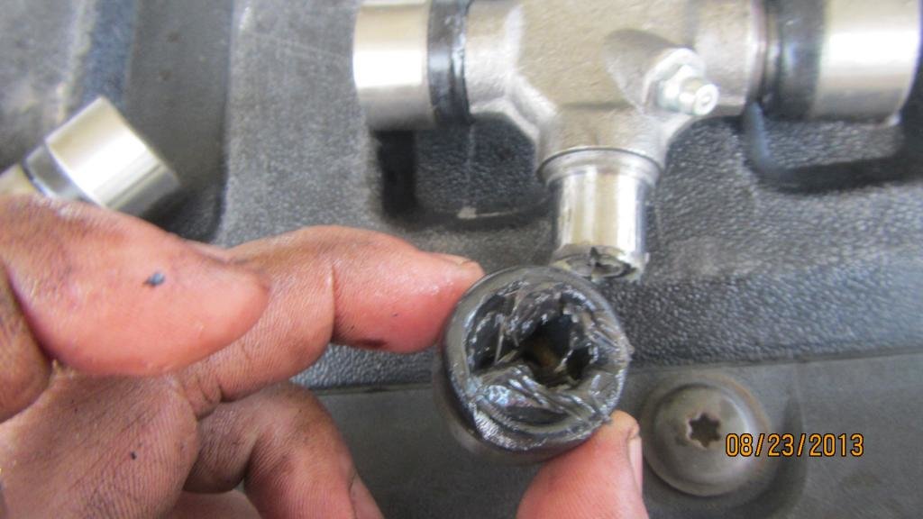

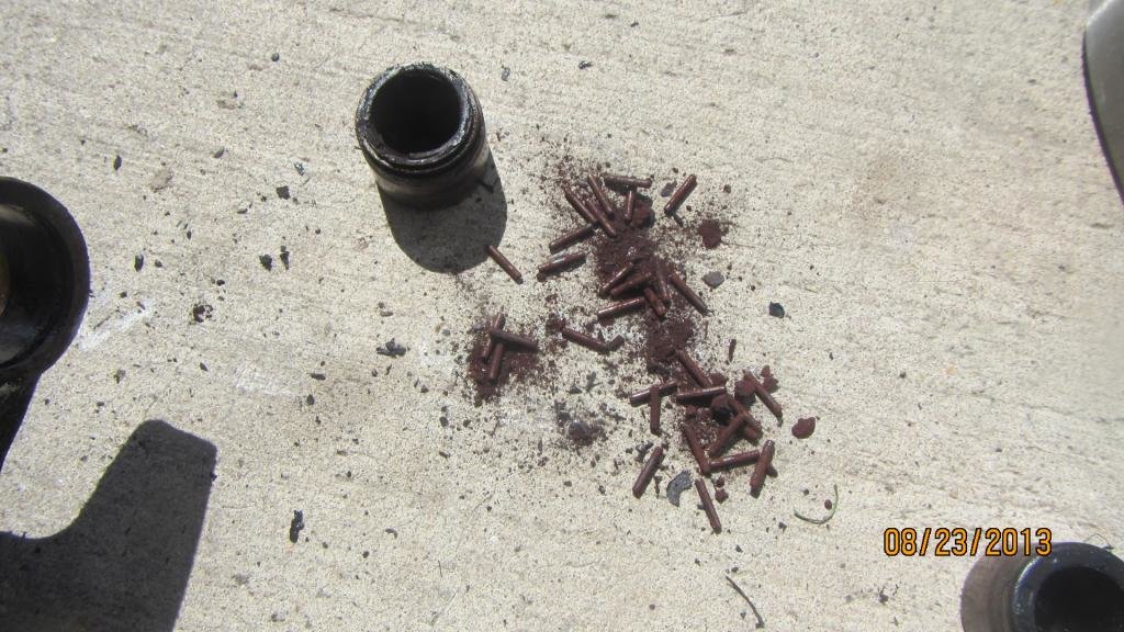

    AH-HA here is the culprit to the squeaking, rusted out needle bearings:

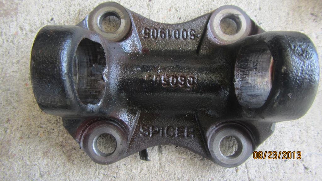

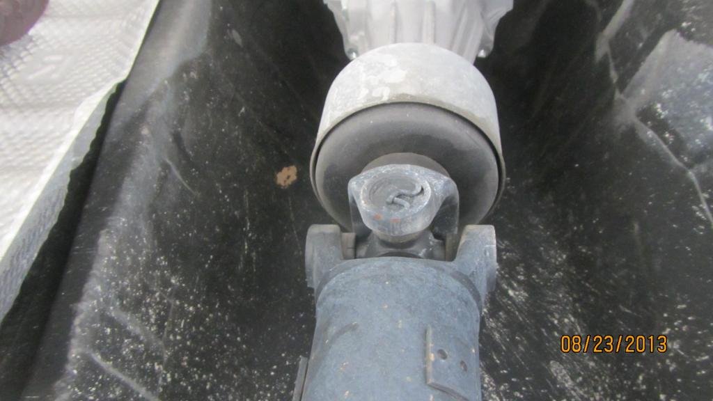

    This is when I noticed after removing the rear bracket that this drivetrain is not stock, Spicer:

    Now before reinserting the new U-Joints clean out your snap ring grooves and knock out any spurs of metal that could impede inserting the caps:

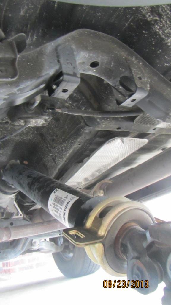

    And here we go back under the truck:

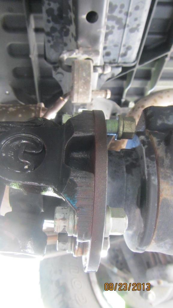

    To put the driveshaft back in we want to start by making sure to insert the front back into the transmission first:
    Go ahead and leave the screws for the carrier loose so we have some wiggle room for bolting up to the rear diff:
    Then once you have everything bolted together, you can tighten it all up and go out and make sure your good to go.

    I'm pretty sure toyota used spicer components in the factory driveshaft. I noticed the spicer stamp on mine too in more than one place. Good write up by the way. I used a small triangle file to make a small mark on the flanges so I could line them back up.

    subd for most likely this weekend. Nice write up. Now just got to find somewhere to rent the tool. Don't really want to pay $115 right now for it.

    Also, stock is Spicer. When I replaced mine, I used Spicer parts, they're pricey but the Moog ones I bought first were shit and didn't fit very well at all. I fought them the whole way.

    Just head to oreilly and get one for a deposit. Or really any of the auto stores.
