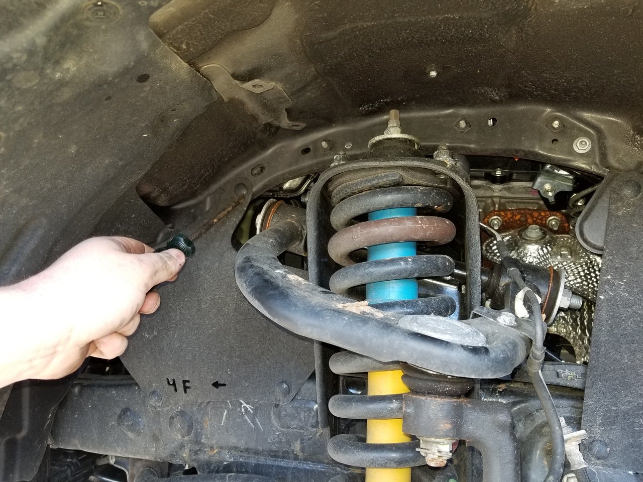

    On the Gen 3, it looks like you have to bend the inner fender to take out the UCA bolt. Is that correct or is there a trick?

    I cut both bolts and replaced them with new. If i remember correctly one faces front and the other faces rear. We put them back in on both sides from the rear.

    You are correct, you have to bend it a bit to get it to fit. The passenger side was worse for me had to cut a bit to get it through.

    The both should be facing the rear (nut toward the rear), really should put them back in they way they came out. If......one were to come loose the bolt wouldn't fall out

    I also just cut mine out, because I wanted to avoid bending the metal, weakening it. Put it in backwards and torqued down with loctite and you'll be good to go.

    One was facing forward and one was rear from the factory. Put them both in the way that they went in without cutting the truck.

    At the factory these get installed before the body is lowered so bending is the only correct way. Cutting a perfectly good and expensive to replace bolt is not only stupid it's also total hack because then when re-installing you have to put them on the wrong way to avoid bending again. If the nut comes loose on the hwy then the bolt will fall out and the results could be catastrophic

    Bending the sheet metal is cake and it doesn't weaken the truck. Get some big ass 16"+ channel lock pliers at harbor freight. 5-minute job to move it outta the way. Also, for safety's sake, bolt should be installed in the correct factory orientation.

    It's the same on gen 2. As @Crom said big channel locks are the ticket. Just make sure you removed the wire harnesses behind our of harms way

    Had to bend mine to remove the bolts (2nd Gen), bent it back when finished, it gets covered up by that 4F flap. Oddly enough, I had more trouble with the driver's side, ended up removing battery and a hose/bracket that was mounted to the side of tray, made it much easier.

    Ok. Thanks for all the input. We'll bend since we didn't get extra bolts. Stay tuned!
