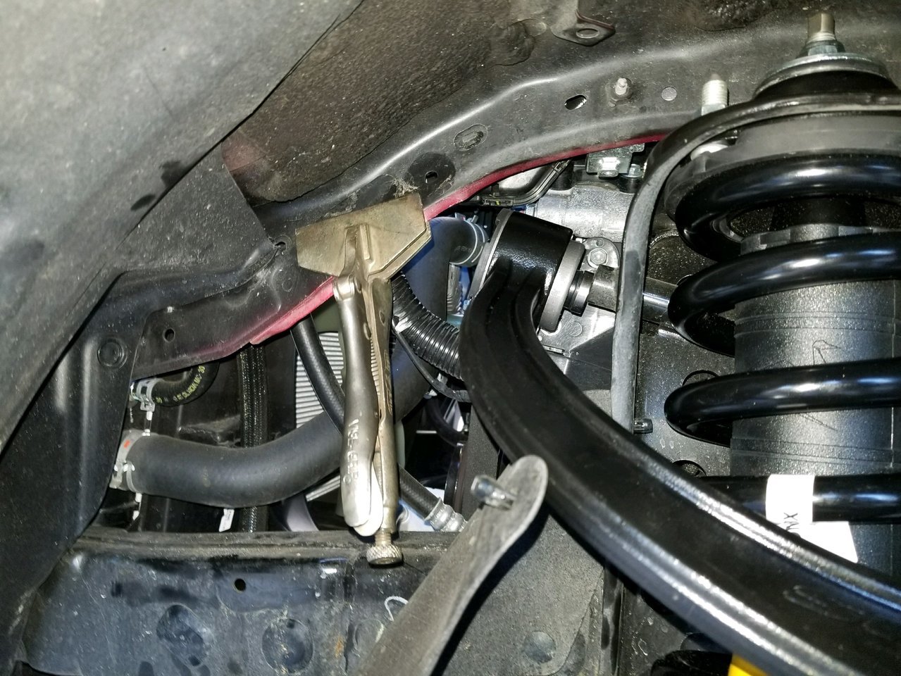

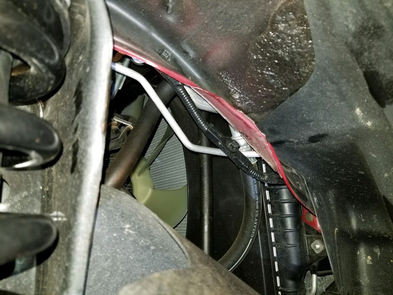

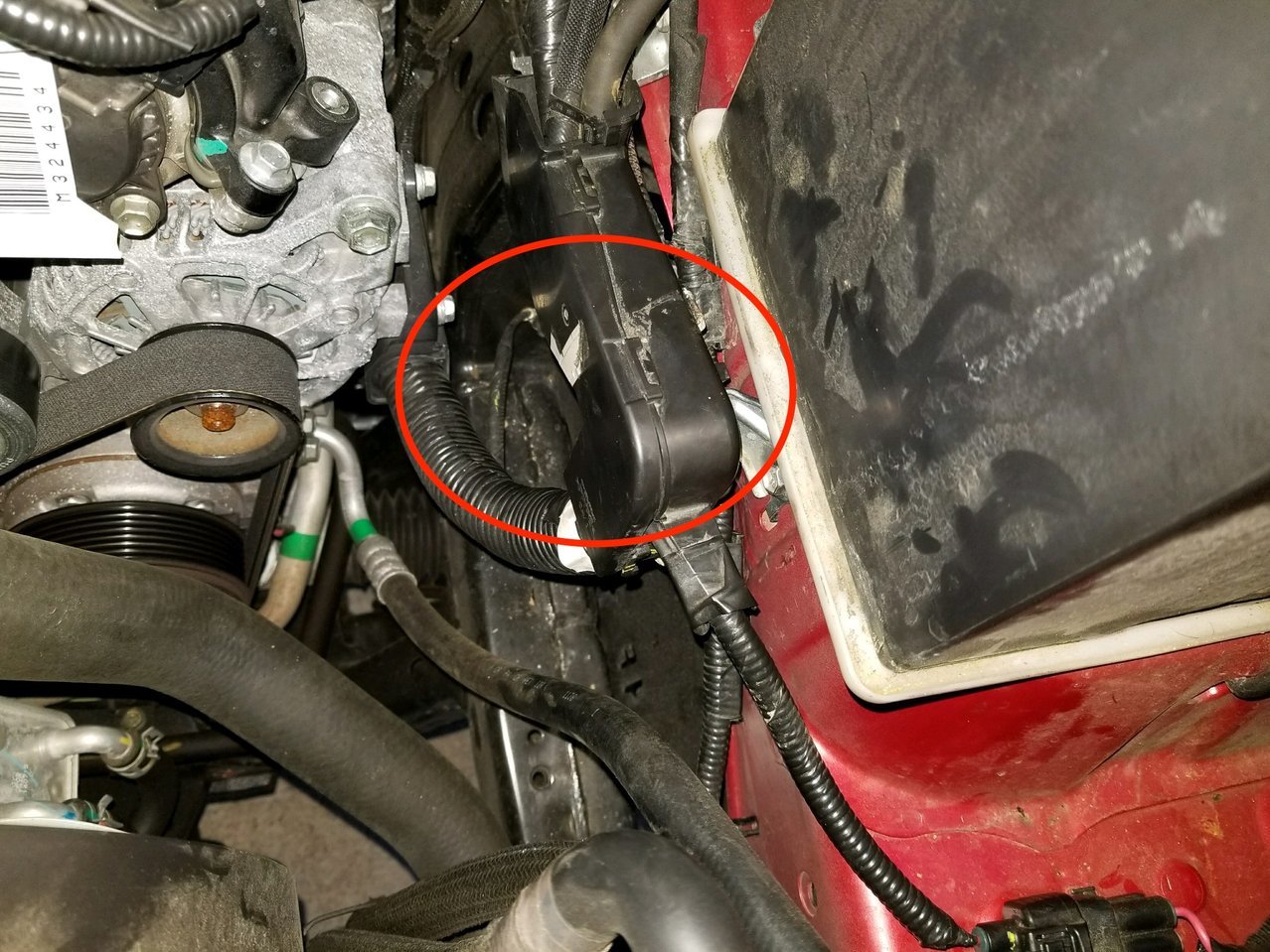

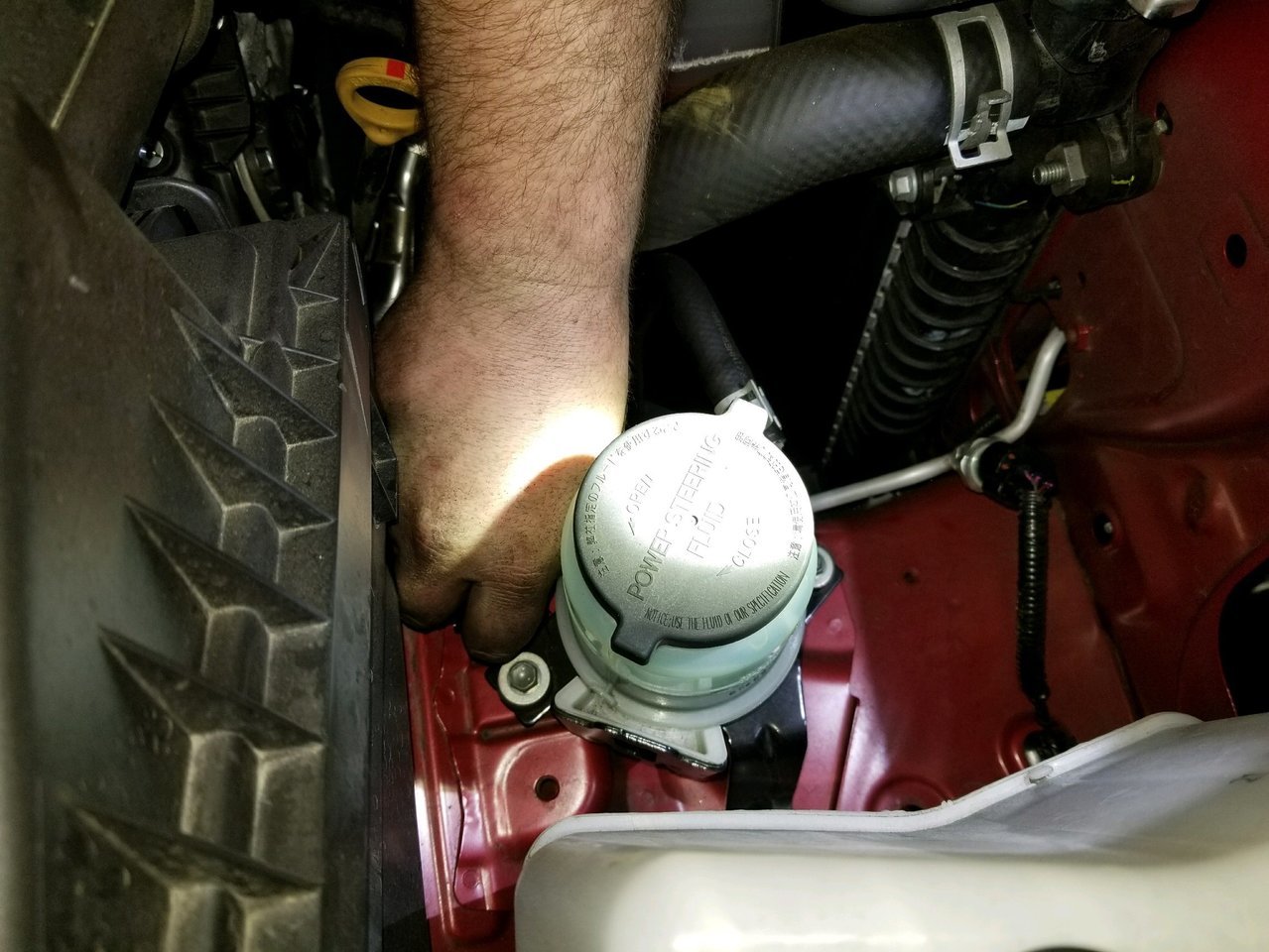

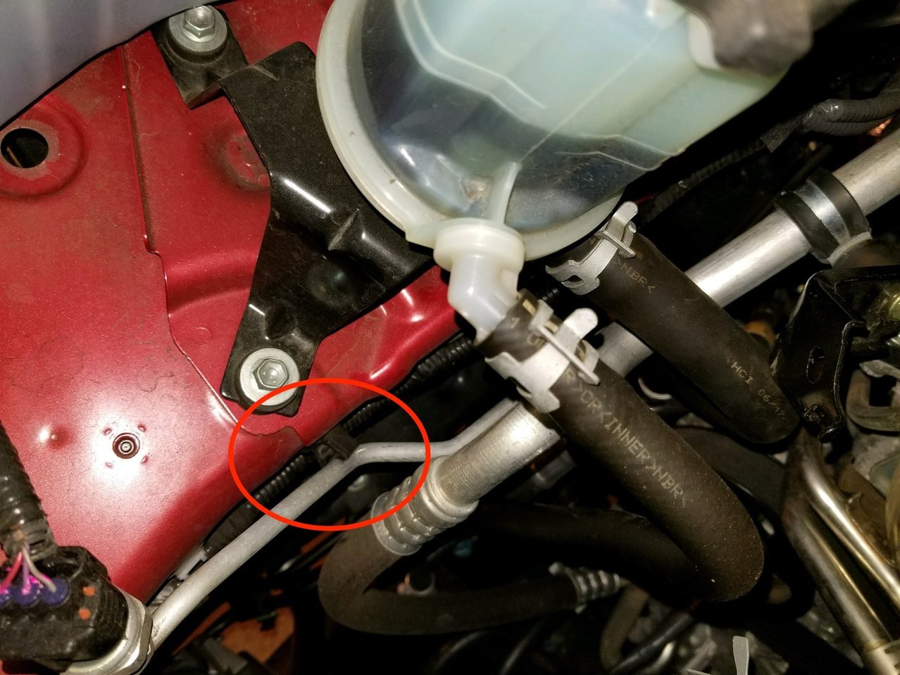

    UPDATE:
    Alright folks...we had a long day yesterday but I think we accomplished everything we wanted. Today I'll get an alignment.
    So below this is how we dealt with the UCA bolt issue I originally asked about. It did not involve cutting the sheet metal, removing the battery or cutting off the bolts.
    For the driver's side inner fender we grabbed a pair of flat jaw lock grip pliers and simply had one person flex the inner fender metal while the other routed the bolt up and out. No cutting the metal or cutting the bolt. We did not have to remove the battery but did move the cable harness next to it (highlighted) out of the way. Easy.
    Now, the passenger was more of a pain. Flexing the metal did not work, we actually had to bend it as far us as we could get it and getting leverage was a problem. Even after bending it as far as we could, the flange on the bolt head would not let it come up. Its flange would hit the curved part of the sheet metal, an area we just could not bend. So we ended up getting a chisel and hitting it steadily from the bottom until it came up and out. There is a cable cover (highlighted) we had to move out of the way.

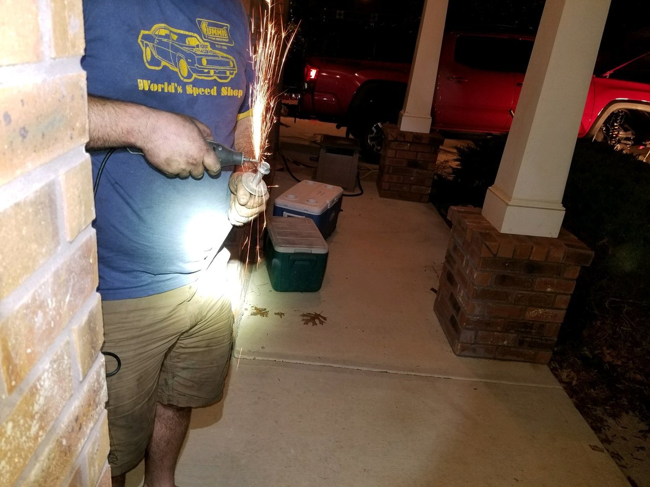

    Now to get it the bolt back in we knew the flange was going to be a problem so we ended up dremeling off just one section of the flange bolt and bingo! That allowed it to be re-inserted with no fuss. I then bent the sheet metal back and plan of spray painting it to prevent rust, but honestly there was not much marring due to the use of the flat jaw lock grip pliers. I highly recommend using them.

    I'm surprised you didn't want to show me running the dremel without eye protection...
    Glad we got it together and setup properly. I'm still a little sore 3 days later.

    HF Pipe lock piers and like 4 or 5 pulls and you bend the sheet metal. Won't come through by hand but if you use lock pliers and a buddy with a little hammer on the back side it comes out easily. Piece of mind for the correct installation.

    I wanted to save you from the harassment, TW can be a cruel place. :anonymous:

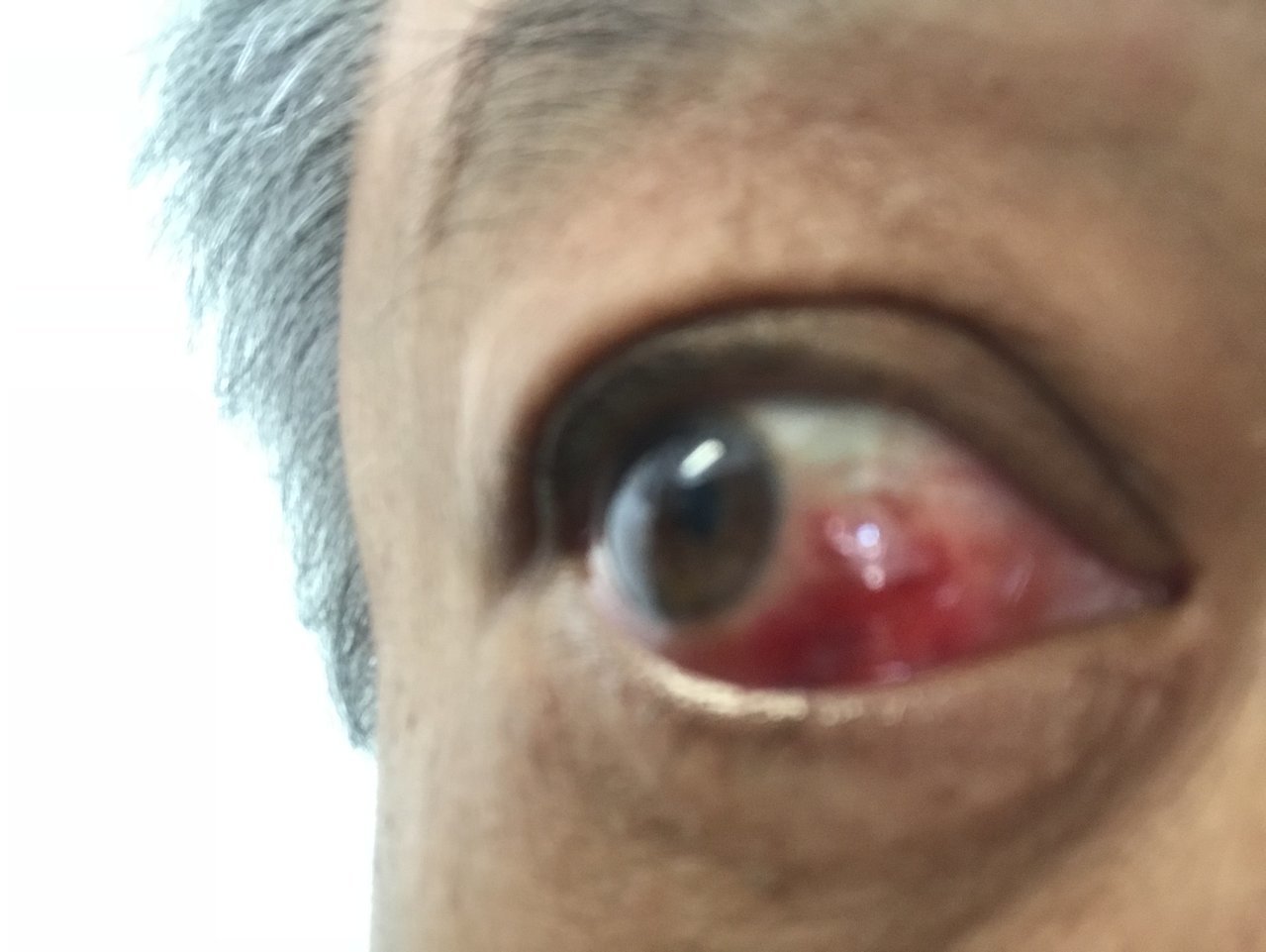

    I’m a huge proponent of eye protection. This is @Subway4X4 :bananadead:
  18. Feb 26, 2018 at 9:36 AM
    #38
    Subway4X4
    Subway4X4 Shameless Copy Cat
    Nov 10, 2015
    #169260
    11,653
    Lloyd
    NY/NJ
    05 Speedway Blue DCSB OR TRD
    Everything TW members recommend
    @DoubleRGirl ’s favorite pic of me.
    Took a hard hit with the pointy end of needle nosed pliers.
    Tore the outer covering of my lower eye.
    Opthalmologist has to super glue the edges together to heal correctly.
    EatSleepTacos[QUOTED] likes this.
