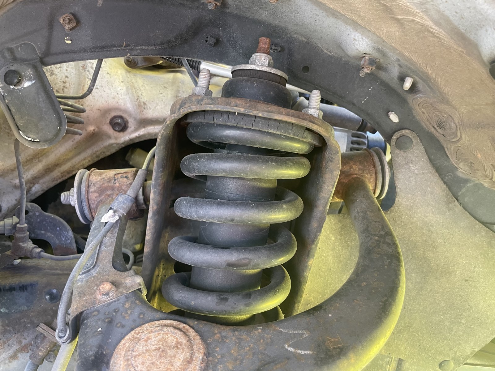

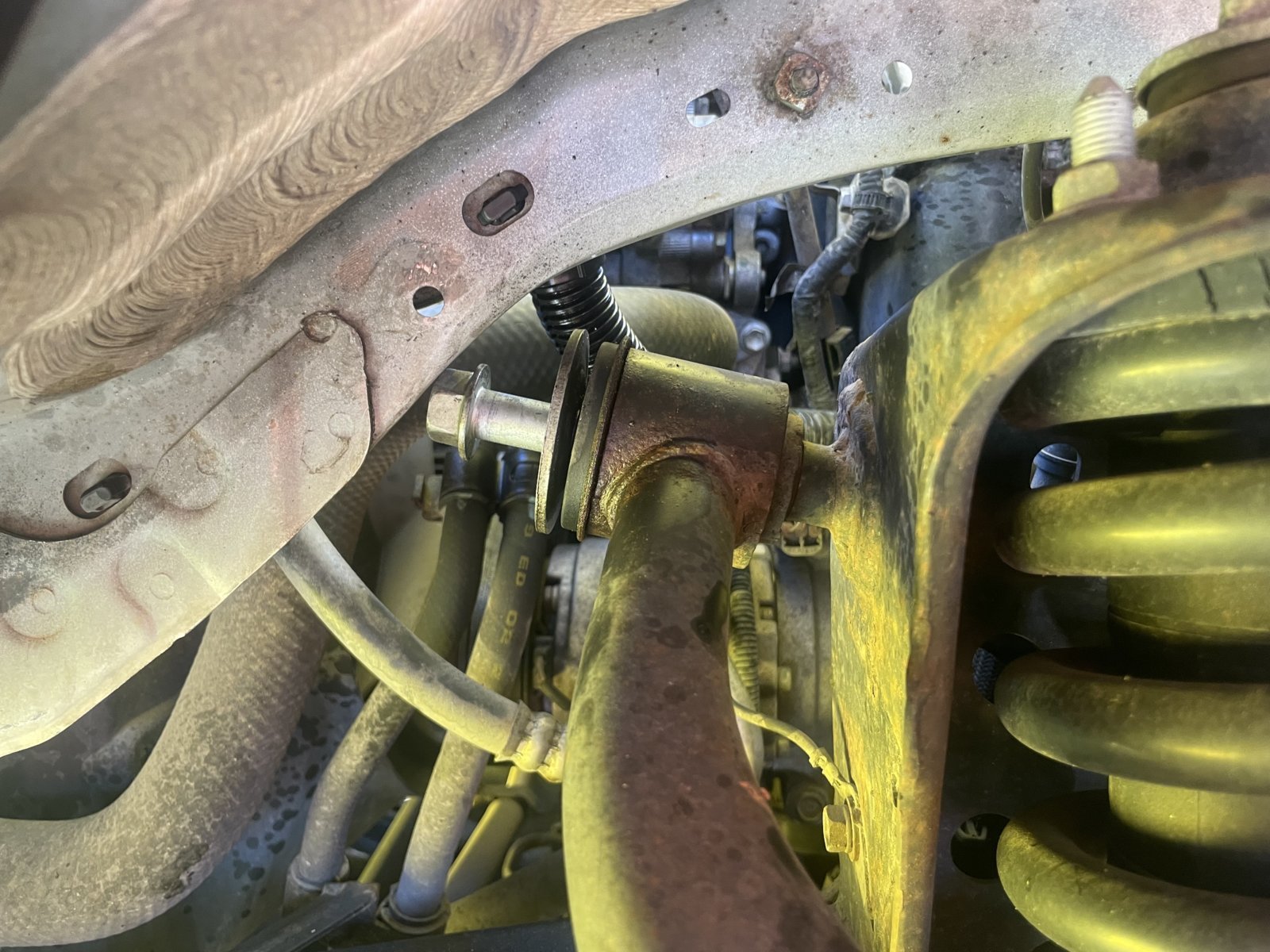

    Bolts won’t come out without lifting the cab or cutting some metal off?
  5. Oct 17, 2023 at 1:08 PM
    toku58
    toku58 Well-Known Member
    Oct 10, 2008
    #9882
    2,534
    On a Rock in the middle of the Pacific
    Mall Crawler!
    21' TRD OffRoad 2" 887 OME on Bilstein 5100's. 285/70R17 General Grabbers G3 17x8.5" Icon TRD wheels (Gun metal gray) 4.75" BS
    Options:
    -Bend the inner fender sheet metal to remove that bolt. (Most places do this method)
    -Un-bolt the Cab and shift it out of the way. (6 Bolts hold the cab to the frame) You can do one side at a time and you don't need to completely remove the cab bolts. (Just wiggle it) Be careful of the rear part of the cab hitting the front of the bed!
    -Cut off the old bolts and re-install new bolts from the rear. (Not the best option)

    You should be able to pry back that portion of the cab and get the bolt to move past it. I was able to free up my bolts by just using a hammer to yank on the sheet metal of the cab.
