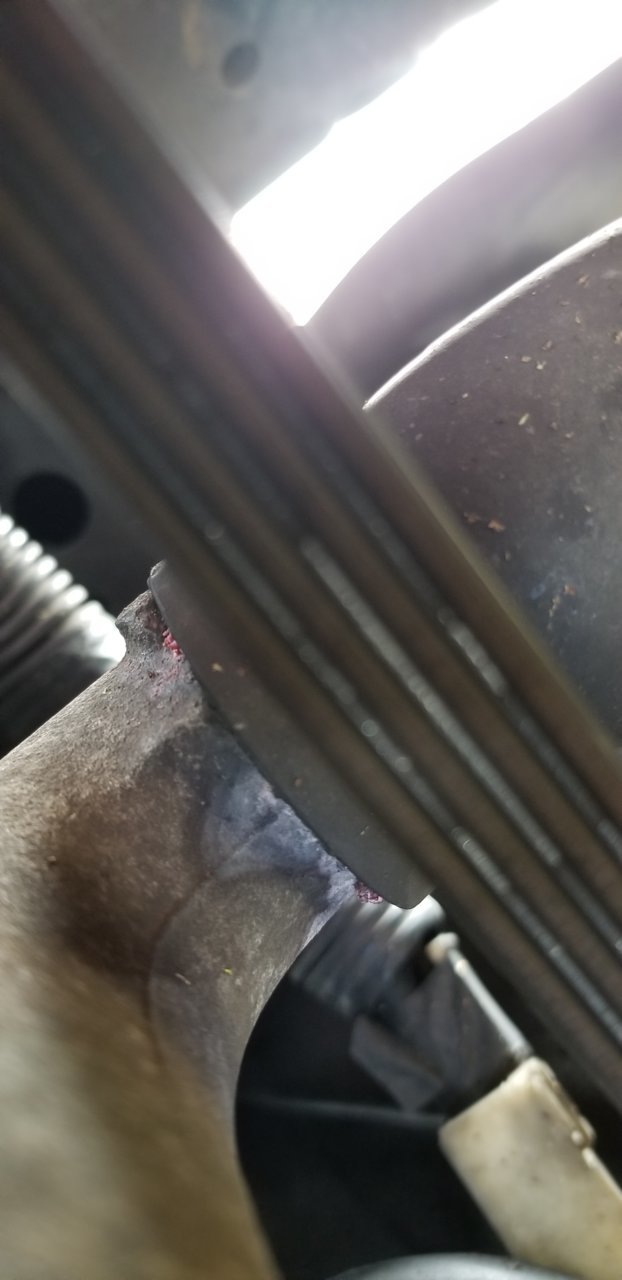

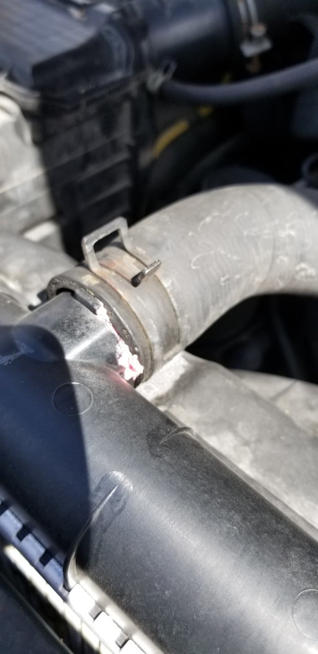

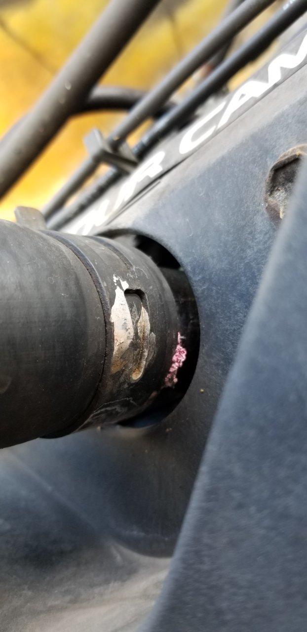

    I've had this truck for sometime now and these leaks are new to me. Monthly (roughly) I do a complete walk around and check the basic things. Recently, I had the Radiator replaced a few months back, due to a leak. At that time they just replaced the radiator only and purged the system (I could be wrong on the purge, part). I assume new radiator and old hoses do not mix well.
    I have attached a few pictures of what is happening.
    I feel It is a easy fix and the most difficult part is the upper inlet if that needs to be replaced.
    Thank you again TW for the word of wisdom.

    New radiator hoses will fix that & you can just reuse the stock clamps.

    I would just thump off the dried coolant and then keep an eye on it. It is highly unusual for the radiator to spring a leak where the hose fittings enter. If the dried coolant reappears, then replace the hose using the same spring clamp.
    On my 1998, I see dried coolant at the edges of the hoses from time to time. I just knock it off and don't worry about it. If you are really worried about it, then by all means replace the hoses. Be sure the radiator fittings are nice and clean before fitting the new hoses on them.

    I replaced both upper and lower hoses with OE Toyota. Those spring clamps are good but don't last forever. I have the same leakage as the pics above (lower only). Going to replace the clamps next - should've replaced them when I did the coolant flush, oh well. OP, might want to look into one of these - they make the whole process much easier. If your first coolant change, reference below video.

    Agreed, OE spring clamps last a while but not forever. Aftermarket spring clamps are junk & worm screw clamps work better but I'm not a fan of them. I try to avoid them whenever possible on my own vehicles.
    My upper radiator hose was weeping for a while cause the hose was worn & stretched. Lower was stretched too but didn't weep. Earlier this year I replaced the radiator due to a cracked cap but didn't replace the hoses yet. I replaced both upper & lower when I did the timing belt, water pump, etc.
    The weepage completely went away after replacing the hoses, I also used OEM hoses & they were a very tight fit which I like. When we worked on customer cars that didn't mind aftermarket hoses, some aftermarket hoses didn't have a nice snug fit like OEM. In those cases we would automatically use worm screw clamps to prevent risk of weeping.
    I've never had to replace any OE spring clamps yet from fatigue but then again I've never owned a vehicle this long before. I replaced the hoses at 215K mi. It'll be a long time before I'll need to replace again but I'll probably replace the spring clamps next time.
