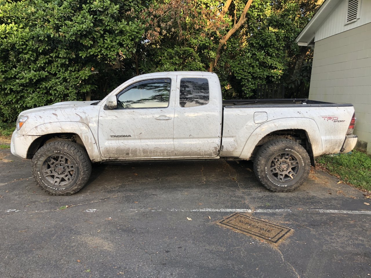

    I have an ebay copy of these wheels (same size and offset) on a 2nd gen and I can tell you about my experience. However I had these wheels with Bilstien 5100's which raised the front 1.75"; rear stayed the same. I ran a 275/70/17 and removed the front mud flaps and there was no significant rubbing on the control arms. After going hard off road I did need to trim the inside of the front fender flare but it's not visible outside. Rears have never had an issue.
    From what I can tell our gens have suspensions with mostly the same components and geometry. I've heard that Toyota has 3rd gens setup with 1" lift in the front compared to factory height of 2nd. But take this with a grain of salt.
