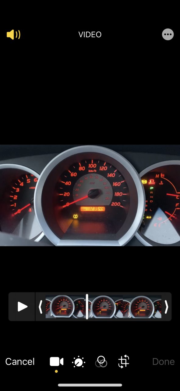

    So I received the used ECU (which was verified to be working), installed it in the truck today, completed the Immobilizer reset procedure as written but still no success. Same lights show up on dash, cranks well but no spark. Really don’t want to tow to the dealer!!! Any last suggestions? If computer is getting power then that means the ground to it should be good right? Someone mentioned checking grounds but I don’t know where to start on that one. I am sure that we’ve already checked ground to computer but maybe there is another one that should be checked.
    Attached a photo of the lights that come on when cranking. 4wd (green light) and 4LO flashes, ABS and e brake light, tire pressure monitor.

    Did you check the IGF circuit like I said?

    I would seing as you have P035x codes, at least check the key on voltage. The IGF circuit should have 5v on it key on engine off with everything plugged in.

    If it's good (5v on the circuit key on) I would want to double check power and ground at the coils with a headlight bulb to ensure the circuit can carry a load (I'm assuming you checked it with a meter?).
    If it's not good (not 5v key on) start unplugging coils one at a time until it returns to 5v, if it still doesn't then find the J12 connector (see my thread), unplug that, and test for 5v on Pin 4. If you have 5v on Pin 4 with it unplugged you need to test Pins 5, 9, 10, 11, 12, & 13 for a short to ground and repair it.
    How did you test the IGT circuits?
