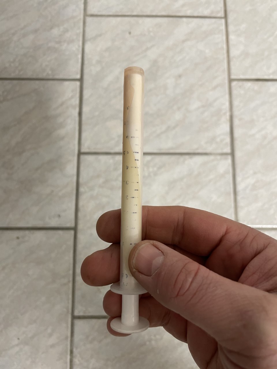

    Topped my Power Steering Fluid today and accidentally over-filled by about 8mm. Still plenty of gap between the level and the cap, but curious if I should try to syringe a bit out or not bother?

    Isn’t there a high low hot cold line on the tank? If its too over filled it will spit the extra out. Rinse it off the paint.

    thanks - there is the line and i just misjudged the speed at which it would come out of the bottle. It's no drama but curious - I'll leave it and check after a couple of drives.

    When overfilled I use 2 rags. 1 I dunk in the reservoir to soak up some of the fluid. Then pull it out and use the 2nd rag under it so I don’t dribble fluid all over.

    Figured out a very sweet solution - my kids' medicine syringe (standard thing over here in Europe) fitted perfectly and I was able to accurately take out a few ml's at a time. Thought I'd share as it worked perfectly!
