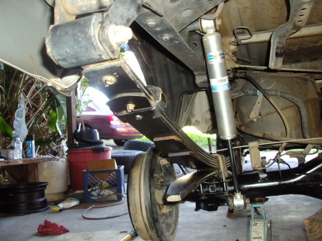

    I'm getting ready to do these 2nd gen springs for a member.....
    Check out the top 2 over loads off my stock springs, that slab of steel dwarfs the 2nd gen's

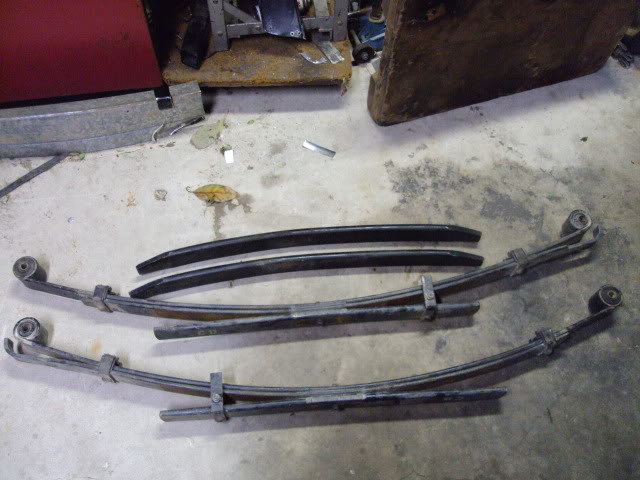

    Yes they will...;)
    Pic of my crapyard springs, how could I do this to my truck? look at them suck thru this little flex, I'm ashamed

    How can these work ? there isn;t 1 name brand tag on them, fail:(:(

    Because there is two (Ford and Toyota).:D
