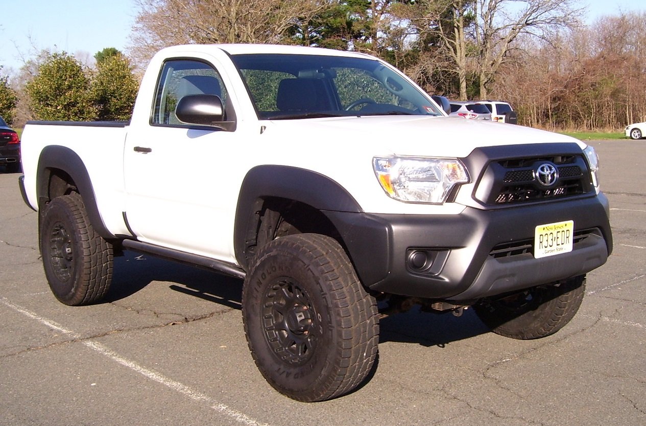

    With an aftermarket wheel, you want to look at a 16 x 8 with 4.5" (0 offset) backspacing will give you the best chance of not rubbing. That's what my truck had and no CMC, but I have the SPC UCA's which allowed me to move the wheel forward more. You still probably need to beat the pinchweld and trim the flares. You could probably get away with 4.25" with -6 offset on the same size wheel but that would put it a little closer to the cmc. Here's my truck with the 16 x 8 4.5" bs 0 offset with 285/75/16 and I had no rubbing.
