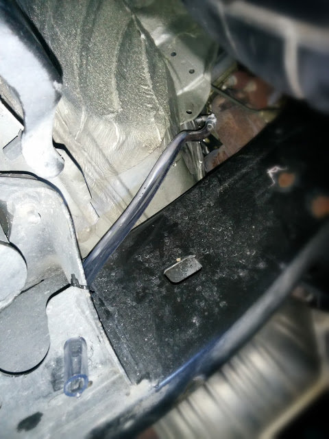

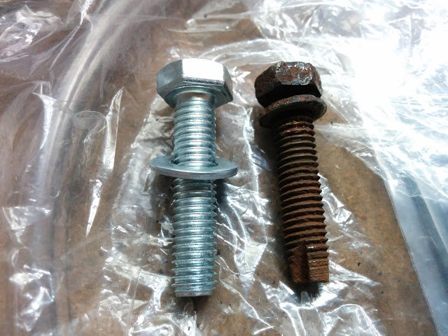

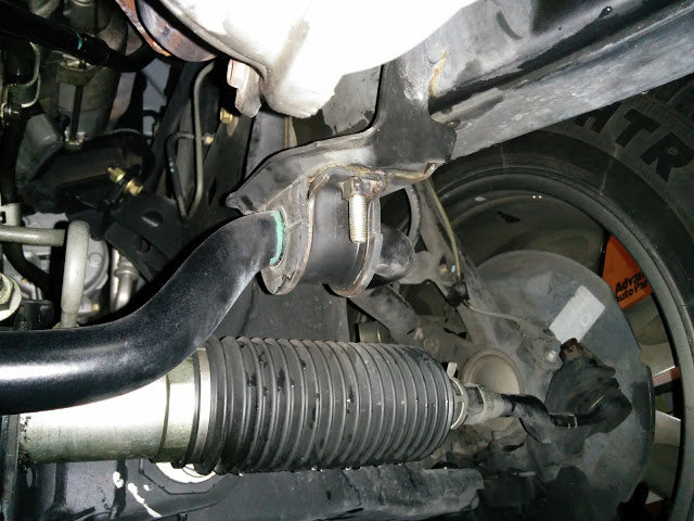

    While poking around under my truck I saw that one of my sway bar bushing bolts was quite rusty while the other one was just fine. I found that AC drain tube was dripping right onto the frame and the water was finding its way down to the screw, overtime causing the rust.
    I went to my local ACE Hardware (LOVE that place) and found a replacement bolt (head was 13mm instead of 12mm, but it still worked), M8x1.25x35mm with a 8mm washer.
    Next I got some 3/8in ID (inside diameter) tubing, about 3 feet of it, and slid it over the drain tube, securing it with two zip ties. I then routed it down the frame where it could drip onto the ground. I just have to check on the hose to make sure it holds up to the engine bay temps (it sits kinda close to one of the exhaust manifolds).
