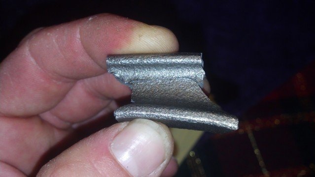

    Connecting rod. Wow. I have seen them bent into "S" shapes, but have never seen one shatter.....then again, I'm not an engine builder.......must be the way they are building them in modern times?

    Won't know until I have it out (should be Monday) and pull the pan. But my guess is #6/driver side rear. That's the cylinder that was completely filled with oil...#4 was only half-filled.

    Engine is out. Good news is there is no hole in the block wall. I'll dive into it for a look-see later this week/end.

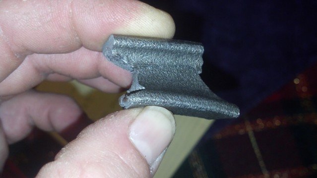

    Well, the diagnosis is in. I shattered rods 4 and 6. Yes- shattered. No clean break anywhere, and at least six pieces of rod in the pan. Both crank ends were jammed into the block wall (no penetration, thankfully), which would explain why it wouldn't budge in either direction.
    I'm going to be diving into it Monday afternoon with my son, so I'll get a better idea if there is further damage elsewhere.
    I'll get pics up some time.
