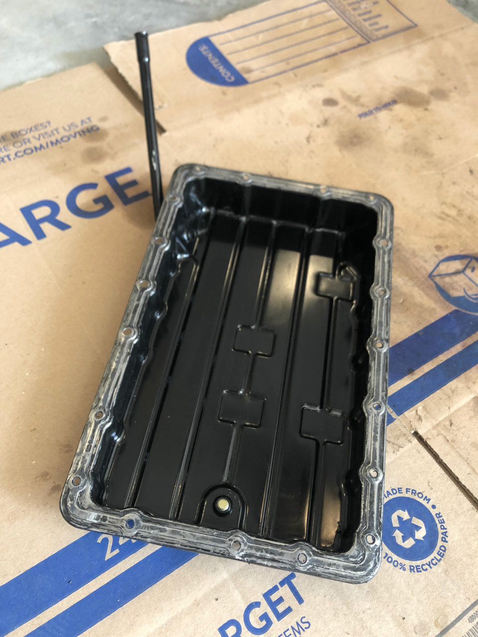

    Hi all,
    My 98' Prerunner 3RZ-FE has recently been running a bit rough at highway speeds only in the morning when the truck is cold. Usually around 70MPH things are getting a bit shaky and jumpy, almost like a cylinder misfire. I heard one thing to check would be my transmission level, and sure enough, when I checked the dipstick it was very low.

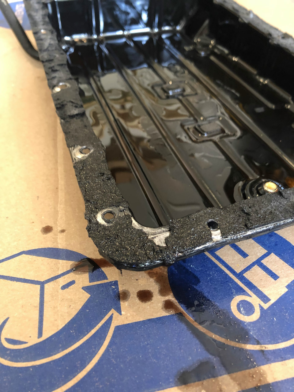

    I solved why it was low by noticing a good bit of ATF around the bolts on the pan and a weep from one of the corners. I drained the ATF, took off the pan and clearly saw some very old and crusty FIPG. Scraped it off, got it clean, and bolted the pan back in.
    Now with the pan back in and after filling the ATF back up, I gave it a test drive and everything seemed smooth until I got home & parked. I noticed a lot of ATF was now leaking from up higher, and assumed I must have over-filled. I drained some ATF out, rechecked the level, looked good and called it a day.
    That was about two weeks ago and I'm still getting a leak from up high unfortunately. My ATF level is now below where it should be from the leak I'm guessing, and I just don't know where to go from here.
    I shot a video of where the leak is coming from here:
    The real kicker is...Truck still shakes around 70-75MPH. Any ideas on what to do next and to get this leak to stop?
