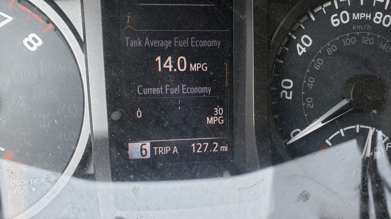

    Understood ref the MPG display. I was focusing more on the transmission learning.
    Someone will probably correct me, but IIRC the tank average display will "start over" when you fuel up.. what that trigger is WRT fuel quantity added etc I have no idea.
    The overall average fuel economy display actually does not change that much once you've traveled a good number of kms unless you reset the whole clown show via the head unit etc.
    The trip average is the display I have up in my cluster, as it resets every drive cycle. It lets me know pretty quick if my fucking with tables has made things worse ;)
    Although, again.. you have to wait for things to settle a bit after a flash to make that judgement.

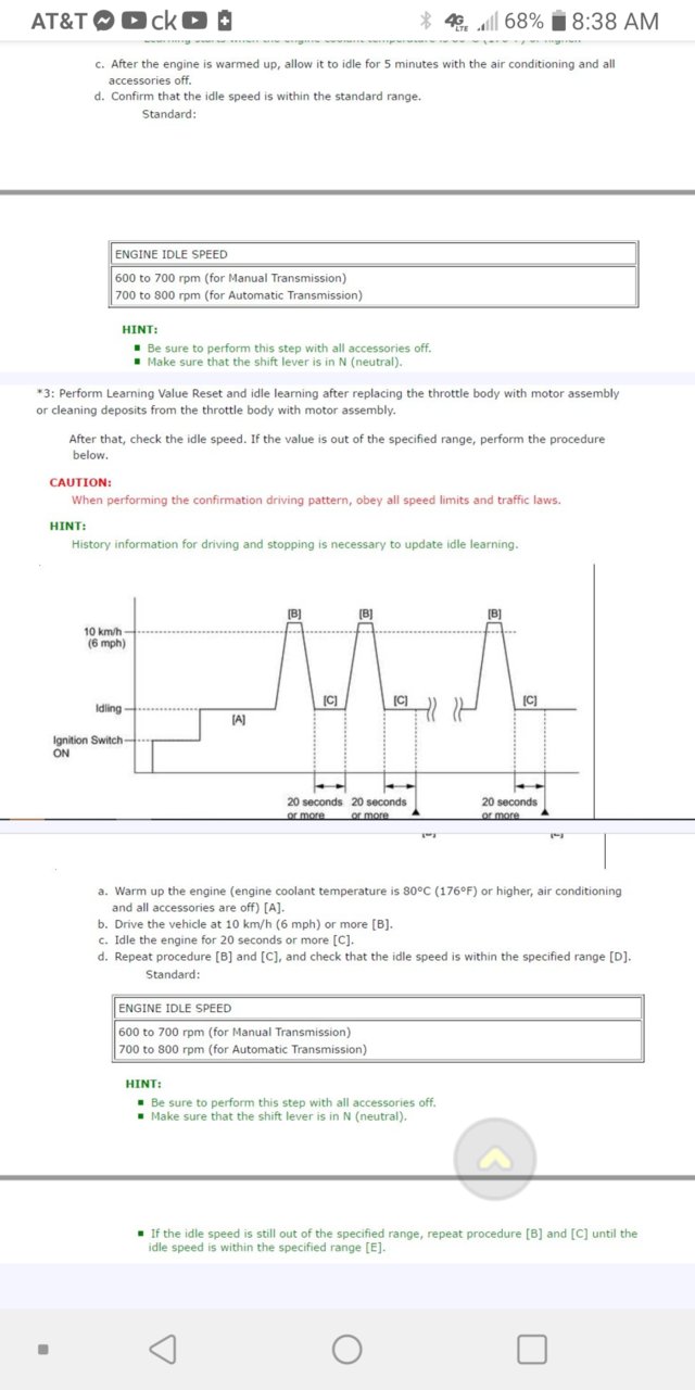

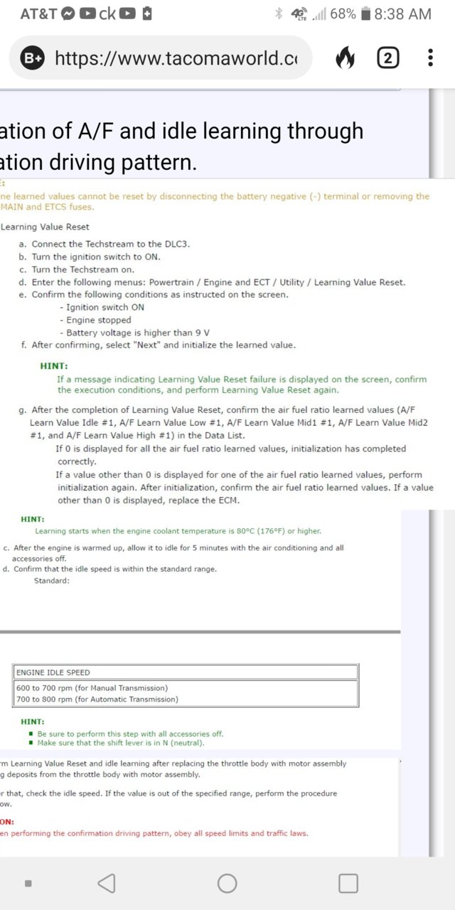

    I saw a post with a page from.the manual showing how to reset the lv etc and it said automatucs should be closer.to 700-800 from.what I understoof

    It won't idle 700-800. This was discussed many times in 1.05 thread.
