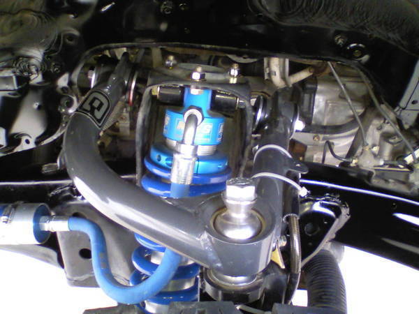

    i dont see a limit strap mounted to the frame either
    not that he has any down travel anyways...

    Agreed. The top part of the shock is definitely taller.
    Mine used to look exaclty like yours...until the resi sheered off.

    Looks like his tire would rub the resi if he turned to sharply over a curb or something... imo,

    My solution:

    oic did u buy a mount or make your own either way im in need of 2 haha

    His solution was that shiny thingy with the tubes on it ;)

    The fitting elbow on the resi was swapped out too a low profile one as well.

    I see what you mean though. My shit is high profile :cool: but I still have plenty of room

    whered you get that upper shock mount camburg?

    looks like ur upper shock mount on the coilover is diffrnt then mine. i love the bypasses hofly ill have mine soon

    Yes sir. I dont have standard 8" shocks though. Mine collapse to 14 3/8" instead of the normal 16"

    my set up is similar but I had to put my resi this way cause the hose was too short. When its time to rebuild i will get a longer hose or a 90 fitting.
    That other bypass resi that was above the tire, how close do you get at full bump?

    took a second look at that pic and I think it is the picture angle that makes it look like its above the tire.
    correct me if im wrong.
